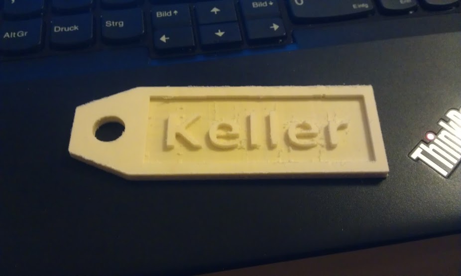

well.. it starts to become a bit boring if it goes to safe position after any line in the area. isn't there any option "don't get safe until area is done" ?
Btw, here is my result.
additionally, i found out that openscam can't operate partial circles correctly.. however.. linuxcnc does.. :hehehe:
kerllerschild.jpg (20268 просмотров) <a class='original' href='./download/file.php?id=35032&mode=view' target=_blank>Загрузить оригинал (41.42 КБ)</a>
narvf
Сообщения: 60
Зарегистрирован: 22 июл 2014, 11:39
Репутация: 4
Re: area doesn't fill correctly
Сообщение narvf »
Looks good! What whaterial is it?
As far as I know ther is no such option, but you can save file without exporting gcode in inkscape, to DXF and try dxf2gcode. I used this only for cutting, not engraving but should work. In dxf2gcode tool will not go up after each path, and then go down.
