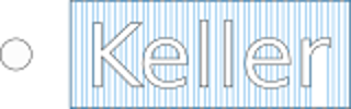

hi,
first to say, i'm using inkscape 0.48 and gcodetools 1.7
I tried to make some small nameplates where the area around the letters is milled away.
I started writing the text and drawing a surrounding box. after, I turned both into paths(CTRL-Shift-C) and combined them (CTRL-K)
After, i choosed gcodetools -> area.
After filling the area, some pieces are filled that must not be and others, who'd have to, aren't.
have a look at the pic i attached and you'll see what i mean.
Is this a software defect or rather human misbehaviour? ;)

I this it will be better if you will add text, convert to path, ungrounp text and combine it (ctrl + k) and then select text and surrounding box and press ctrl + - (path -> difference. i think its called). After this adding "area" should not make problems.

okay.. looks bit better but still some error..

Can you post your svg file?
What option to you use to fill area?

uff.. i think, i changed nothing to the standard settings but area tool overlap to 0.1..

File made by me in attachement.
I had to create new file, in yours something was not working good.

well, this did it. thanks.
but i got another problem now.. it doesn't do multiple passes.. got two bits broken.. only some chinese ones left..
so i need to do anything slooooow or in multiple passes.. but it doesn't pass multiple times.. :(
