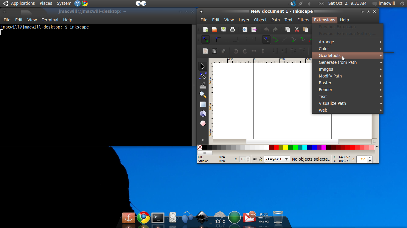

Hi there, I have a fresh install of Ubuntu 10.04 and Inkscape.
I have downloaded the latest version of gcodetools (1.6.03). I followed the directions and it shows up as a section in the extension menu.
Unfortunately - I cannot get any futher - I click on the arrow to get the extensions themselves and there is nothing there - just a single pixel line with nothing populated in it. I must be missing some dependency that is not listed in the forums anywhere. Does anybody have any ideas what may be wrong?
Thanks
Jonathan
Re: Inkscape Gcodetools plug-in English support forum
Hi!
Try starting inkscape from terminal. It could give more info about what is wrong. (post here any error messages, they should appear just before the window shows up, or when you are activating Gcodetools menu)
There should not be any extra dependences. And if the Gcodetools menu shows up, there should be something in it.
Normally you should get something like this:
Inkscape gcodetools screenshot.png (13360 просмотров) <a class='original' href='./download/file.php?id=733&mode=view' target=_blank>Загрузить оригинал (135.69 КБ)</a>

I wish I could actually capture the screen to show you the single line that appears instead of the sub-menu you show on your screen - but the screen capture does not work unless I close the menu. How did you get that screen capture?
As far as running inkscape from the terminal - i get no errors at all, inkscape just runs.
On an aside - I installed it on my netbook and it seems to run just fine - but I have used it as my test platform and it has several other inkscape extensions installed. I cannot understand why it will not run on the desktop with a clean install.
Isnt there a file that is required to tell inkscape what to populate the dropdown menu with? Which file is that and where should it live?
Thanks
There's a hack how to make a screenshot of the menu ;) . Launch Accessories -> Take a screenshot and set up delay. Then go to inkscape open the menu and wait for the delay. Usually 4 seconds is enough.
Each menu item is described in the .inx files. At the end of the file there's section:
    <effect>
		<effects-menu>
			<submenu _name="Gcodetools"/>
		</effects-menu>
		<object-type>path</object-type>
    </effect>
So removing submenu element should put it into the extensions root menu.
By the way there should be a common Gcodetools element which contains all the functions.

Thanks for that
The screenshot is attached, also with the terminal window demonstrating the clear lack of errors.
Just for your own intrest, I included a listing of the files in my extensions directory:

Screenshot-1.png (13354 просмотра) <a class='original' href='./download/file.php?id=734&mode=view' target=_blank>Загрузить оригинал (198.35 КБ)</a>
And what about other extensions? For example "Arrange" or "Color" groups do they open fine?

The rest of the menus work fine
See below
Screenshot-2.png (13349 просмотров) <a class='original' href='./download/file.php?id=735&mode=view' target=_blank>Загрузить оригинал (275.8 КБ)</a>
hmmm that looks strange, can you remove all gcodetools*.inx and copy to extensions ony one inx. May be there's a problem with one of them which interferes others.
What happens if you remove <submeu> tag?
