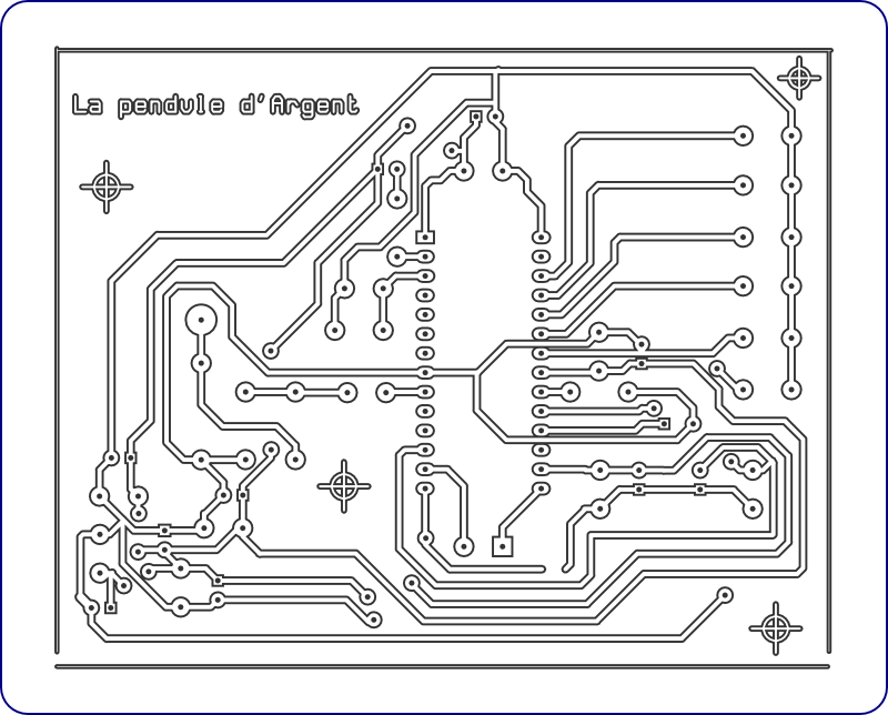

Hello,
I found your extension Gcode Tools.
I have to make PCBs.
The problem is that the machining is done on the runway.
My tracks are "eaten" by the bit instead of milling outside and inside tracks
How please?
I enclose my files.
Good Sunday
Pierre

Re: Inkscape Gcodetools plug-in English support forum
I'm sorry I do not get what you want.
Do you want to cut everything except the drawing (tracks?)?
If yes you can try to convert stroke to path and cut those paths.

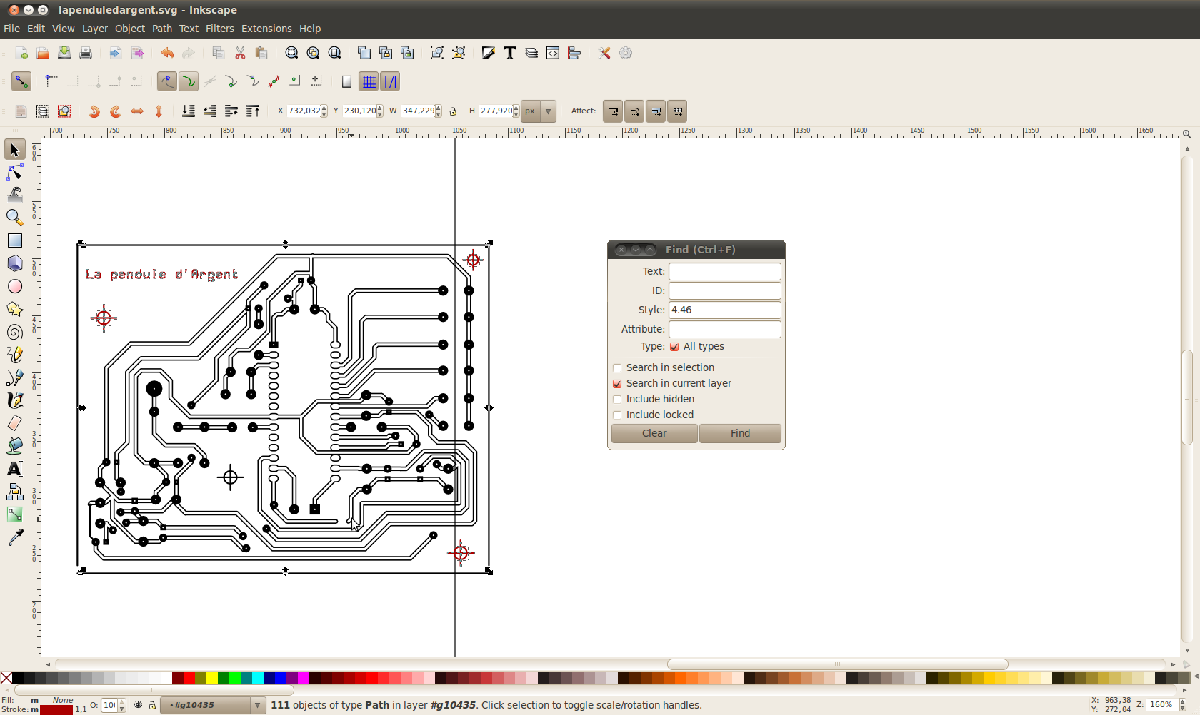

Here's a simple step by step instruction:
First of all I'll explain how to cut the "outline" of the drawing
1. I think it would be better to define different line width from that is on the drawing because the cutter's radius is not 0.
So select all the straight lines having current width. You can do it manually or automatically using "find".
to use find we have to know the stroke width. Select one of the straight lines and press Ctrl+Shift+X and search for the stroke-width in the style.
Screenshot--home-nick-Design-cnc-club.ru-gcodetools-tests-lapenduledargent_result.svg - Inkscape.png (13410 просмотров) <a class='original' href='./download/file.php?id=701&mode=view' target=_blank>Загрузить оригинал (286.11 КБ)</a>
then remember stroke-width and press Ctrl+F to open find dialog and find all similar lines:
Screenshot-Find (Ctrl+F).png (18.53 КБ) 13410 просмотров
Screenshot-lapenduledargent.svg - Inkscape-1.png (13410 просмотров) <a class='original' href='./download/file.php?id=703&mode=view' target=_blank>Загрузить оригинал (217.52 КБ)</a>
Then we need to convert outline to path and we want to make it thicker. I've set stroke width equal to 3. And converted outline to path (Path -> Stroke to path Ctrl+Alt+C). Then add paths together by pressing Ctrl+"+" and set stroke to Grey and fill to none to check if everything is correct.
Screenshot-lapenduledargent.svg - Inkscape-2.png (13410 просмотров) <a class='original' href='./download/file.php?id=704&mode=view' target=_blank>Загрузить оригинал (219.84 КБ)</a>
Then proceed with the small plates. Some of them not actually outline paths but paths with thick stroke.
So doing almost the same as before get stroke-width, find, convert outline to path and add to previous result.
Screenshot-lapenduledargent.svg - Inkscape-2.png (13410 просмотров) <a class='original' href='./download/file.php?id=705&mode=view' target=_blank>Загрузить оригинал (219.84 КБ)</a>
Then convert other paths:
Screenshot-lapenduledargent.svg - Inkscape-3.png (13410 просмотров) <a class='original' href='./download/file.php?id=706&mode=view' target=_blank>Загрузить оригинал (202.87 КБ)</a>
And finally find all the paths that are filled with #000 and add (Ctrl+"+") them to the result:
Screenshot-lapenduledargent.svg - Inkscape-4.png (13410 просмотров) <a class='original' href='./download/file.php?id=707&mode=view' target=_blank>Загрузить оригинал (226.07 КБ)</a>
Finally you should get something like this:
gcadetools PCB cutting Gcode.png (13408 просмотров) <a class='original' href='./download/file.php?id=710&mode=view' target=_blank>Загрузить оригинал (127.97 КБ)</a>
For the first time it toke me 10-15 minutes to prepare the paths but I think it would take about 5 minutes next time.
Now you can apply Path to Gcode from Gcode tools to cut this thing out :). (Convert to Gcode only gray paths.)
Here's ready svg file from this tutorial:
(330.21 КБ) 1594 скачивания
If you want cat the rest of the area you should use area cutting function. But probably it wont be needed.
PS hope to see photos of your plate being cut ;).

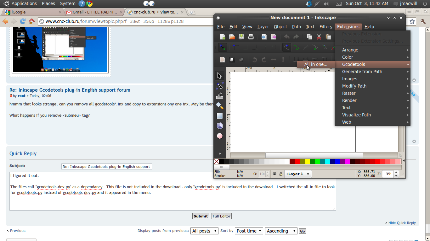

Hi there, I have a fresh install of Ubuntu 10.04 and Inkscape.
I have downloaded the latest version of gcodetools (1.6.03). I followed the directions and it shows up as a section in the extension menu.
Unfortunately - I cannot get any futher - I click on the arrow to get the extensions themselves and there is nothing there - just a single pixel line with nothing populated in it. I must be missing some dependency that is not listed in the forums anywhere. Does anybody have any ideas what may be wrong?
Thanks
Jonathan
Hi!
Try starting inkscape from terminal. It could give more info about what is wrong. (post here any error messages, they should appear just before the window shows up, or when you are activating Gcodetools menu)
There should not be any extra dependences. And if the Gcodetools menu shows up, there should be something in it.
Normally you should get something like this:

I wish I could actually capture the screen to show you the single line that appears instead of the sub-menu you show on your screen - but the screen capture does not work unless I close the menu. How did you get that screen capture?
As far as running inkscape from the terminal - i get no errors at all, inkscape just runs.
On an aside - I installed it on my netbook and it seems to run just fine - but I have used it as my test platform and it has several other inkscape extensions installed. I cannot understand why it will not run on the desktop with a clean install.
Isnt there a file that is required to tell inkscape what to populate the dropdown menu with? Which file is that and where should it live?
Thanks
There's a hack how to make a screenshot of the menu ;) . Launch Accessories -> Take a screenshot and set up delay. Then go to inkscape open the menu and wait for the delay. Usually 4 seconds is enough.
Each menu item is described in the .inx files. At the end of the file there's section:
    <effect>
		<effects-menu>
			<submenu _name="Gcodetools"/>
		</effects-menu>
		<object-type>path</object-type>
    </effect>
So removing submenu element should put it into the extensions root menu.
By the way there should be a common Gcodetools element which contains all the functions.
Сообщение jmacwill »
Thanks for that
The screenshot is attached, also with the terminal window demonstrating the clear lack of errors.
Just for your own intrest, I included a listing of the files in my extensions directory:

Not sure if it helps, but you may see something obvious.
I will dig into the code for the extensions later today - hopefully I can get them working on this machine (though that doesn't make sense to me why it would be different)
Thanks again
Jonathan
Screenshot-1.png (13352 просмотра) <a class='original' href='./download/file.php?id=734&mode=view' target=_blank>Загрузить оригинал (198.35 КБ)</a>

I figured it out.
The files call "gcodetools-dev.py" as a dependancy. This file is not included in the download - only "gcodetools.py" is included in the download. I switched the all in file to look for gcodetools.py instead of gcodetools-dev.py and it appeared in the menu.
Now, my question is:
Do I modify each .inx file to call gcodetools.py?
Do I rename gcodetools.py to gcodetools-dev.py?
OR
Do I ask you to supply me a copy of gcodetools-dev.py because it is a completely different file than gcodetools.py?
Thanks for your help!
Ups... that's my fault.
gcodetools-dev is a development version. Probably I've forgot to change the dependences when we've made a release. Most of us have not noticed it because we have both dev and stable versions. I'll check it recently.
Thanks for the report!
I think that every choice that write should fix the problem.
Now develop focused mostly on graffiti extension. You can read about using google translate. http://translate.google.com/translate?j ... 3%26t%3D91
By the way you can read all the Russian pages on this site pressing the flags at the top right of the page.

It fired up!
I modified the inx files to call gcodetools.py
looks great, but I am getting a new error :(
what do you think?
Jonathan
Desk 1_002.png (13334 просмотра) <a class='original' href='./download/file.php?id=739&mode=view' target=_blank>Загрузить оригинал (193.14 КБ)</a>
This means that you have one parameter with empty name.
The whole picture with extensions looks as follows:
1. extension is a separate python script.
2. when you run extension from the inkscape it executes something like this:
"python egcodetools.py --param_name=value ... --svg='plain svg'" and get's the resultin plain svg from the standard output.
"Unknown option --" means that there's a parameter without name.
May be it'll be easier to you to try dev version. To get it you'll need bazaar.
sudo apt-get bzr
#then get the gcodetools dev version to current dir:
bazaar branch lp:gcodetools
#go inside gcodetools
cd gcodetools
#then generate all inx files:
python create_inx.py
#and copy all the files into extensions dir:
sudo cp gcodetools* /usr/share/inkscape/extensions/
By the way where from have you got your version. I've just checked those one that in the header there's no such dependences in the inx files. I remember that I have fixed dependences problem about a month ago. May be you have old version...
