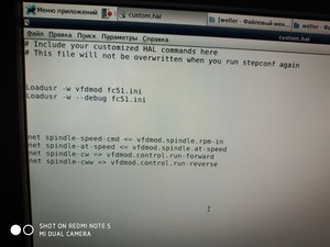

Понял свою ошибку. исправил
сейчас правильно?

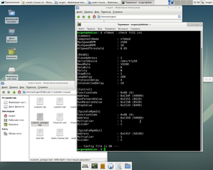

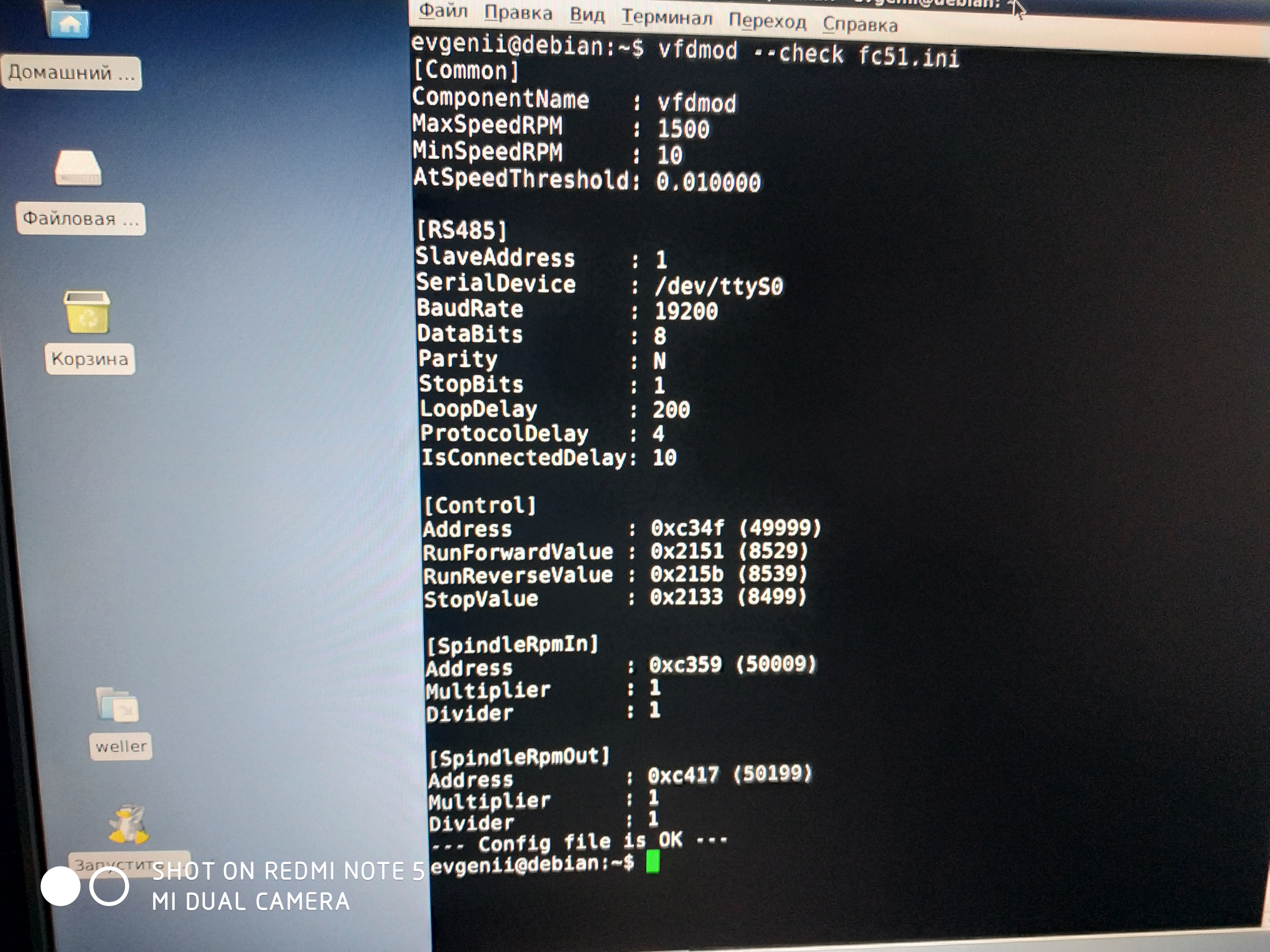

В пользовательских группах не заданы адреса成龙79 писал(а):сейчас правильно?
vfdmod --check config-file-name.ini- aekhv

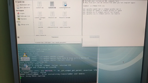

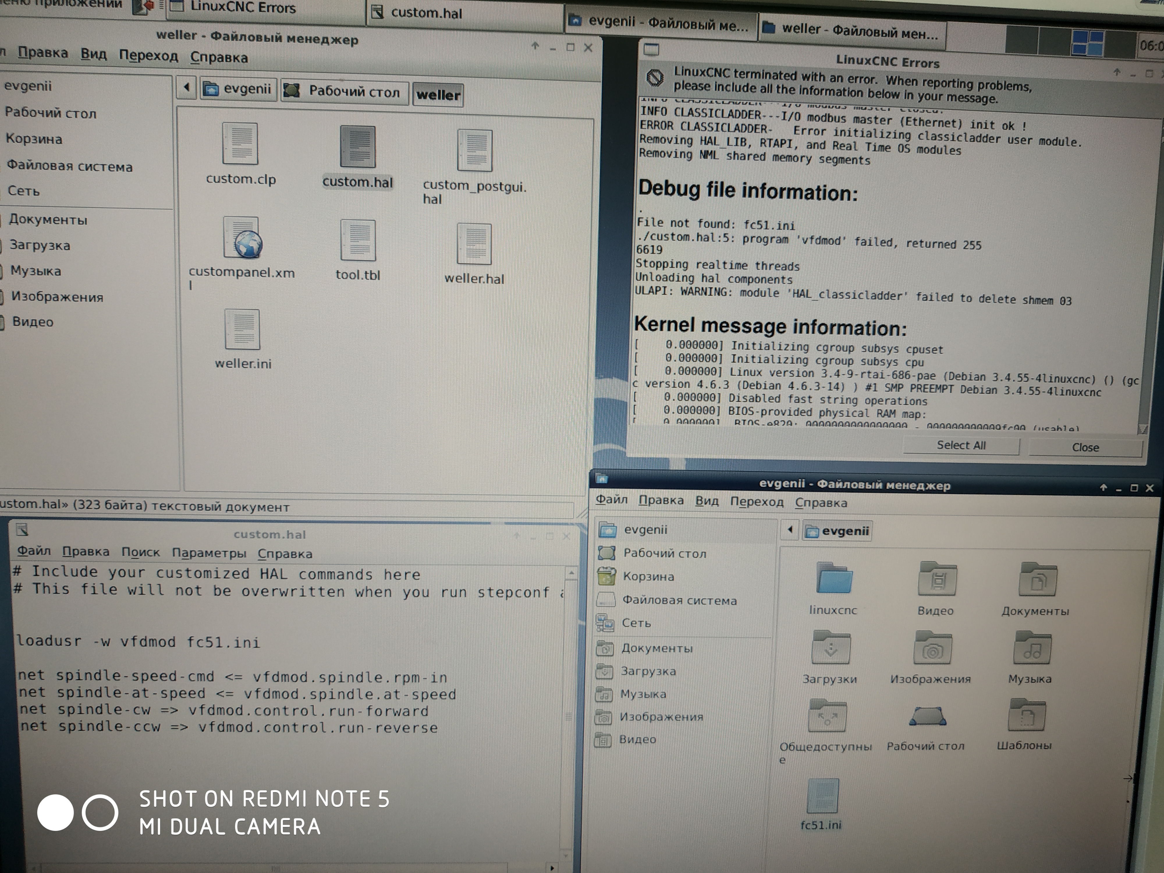

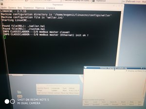

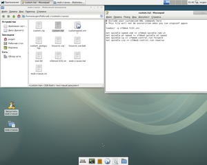

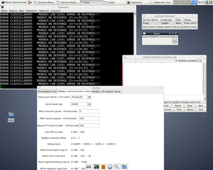

Проверил vfdmod --check всё ок но при внесении строчек в custom Hal при запуске линуксцнц выпадает ошибка
Print file information:
RUN_IN_PLACE=no
LINUXCNC_DIR=
LINUXCNC_BIN_DIR=/usr/bin
LINUXCNC_TCL_DIR=/usr/lib/tcltk/linuxcnc
LINUXCNC_SCRIPT_DIR=
LINUXCNC_RTLIB_DIR=/usr/realtime-3.4-9-rtai-686-pae/modules/linuxcnc
LINUXCNC_CONFIG_DIR=
LINUXCNC_LANG_DIR=/usr/share/linuxcnc/tcl/msgs
INIVAR=inivar
HALCMD=halcmd
LINUXCNC_EMCSH=/usr/bin/wish8.5
LINUXCNC - 2.7.15
Machine configuration directory is '/home/evgenii/linuxcnc/configs/weller'
Machine configuration file is 'weller.ini'
INIFILE=/home/evgenii/linuxcnc/configs/weller/weller.ini
PARAMETER_FILE=linuxcnc.var
TASK=milltask
HALUI=
DISPLAY=axis
Starting LinuxCNC...
Starting LinuxCNC server program: linuxcncsvr
Loading Real Time OS, RTAPI, and HAL_LIB modules
Starting LinuxCNC IO program: io
Found file(REL): ./weller.hal
Found file(REL): ./custom.hal
Shutting down and cleaning up LinuxCNC...
INFO CLASSICLADDER---I/O modbus master closed!
INFO CLASSICLADDER---I/O modbus master (Ethernet) init ok !
ERROR CLASSICLADDER- Error initializing classicladder user module.
Removing HAL_LIB, RTAPI, and Real Time OS modules
Removing NML shared memory segments
Debug file information:
./custom.hal:6: Unknown command 'Loadusr'
4656
Stopping realtime threads
Unloading hal components
ULAPI: WARNING: module 'HAL_classicladder' failed to delete shmem 03

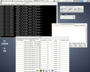

[ 10.267496] No ACPI video bus found
[ 10.267559] [drm] Initialized i915 1.6.0 20080730 for 0000:00:02.0 on minor 0
[ 12.153220] Adding 2077692k swap on /dev/sda5. Priority:-1 extents:1 across:2077692k
[ 12.171296] EXT4-fs (sda1): re-mounted. Opts: (null)
[ 12.491461] EXT4-fs (sda1): re-mounted. Opts: errors=remount-ro
[ 12.617603] loop: module loaded
[ 14.045207] RPC: Registered named UNIX socket transport module.
[ 14.045212] RPC: Registered udp transport module.
[ 14.045214] RPC: Registered tcp transport module.
[ 14.045216] RPC: Registered tcp NFSv4.1 backchannel transport module.
[ 14.077849] FS-Cache: Loaded
[ 14.116269] NFS: Registering the id_resolver key type
[ 14.116307] FS-Cache: Netfs 'nfs' registered for caching
[ 14.128725] Installing knfsd (copyright (C) 1996 okir@monad.swb.de).
[ 18.072370] input: ACPI Virtual Keyboard Device as /devices/virtual/input/input10
[ 19.518309] Bluetooth: Core ver 2.16
[ 19.518340] NET: Registered protocol family 31
[ 19.518343] Bluetooth: HCI device and connection manager initialized
[ 19.518346] Bluetooth: HCI socket layer initialized
[ 19.518348] Bluetooth: L2CAP socket layer initialized
[ 19.518356] Bluetooth: SCO socket layer initialized
[ 19.636473] Bluetooth: RFCOMM TTY layer initialized
[ 19.636480] Bluetooth: RFCOMM socket layer initialized
[ 19.636483] Bluetooth: RFCOMM ver 1.11
[ 19.734267] Bluetooth: BNEP (Ethernet Emulation) ver 1.3
[ 19.734271] Bluetooth: BNEP filters: protocol multicast
[ 21.060103] lp0: using parport0 (interrupt-driven).
[ 21.271887] ppdev: user-space parallel port driver
[ 22.460820] atl1 0000:01:00.0: Unable to enable MSI: -1
[ 22.461014] ADDRCONF(NETDEV_UP): eth0: link is not ready
[ 1530.930937] I-pipe: head domain RTAI registered.
[ 1530.930946] RTAI[hal]: compiled with gcc version 4.7.2 (Debian 4.7.2-5) .
[ 1530.930985] RTAI[hal]: mounted (IPIPE-NOTHREADS, IMMEDIATE (INTERNAL IRQs DISPATCHED), ISOL_CPUS_MASK: 0).
[ 1530.930990] SYSINFO: CPUs 2, LINUX APIC IRQ 2312, TIM_FREQ 12499048, CLK_FREQ 1999919000, CPU_FREQ 1999919000
[ 1530.930993] RTAI_APIC_TIMER_IPI: RTAI DEFINED 2314, VECTOR 2314; LINUX_APIC_TIMER_IPI: RTAI DEFINED 2312, VECTOR 2312
[ 1530.930997] TIMER NAME: lapic; VARIOUSLY FOUND APIC FREQs: 12499048, 12499048, 8381250
[ 1530.992678] RTAI[malloc]: global heap size = 2097152 bytes, <BSD>.
[ 1530.992734] , <uses LINUX SYSCALLs>, kstacks pool size = 524288 bytes.
[ 1530.992739] RTAI[sched]: hard timer type/freq = APIC/12499048(Hz); default timing: oneshot; linear timed lists.
[ 1530.992743] RTAI[sched]: Linux timer freq = 250 (Hz), TimeBase freq = 1999919000 hz.
[ 1530.992746] RTAI[sched]: timer setup = 999 ns, resched latency = 2944 ns.
[ 1531.014103] RTAI[math]: loaded.
[ 1531.211160] config string '0x378 out'
[ 1531.233871] classicladder_rt: module license 'LGPL' taints kernel.
[ 1531.233876] Disabling lock debugging due to kernel taint
[ 1531.234214] creating ladder-state
[ 1534.187006] RTAI[math]: unloaded.
[ 1534.189258] SCHED releases registered named ALIEN PEDV$D
[ 1534.195804] RTAI[malloc]: unloaded.
[ 1534.292028] RTAI[sched]: unloaded (forced hard/soft/hard transitions: traps 0, syscalls 0).
[ 1534.294271] I-pipe: head domain RTAI unregistered.
[ 1534.294318] RTAI[hal]: unmounted.
[ 1813.512249] I-pipe: head domain RTAI registered.
[ 1813.512257] RTAI[hal]: compiled with gcc version 4.7.2 (Debian 4.7.2-5) .
[ 1813.512299] RTAI[hal]: mounted (IPIPE-NOTHREADS, IMMEDIATE (INTERNAL IRQs DISPATCHED), ISOL_CPUS_MASK: 0).
[ 1813.512303] SYSINFO: CPUs 2, LINUX APIC IRQ 2312, TIM_FREQ 12499048, CLK_FREQ 1999919000, CPU_FREQ 1999919000
[ 1813.512306] RTAI_APIC_TIMER_IPI: RTAI DEFINED 2314, VECTOR 2314; LINUX_APIC_TIMER_IPI: RTAI DEFINED 2312, VECTOR 2312
[ 1813.512310] TIMER NAME: lapic; VARIOUSLY FOUND APIC FREQs: 12499048, 12499048, 12447500
[ 1813.521045] RTAI[malloc]: global heap size = 2097152 bytes, <BSD>.
[ 1813.521094] , <uses LINUX SYSCALLs>, kstacks pool size = 524288 bytes.
[ 1813.521100] RTAI[sched]: hard timer type/freq = APIC/12499048(Hz); default timing: oneshot; linear timed lists.
[ 1813.521104] RTAI[sched]: Linux timer freq = 250 (Hz), TimeBase freq = 1999919000 hz.
[ 1813.521106] RTAI[sched]: timer setup = 999 ns, resched latency = 2944 ns.
[ 1813.527126] RTAI[math]: loaded.
[ 1813.674380] config string '0x378 out'
[ 1813.679682] creating ladder-state
[ 1816.357615] RTAI[math]: unloaded.
[ 1816.359791] SCHED releases registered named ALIEN PEDV$D
[ 1816.365615] RTAI[malloc]: unloaded.
[ 1816.464028] RTAI[sched]: unloaded (forced hard/soft/hard transitions: traps 0, syscalls 0).
[ 1816.466310] I-pipe: head domain RTAI unregistered.
[ 1816.466360] RTAI[hal]: unmounted.
[ 1882.419058] I-pipe: head domain RTAI registered.
[ 1882.419066] RTAI[hal]: compiled with gcc version 4.7.2 (Debian 4.7.2-5) .
[ 1882.419104] RTAI[hal]: mounted (IPIPE-NOTHREADS, IMMEDIATE (INTERNAL IRQs DISPATCHED), ISOL_CPUS_MASK: 0).
[ 1882.419109] SYSINFO: CPUs 2, LINUX APIC IRQ 2312, TIM_FREQ 12499048, CLK_FREQ 1999919000, CPU_FREQ 1999919000
[ 1882.419112] RTAI_APIC_TIMER_IPI: RTAI DEFINED 2314, VECTOR 2314; LINUX_APIC_TIMER_IPI: RTAI DEFINED 2312, VECTOR 2312
[ 1882.419116] TIMER NAME: lapic; VARIOUSLY FOUND APIC FREQs: 12499048, 12499048, 10446250
[ 1882.428218] RTAI[malloc]: global heap size = 2097152 bytes, <BSD>.
[ 1882.428264] , <uses LINUX SYSCALLs>, kstacks pool size = 524288 bytes.
[ 1882.428269] RTAI[sched]: hard timer type/freq = APIC/12499048(Hz); default timing: oneshot; linear timed lists.
[ 1882.428273] RTAI[sched]: Linux timer freq = 250 (Hz), TimeBase freq = 1999919000 hz.
[ 1882.428276] RTAI[sched]: timer setup = 999 ns, resched latency = 2944 ns.
[ 1882.434272] RTAI[math]: loaded.
[ 1882.580507] config string '0x378 out'
[ 1882.585845] creating ladder-state
[ 1885.261214] spurious APIC interrupt on CPU#0, should never happen.
[ 1885.265466] RTAI[math]: unloaded.
[ 1885.267665] SCHED releases registered named ALIEN PEDV$D
[ 1885.272703] RTAI[malloc]: unloaded.
[ 1885.372034] RTAI[sched]: unloaded (forced hard/soft/hard transitions: traps 0, syscalls 0).
[ 1885.374198] I-pipe: head domain RTAI unregistered.
[ 1885.374242] RTAI[hal]: unmounted.
[ 1939.548676] I-pipe: head domain RTAI registered.
[ 1939.548684] RTAI[hal]: compiled with gcc version 4.7.2 (Debian 4.7.2-5) .
[ 1939.548732] RTAI[hal]: mounted (IPIPE-NOTHREADS, IMMEDIATE (INTERNAL IRQs DISPATCHED), ISOL_CPUS_MASK: 0).
[ 1939.548736] SYSINFO: CPUs 2, LINUX APIC IRQ 2312, TIM_FREQ 12499048, CLK_FREQ 1999919000, CPU_FREQ 1999919000
[ 1939.548740] RTAI_APIC_TIMER_IPI: RTAI DEFINED 2314, VECTOR 2314; LINUX_APIC_TIMER_IPI: RTAI DEFINED 2312, VECTOR 2312
[ 1939.548744] TIMER NAME: lapic; VARIOUSLY FOUND APIC FREQs: 12499048, 12499048, 12420250
[ 1939.557727] RTAI[malloc]: global heap size = 2097152 bytes, <BSD>.
[ 1939.557783] , <uses LINUX SYSCALLs>, kstacks pool size = 524288 bytes.
[ 1939.557788] RTAI[sched]: hard timer type/freq = APIC/12499048(Hz); default timing: oneshot; linear timed lists.
[ 1939.557792] RTAI[sched]: Linux timer freq = 250 (Hz), TimeBase freq = 1999919000 hz.
[ 1939.557795] RTAI[sched]: timer setup = 999 ns, resched latency = 2944 ns.
[ 1939.565133] RTAI[math]: loaded.
[ 1939.712532] config string '0x378 out'
[ 1939.717582] creating ladder-state
[ 1942.421743] RTAI[math]: unloaded.
[ 1942.423823] SCHED releases registered named ALIEN PEDV$D
[ 1942.426088] RTAI[malloc]: unloaded.
[ 1942.524029] RTAI[sched]: unloaded (forced hard/soft/hard transitions: traps 0, syscalls 0).
[ 1942.526199] I-pipe: head domain RTAI unregistered.
[ 1942.526251] RTAI[hal]: unmounted.
[ 2054.576794] I-pipe: head domain RTAI registered.
[ 2054.576802] RTAI[hal]: compiled with gcc version 4.7.2 (Debian 4.7.2-5) .
[ 2054.576844] RTAI[hal]: mounted (IPIPE-NOTHREADS, IMMEDIATE (INTERNAL IRQs DISPATCHED), ISOL_CPUS_MASK: 0).
[ 2054.576848] SYSINFO: CPUs 2, LINUX APIC IRQ 2312, TIM_FREQ 12499048, CLK_FREQ 1999919000, CPU_FREQ 1999919000
[ 2054.576852] RTAI_APIC_TIMER_IPI: RTAI DEFINED 2314, VECTOR 2314; LINUX_APIC_TIMER_IPI: RTAI DEFINED 2312, VECTOR 2312
[ 2054.576855] TIMER NAME: lapic; VARIOUSLY FOUND APIC FREQs: 12499048, 12499048, 12415500
[ 2054.585848] RTAI[malloc]: global heap size = 2097152 bytes, <BSD>.
[ 2054.585896] , <uses LINUX SYSCALLs>, kstacks pool size = 524288 bytes.
[ 2054.585901] RTAI[sched]: hard timer type/freq = APIC/12499048(Hz); default timing: oneshot; linear timed lists.
[ 2054.585905] RTAI[sched]: Linux timer freq = 250 (Hz), TimeBase freq = 1999919000 hz.
[ 2054.585908] RTAI[sched]: timer setup = 999 ns, resched latency = 2944 ns.
[ 2054.592340] RTAI[math]: loaded.
[ 2054.740060] config string '0x378 out'
[ 2054.745727] creating ladder-state
[ 2067.936058] RTAI[math]: unloaded.
[ 2067.938408] SCHED releases registered named ALIEN PEDV$D
[ 2067.945007] RTAI[malloc]: unloaded.
[ 2068.044036] RTAI[sched]: unloaded (forced hard/soft/hard transitions: traps 0, syscalls 0).
[ 2068.046453] I-pipe: head domain RTAI unregistered.
[ 2068.046503] RTAI[hal]: unmounted.
[ 2109.366417] I-pipe: head domain RTAI registered.
[ 2109.366425] RTAI[hal]: compiled with gcc version 4.7.2 (Debian 4.7.2-5) .
[ 2109.366466] RTAI[hal]: mounted (IPIPE-NOTHREADS, IMMEDIATE (INTERNAL IRQs DISPATCHED), ISOL_CPUS_MASK: 0).
[ 2109.366470] SYSINFO: CPUs 2, LINUX APIC IRQ 2312, TIM_FREQ 12499048, CLK_FREQ 1999919000, CPU_FREQ 1999919000
[ 2109.366474] RTAI_APIC_TIMER_IPI: RTAI DEFINED 2314, VECTOR 2314; LINUX_APIC_TIMER_IPI: RTAI DEFINED 2312, VECTOR 2312
[ 2109.366478] TIMER NAME: lapic; VARIOUSLY FOUND APIC FREQs: 12499048, 12499048, 12462000
[ 2109.375163] RTAI[malloc]: global heap size = 2097152 bytes, <BSD>.
[ 2109.375215] , <uses LINUX SYSCALLs>, kstacks pool size = 524288 bytes.
[ 2109.375220] RTAI[sched]: hard timer type/freq = APIC/12499048(Hz); default timing: oneshot; linear timed lists.
[ 2109.375225] RTAI[sched]: Linux timer freq = 250 (Hz), TimeBase freq = 1999919000 hz.
[ 2109.375227] RTAI[sched]: timer setup = 999 ns, resched latency = 2944 ns.
[ 2109.385952] RTAI[math]: loaded.
[ 2109.536464] config string '0x378 out'
[ 2109.541956] creating ladder-state
[ 2112.245531] RTAI[math]: unloaded.
[ 2112.247615] SCHED releases registered named ALIEN PEDV$D
[ 2112.260918] RTAI[malloc]: unloaded.
[ 2112.360028] RTAI[sched]: unloaded (forced hard/soft/hard transitions: traps 0, syscalls 0).
[ 2112.362194] I-pipe: head domain RTAI unregistered.
[ 2112.362239] RTAI[hal]: unmounted.

Re: Vfdmod - управляем частотником по MODBUS RTU
Он ругается у тебя на 6 строку файла custom.hal
Понял Спасибо ! Написал lodusr с маленькой буквы. Теперь ошибка изменилась выдает это : ./custom.hal:6: program 'vfdmod' failed, returned 255
3356
3356
三条通往知识的道路:反思之路是最高贵之路,模仿之路是最简单之路,体验之路是最苦之路
- Taganrog
- Мастер
- Сообщения: 1211
- Зарегистрирован: 15 апр 2015, 16:32
- Репутация: 284
- Настоящее имя: Евгений
- Откуда: Брянск
- Контактная информация:
В предыдущем сообщении вторая строчка loadusr которая с --debug вообще ошибочна. убери ее совсем.
ты даешь команду подключить модуль и даешь ключ, но не написал какой модуль собственно подключать
если хочешь с отладкой то пиши в 1 строку как в инструкции :
loadusr -W vfdmod --debug fc51.ini
Спасибо за обратную связь ! Всё же не получается у меня запустить этот мод
. Удалил строку с Debug в custom hal. но при запуске программы выдает ошибку что файл fc51.ini не найден тк он находится в директории Evgenii . Если я переместить или копировать этот файл fc51.ini в папку конфигурации станка то при запуске linuxcnc загорается два этих окна без основного окна программы
Далее если сделать рестарт linuxcnc выдает такие ошибки
RUN_IN_PLACE=no
LINUXCNC_DIR=
INIVAR=inivar
HALCMD=halcmd
LINUXCNC - 2.7.15
TASK=milltask
HALUI=
DISPLAY=axis

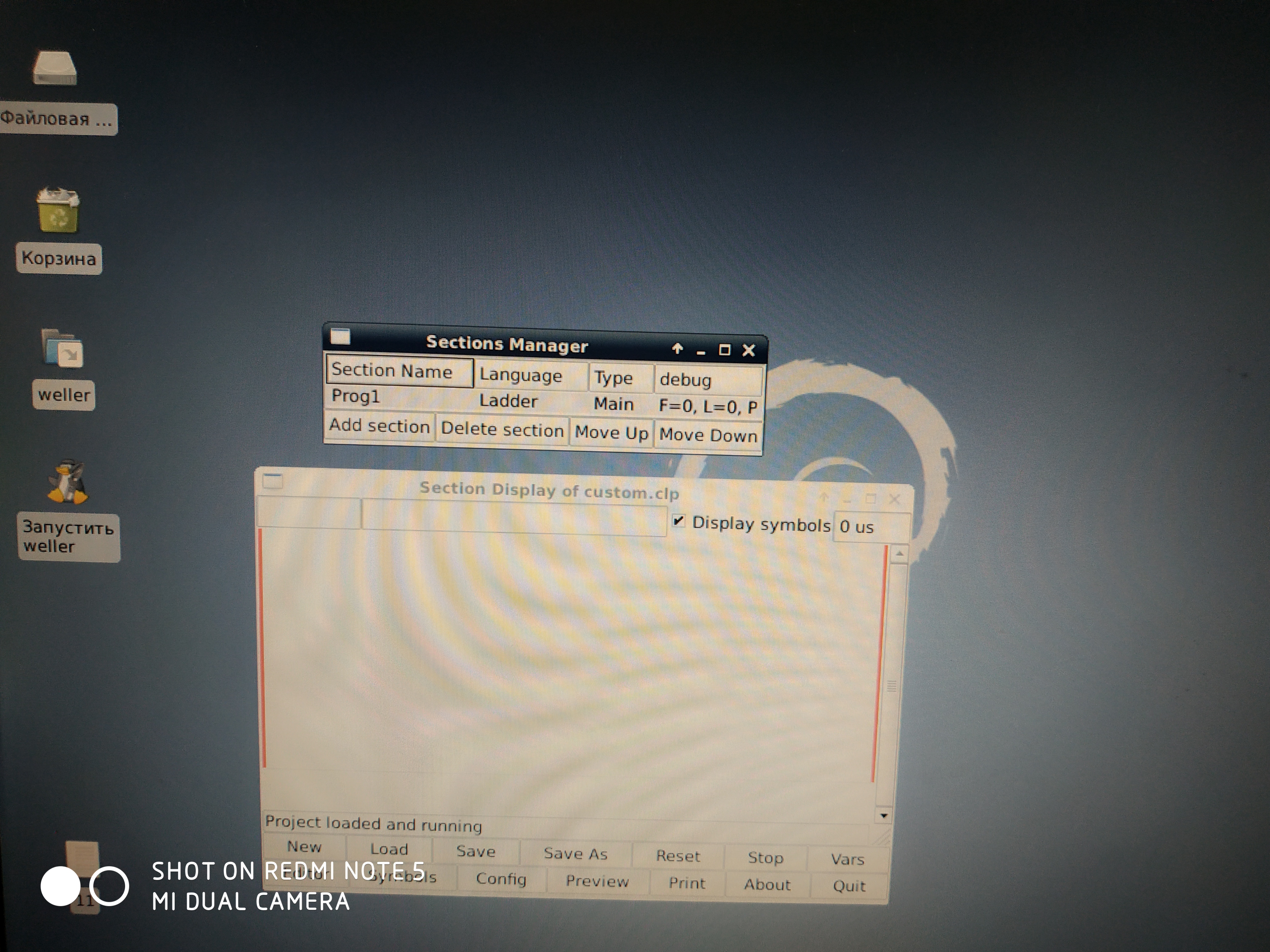

INFO CLASSICLADDER- Ladder GUI closed. Realtime runs till HAL closes
vfdmod: close request received.
vfdmod: application closed.
ERROR: Can't remove RTAI modules, kill the following process(es) first
7092 7106 7113Removing NML shared memory segments
