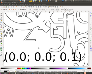

I am completely new to both inkscape and gcodetools (I am using v.0.47 and v1.7, respectively) -- so please bear with me.
I created a path from an outline (see 2nd attachment). After running "path to gcode", I see what's shown in the first attachment. The selected cylindrical tool is wider then the outline, but, gcodetool still creates gcode with the actual tool passing more than once across each line with Z<0. "depth step" under tools is set to 1 (I am not sure what how "depth step" is defined).
How can I force gcodetools/"path to gcode" to pass each section of the outline only once with Z<0 without me having to resort to manually editing the gcode file? I'd very much appreciate any help.

Re: gcodetools "path to gcode" -- number of passes
It's easy :)
Ok, here's how it works. Depth of cut is defined in the orientation points - the third coordinate. Depth step for each pass is defined in tool's definition. So the number of passes will be equal to Round UP ( (Depth of cut)/(Depth step) ) so if you want only one pass just define either small Depth of cut or huge Depth step.

I tried to follow your first suggestion. The Orientation settings are now (0.0; 0.0; 0.1) for x|y=0|0 and for x|y=100|0. You can see the selected tool in the following pictures which also shows that each curve is still traced at least twice:

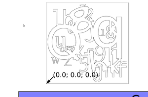

Cutting depth should be between Z0 and Z1 which are defined by orientation points:
(X0,Y0,Z0) - (X1,Y1,Z1)
You have (0.0; 0.0; 0.1) and (100.0; 0.0; 0.1) - so z0=z1 probably - that is the reason that there are no Gcode.
Set them (0.0; 0.0; 0.0) - (100.0; 0.0; 0.1)
UPS... Set them to (0.0; 0.0; 0.0) - (100.0; 0.0; -0.1)

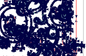

Are you sure?
hmmm....
Aha! Your path is an "outline" of some path so it actually goes two times over almost the same place. Gcodetools cuts outline of the path, an you are trying to cut outline of outline...
See attachment
Снимок-75.png (21937 просмотров) <a class='original' href='./download/file.php?id=24050&mode=view' target=_blank>Загрузить оригинал (310.81 КБ)</a>
