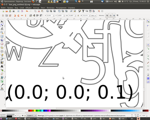

I am completely new to both inkscape and gcodetools (I am using v.0.47 and v1.7, respectively) -- so please bear with me.
I created a path from an outline (see 2nd attachment). After running "path to gcode", I see what's shown in the first attachment. The selected cylindrical tool is wider then the outline, but, gcodetool still creates gcode with the actual tool passing more than once across each line with Z<0. "depth step" under tools is set to 1 (I am not sure what how "depth step" is defined).
How can I force gcodetools/"path to gcode" to pass each section of the outline only once with Z<0 without me having to resort to manually editing the gcode file? I'd very much appreciate any help.

Re: gcodetools "path to gcode" -- number of passes
It's easy :)
Ok, here's how it works. Depth of cut is defined in the orientation points - the third coordinate. Depth step for each pass is defined in tool's definition. So the number of passes will be equal to Round UP ( (Depth of cut)/(Depth step) ) so if you want only one pass just define either small Depth of cut or huge Depth step.
PS There's a post processor which can remove all Z moves if you do not need them.
PSS It'll be better if you attach your svg as well.

I tried to follow your first suggestion. The Orientation settings are now (0.0; 0.0; 0.1) for x|y=0|0 and for x|y=100|0. You can see the selected tool in the following pictures which also shows that each curve is still traced at least twice:
Screenshot-lace_png_outline2.svg - Inkscape.png (21935 просмотров) <a class='original' href='./download/file.php?id=24034&mode=view' target=_blank>Загрузить оригинал (148.85 КБ)</a>
The "path to Gcode" settings are as follows (BTW: for the beginning user like myself, it would be great to get mouse over explanations for these options):
  • All units in mm
    biarc interpolation tolerance 1.0
    maximum splitting depth: 1
    depth function: d
    cutting order: subpath by subpath
    scale along Z axis: 1.0
    offset along Z axis: 0
    Z safe height...: 0.05
But now the NGC file remains empty (except for the header and footer).
What am I doing wrong?
Cutting depth should be between Z0 and Z1 which are defined by orientation points:
(X0,Y0,Z0) - (X1,Y1,Z1)
You have (0.0; 0.0; 0.1) and (100.0; 0.0; 0.1) - so z0=z1 probably - that is the reason that there are no Gcode.
Set them (0.0; 0.0; 0.0) - (100.0; 0.0; 0.1)

Thank you very much for you immediate reply, Nick. I followed you suggestion and I am getting gcode now, but all Z values are >=0; path to gcode settings as in my above post. Is the cutting depth interpolated between 0|0 and 100|100? 0.1 may then not be quite sufficient. Again, I would be happy with any Z<0 when cutting.
UPS... Set them to (0.0; 0.0; 0.0) - (100.0; 0.0; -0.1)
Are you sure?
hmmm....
Aha! Your path is an "outline" of some path so it actually goes two times over almost the same place. Gcodetools cuts outline of the path, an you are trying to cut outline of outline...
See attachment
Снимок-75.png (21923 просмотра) <a class='original' href='./download/file.php?id=24050&mode=view' target=_blank>Загрузить оригинал (310.81 КБ)</a>

That explains that -- thanks! Any suggestion how I could generate a single line path from a number of alphabetic and numerical characters? What I did was this: export the graph as a bitmap, reimport it, and then perform "trace bitmap". Sorry, I am completely new to Inkscape and probably not using the optimal approach...
fhs писал(а): export the graph as a bitmap, reimport it, and then perform "trace bitmap"
this is the problem - tracing bitmaps is not a good solution for further machining.
fhs писал(а): Any suggestion how I could generate a single line path from a number of alphabetic and numerical characters?
Just draw them inside inkscape with text tool (F8), then convert texts to paths by Path - Convert to path (Ctrl+Shift+C). (you can also combine, add, subtract and do a lot of operations with it afterwards)
