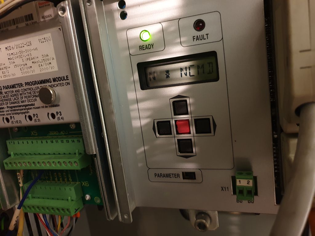

Anyone got any idea what might cause N * NCMD on this controller.....
And is there anything I can measure to check that it get's the signals it's supposed to ? (it got the DC rail OK, but won't output any voltage to the motor).
20191109_160137_1.jpg (11318 просмотров) <a class='original' href='./download/file.php?id=174970&mode=view' target=_blank>Загрузить оригинал (124.87 КБ)</a>

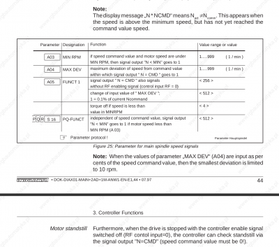

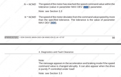

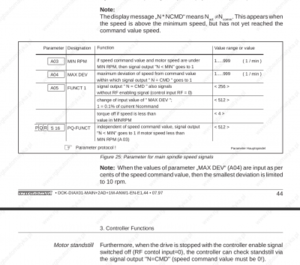

found some info but not sure if it helps.
Screenshot from 2019-11-10 18-52-39.png (11318 просмотров) <a class='original' href='./download/file.php?id=174971&mode=view' target=_blank>Загрузить оригинал (73.34 КБ)</a>
Screenshot from 2019-11-10 18-56-38.png (11318 просмотров) <a class='original' href='./download/file.php?id=174972&mode=view' target=_blank>Загрузить оригинал (112.62 КБ)</a>
I suspect it might be something wrong with the spindle drive, but it does show the green "ready" light, so before pulling it out it would be nice to have checked out what could be checked....
