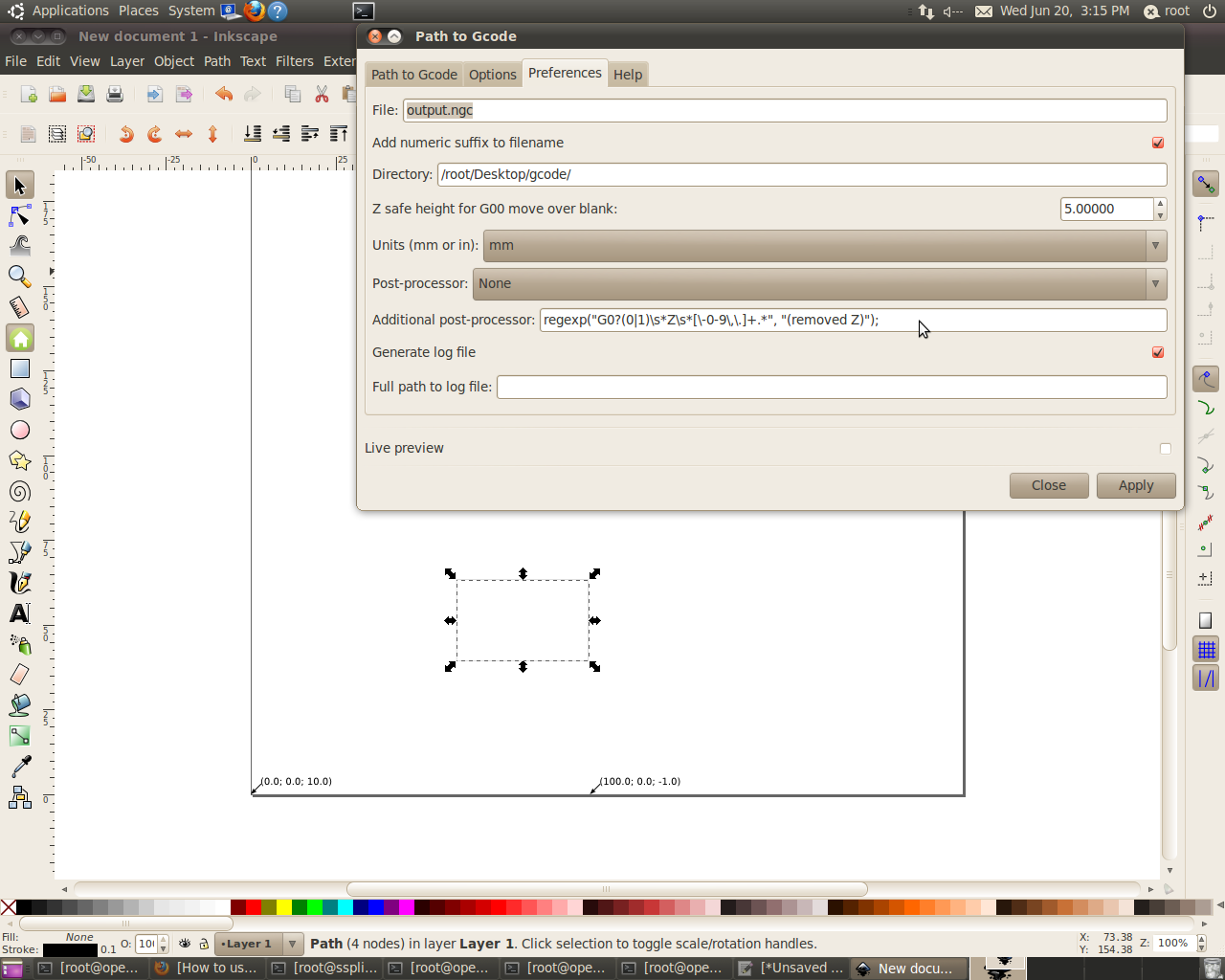

from where i can remove z Post-processor . can u explain step by step. i am using version 1.7 of gcodetools.
Re: How to use gcodetool extension in inksacpe ?
Preferences tab - Additional post processor - paste there this string:
regexp("G0?(0|1)\s*Z\s*[\-0-9\,\.]+.*", "(removed Z)");
chaudhary
Сообщения: 8
Зарегистрирован: 19 июн 2012, 11:14
Сообщение chaudhary »

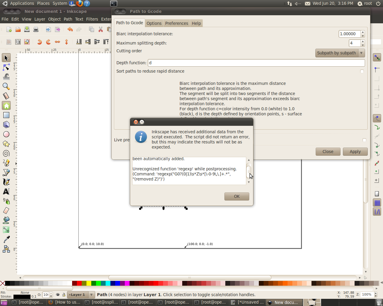

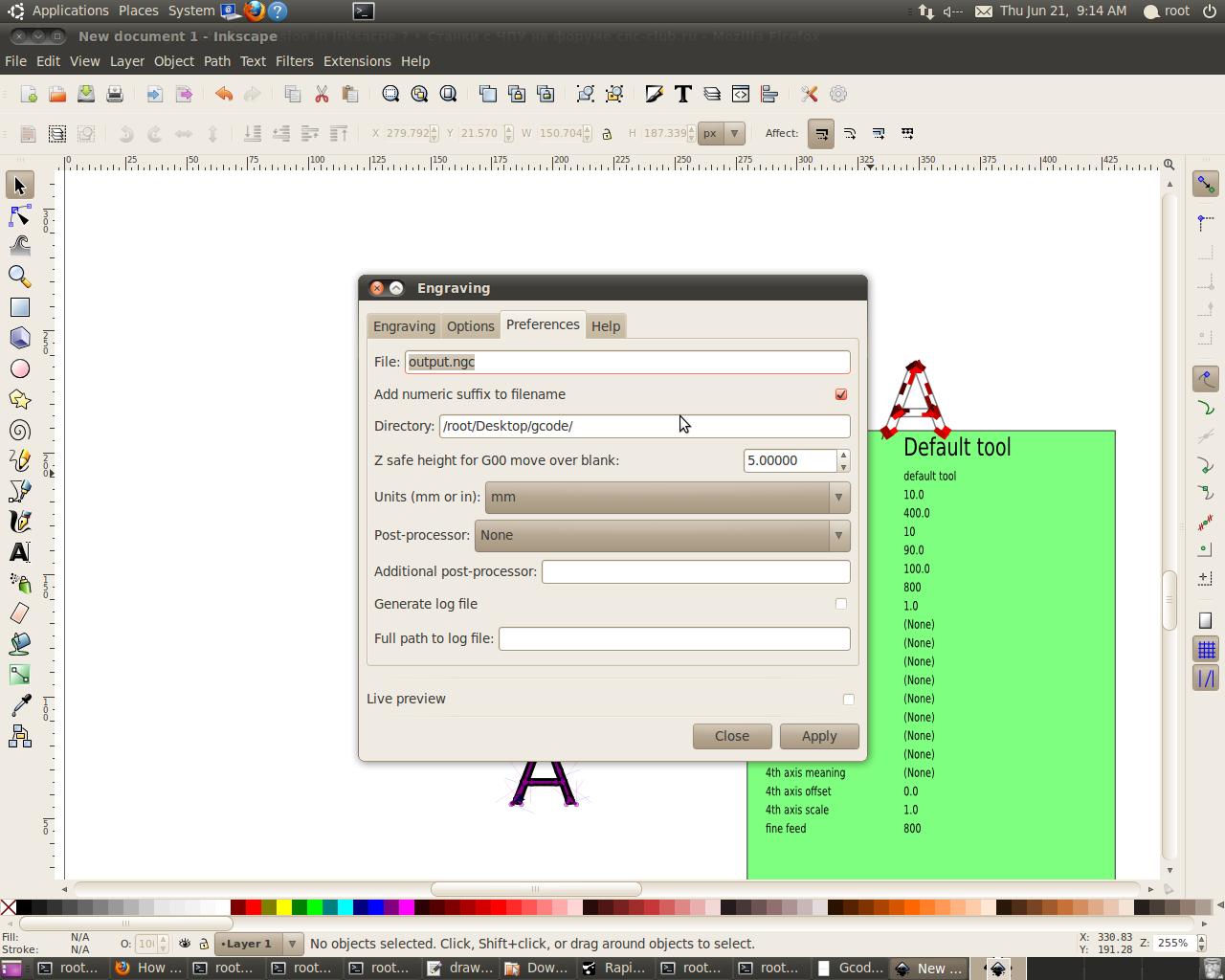

as per your reply i do but i face problem. i have attach screenshot. please check it.
Add string here..!! (23676 просмотров) <a class='original' href='./download/file.php?id=6060&mode=view' target=_blank>Загрузить оригинал (167.73 КБ)</a>
Add string here..!!
Error display (23676 просмотров) <a class='original' href='./download/file.php?id=6062&mode=view' target=_blank>Загрузить оригинал (198.51 КБ)</a>
Error display
It seems that regexp function is invoked only in dev version...
The way you can get it is described over here: http://cnc-club.ru/forum/viewtopic.php? ... st_version
UPD: Upss it should be regex, not regexp so :
regex("G0?(0|1)\s*Z\s*[\-0-9\,\.]+.*", "(removed Z)");

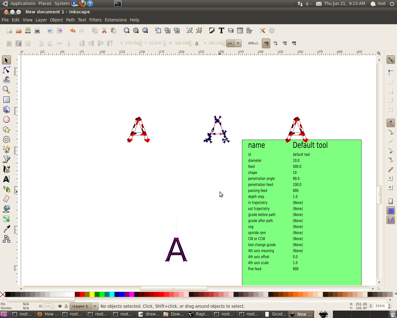

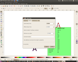

I am doing engraving step by step. may i know is this correct. i mention all step in below.
Step 1. first Write 'A' character in inkscape
Step 2. Select orientation point from gcodetool here i am select orientation type is '2 point mode' here my setting is ZSurface = 10 ,z depth is = 0.0 and unit is =mm
Step 3. select tool library in that i have select default Tool Type.
Step 4. After that do object to path from inkscape

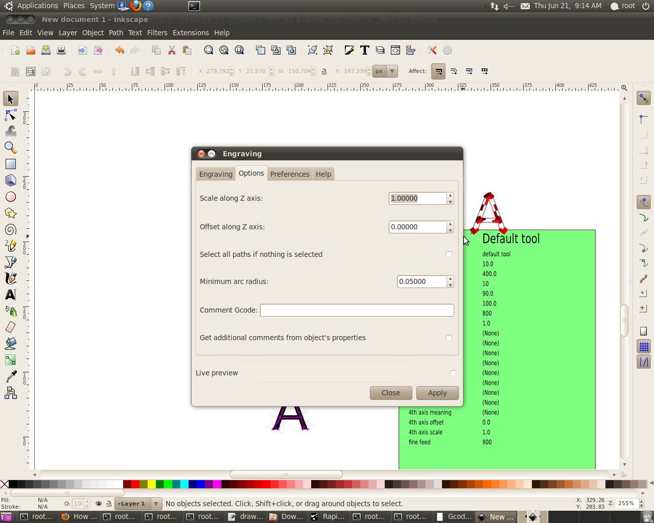

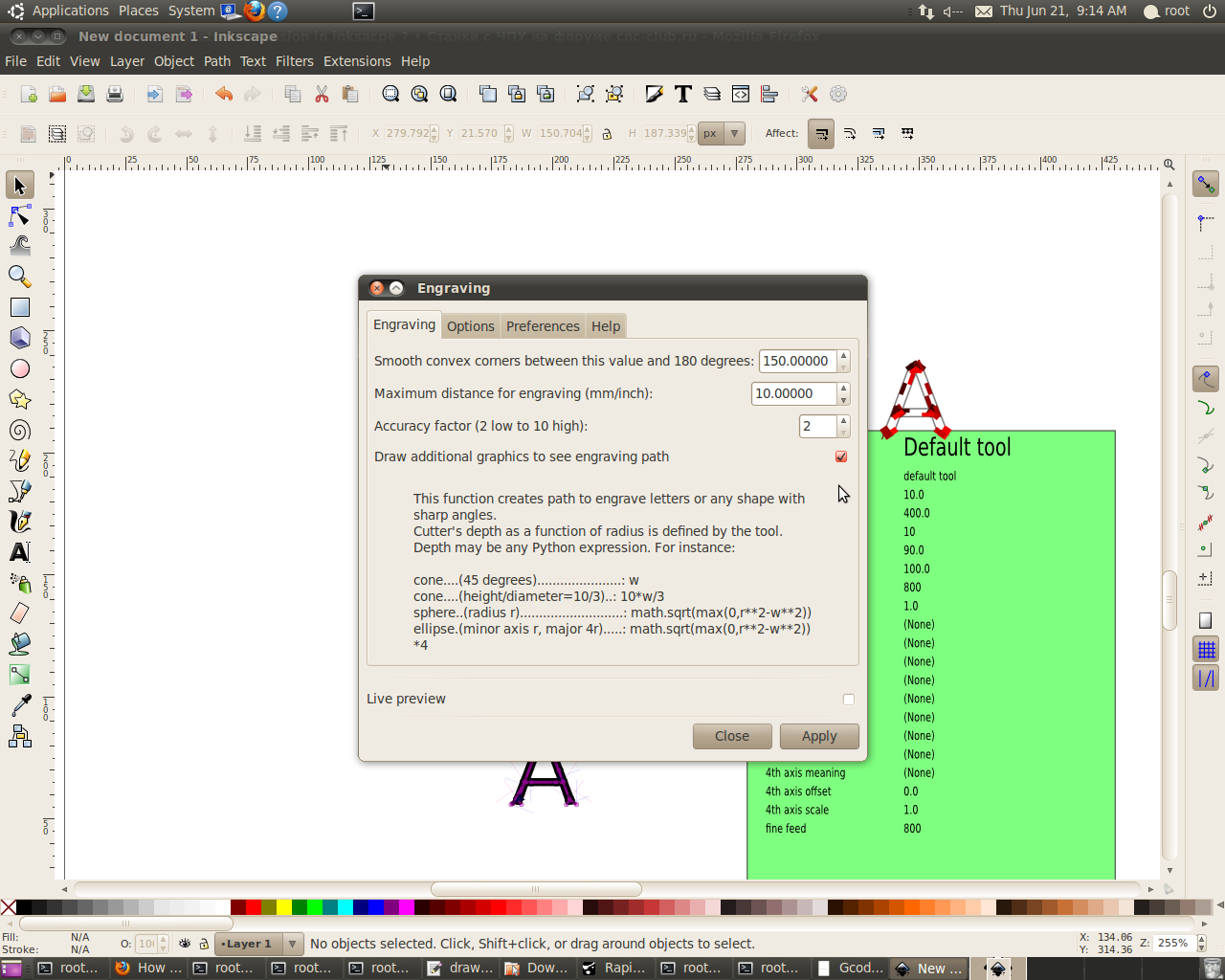

Step 5. After that i have apply engraving. i have attach my engraving settings screenshot.(see i do not understand those options)
Step 6. My result is not good check finalresult.png file from attachment
engravingtab1.png (23659 просмотров) <a class='original' href='./download/file.php?id=6075&mode=view' target=_blank>Загрузить оригинал (217.29 КБ)</a>
engravingtab2.png (23659 просмотров) <a class='original' href='./download/file.php?id=6076&mode=view' target=_blank>Загрузить оригинал (191.73 КБ)</a>
engravingtab3.png (23659 просмотров) <a class='original' href='./download/file.php?id=6077&mode=view' target=_blank>Загрузить оригинал (204.9 КБ)</a>
finalresult.png (23659 просмотров) <a class='original' href='./download/file.php?id=6078&mode=view' target=_blank>Загрузить оригинал (183.71 КБ)</a>
Engraving is not a function for laser. It was made to make engravings with shaped mill's bits (for example conic bit). It makes non constant Z trajectory to cut interior of the path.
For laser engraving, if you want to "cut" out path's interior you should fill the path with trajectories. You can try Fill area from Area. But you'll have to define really small depth.
In fact laser Engraving is not easy thing, most of times special hardware controller is needed. It's that because if you want to get clean engraving you have to control laser power very fast (up to 1 time per stepper step at max speed). Which is not easy even for LinuxCNC. There's some hacks how you can do it, but I've not tried any of them (my laser tube seems to be broken, so I'm unavailable to make the tests, and I have no time ti buy a new one.)
So... Try fill area with Zig-Zag filling (Adjust fill angle ti match your fastest axis). And send us your results :)!

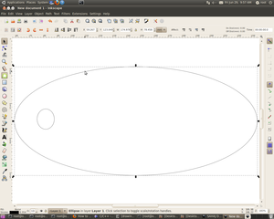

Hi,
I have attach one png file in attachment , it's made from inkscape. You can see one ellipse and inside ellipse one circle drawing. Now i want to cut ellipse out boundary and just mark circle inside ellipse as per drawing with fast feed rate.
So how could i generate gcode using gcodetool. from inkscape.
Screenshot-3.png (23612 просмотров) <a class='original' href='./download/file.php?id=6179&mode=view' target=_blank>Загрузить оригинал (152.39 КБ)</a>
So you want to cut insede circle at fast feed rate and one depth and outside one with another feed rate and depth?
If yes - just put the circles into different layers, add orientation points and tools definitions to each layer and define needed feed rates and depth parameters.
