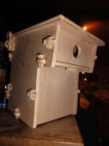

Hi there
This is my first post here, so I will explain a bit what I do.
But first, a LOT of thanks and congratulations for the job done making this plugin :) It was something really missing to the open-source CNC world.
I use linuxCNC on my router for gluing solarpanels at work, and when work is done, I pretty often unscrew the glue pump from the machine, put a spindle on it, and play with gcodetools... And here is my Xmas gift of this year : a little bird's house. To be cut in a 800x600x10mm wood panel with a 6mm cylindrical tool, glue/nails-free assembly, suitable for chidren.
Here are the svg and the ngc files for those who want to try it :
ok_COMPLET_trous_larges_1passe_0001.ngc
(187.74 КБ) 1452 скачивания
chemins -3mm, calepinage 800x600, chemins, trous larges.svg
(59.2 КБ) 1164 скачивания
Should look like this at the end :
DSC04556_1.JPG (7874 просмотра) <a class='original' href='./download/file.php?id=22842&mode=view' target=_blank>Загрузить оригинал (58.43 КБ)</a>
I would like to help you making this wonderful tool, but I understand mostly nothing to python... So as I'm french, I propose to help for french translation if needed.
Have a good day
Yann
-Hey, know what ? If you read the back of the Windows CD you'll ear a satanic song !
-Ho, there's even worse : read it normally, it will install !
Re: Inkscape Gcodetools plug-in English support forum
Wow cool! Birds should like it :).

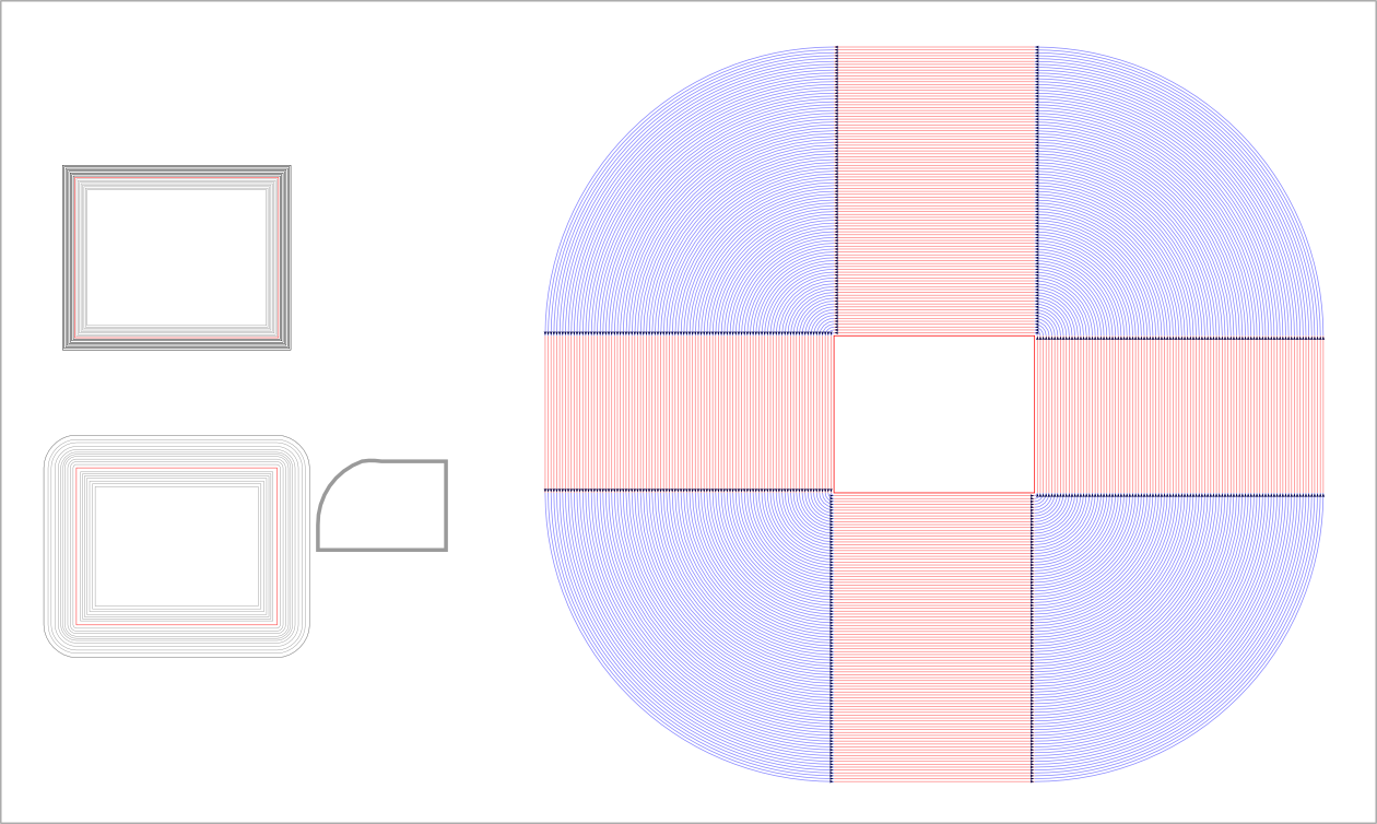

bricofoy писал(а):inkscape should ask for the amount of units you want to inset or outset the path... so you can move your path for half your tool size and it's ok. And now with the newest version I have, the amout of move is defaulted to 2px and I can't find any way to change this.
There are two ways either Path - Dynamyc offset (Ctrl+J) and edit amount in XML editor (Ctrl+Shift+X), or you can define offset's step in Preferences- File-Preferences-Steps.
The bad thing that offset is really complicated procedure and it changes the path from time to time, i.e. offset can be not accurate.

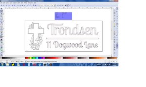

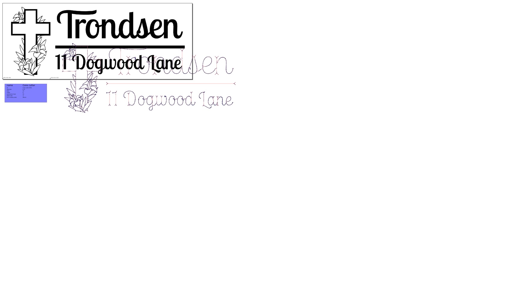

I have used the engrave tool on the path shown, however it produces extra engraving paths at the upper "T" and the lower "d". Is this a problem with my settings, or could it be an issue with the gcode program? svg and ngc files are attached as well. Thanks - BillT
Trondsen Sign path problems.jpg (6988 просмотров) <a class='original' href='./download/file.php?id=24026&mode=view' target=_blank>Загрузить оригинал (251.48 КБ)</a>
Trondsen 11 Dogwood 1-28-14 PATH.svg
(884.02 КБ) 1118 скачиваний
output_0034.ngc
(99.69 КБ) 1337 скачиваний

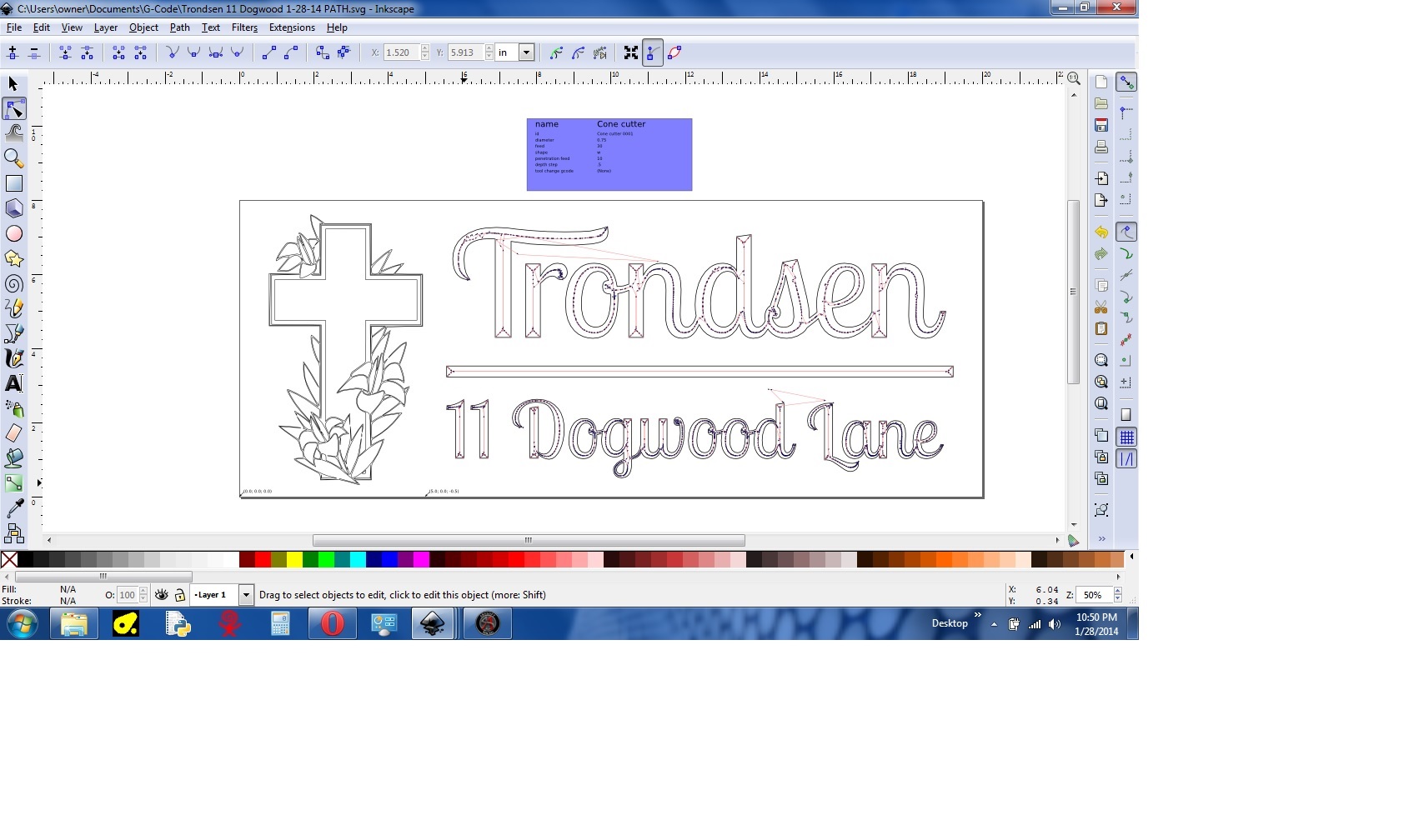

billt
Сообщения: 8
Зарегистрирован: 21 окт 2013, 18:11
Сообщение billt »
I eventually figured this one out.
There were duplicate path points that caused the engraving path problems.
After removing the duplicate points, the engraving path is now fixed.
For some reason the engraving is now offset from the original path.
I am not sure what causes this issue.
All of the paths have been combined prior to running the engrave operation.
Any help would be appreciated.
Thanks - BillT
Trondsen sign path offset.jpg (6943 просмотра) <a class='original' href='./download/file.php?id=24269&mode=view' target=_blank>Загрузить оригинал (105.79 КБ)</a>
billt
Сообщения: 8
Сообщение billt »
Oops.
I must have ungrouped the orientation points from the path group.
When I grouped everything plus orientation points, the result was corrected.
I also found that you need to group the tool definition box as well.
Sorry for the lame posts - hopefully my ignorance may be helpful (or at least entertaining...) to others.
