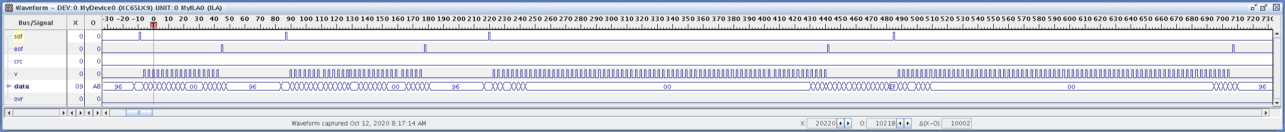

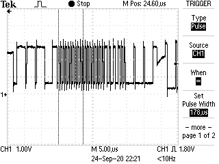

глянул осциллографом на шину RIO - remote I/O, куда цепляются модули ввода-вывода. знакомая картина - HDLC, как на SSCNET. тока, похоже, на половинной частоте. расковыряем чуток попозже...

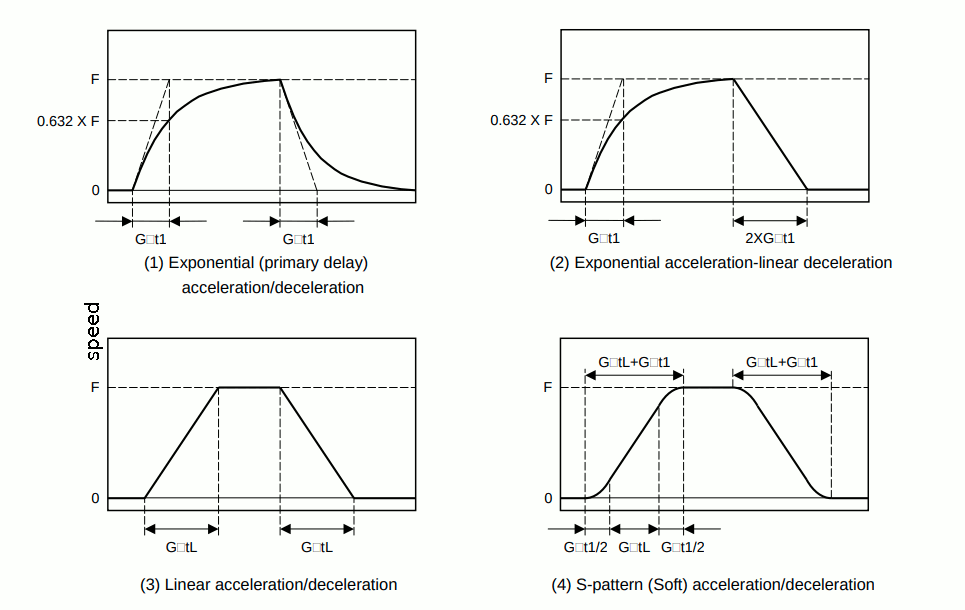

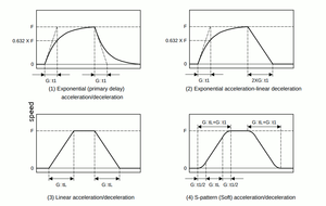

посмотрел повнимательнее мицубисевские мануалы про тюнинг моторов и т.п. вот что пишут про режимы ускорений:
1-1-5 Parameters Concerning with Acceleration/Deceleration Processing
As for acceleration/deceleration control with NC, there are 4 types of processing. The setting of acceleration/deceleration time constant is based on “constant time”, which means that the inclination changes in accordance with the speed. (cf. constant inclination)
(1) Exponential (primary delay) acceleration/deceleration
Acceleration/deceleration is made according to exponential function. This acceleration/deceleration control has been used for a long time as the way it is controlled is very simple. However, it takes longer time to complete positioning and it is not used for rapid traverse feed any more. This is occasionally used for cutting feed.
(2) Exponential acceleration - linear deceleration
This acceleration/deceleration control enabled to shorten the time to complete positioning by improving the exponential acceleration/deceleration control.
(3) Linear acceleration/deceleration
This acceleration/deceleration control is most commonly used. Comparing with exponential acceleration/deceleration control, the motor torque output is more ideal and the time to complete positioning can be reduced. This acceleration/deceleration control requires the memory capacity, therefore, it was limited when using conventional NC though the present NC has been relieved from such a limitation. Use linear acceleration/deceleration for rapid traverse feed. Use also for the cutting feed.
(4) S-pattern (Soft) acceleration/deceleration
Use this acceleration/deceleration control in case that the shock at the start of acceleration when using linear acceleration/deceleration, or in case that the torque output efficiency is not good enough as the acceleration/deceleration torque is not constant (the protrusion can be observed in the torque waveform) in the axis with a large inertia (acceleration/deceleration time constant ≥300ms). However, this acceleration/deceleration type cannot be used for the cutting feed in interpolation axis because the synchronization between axes is not available.
т.е. нет тут никакого ограничения рывка, в лучшем случае - обычная трапеция. s-кривые есть, но при интерполяции (больше одной оси одновременно) их использовать нельзя т.к. синхронизм теряется.

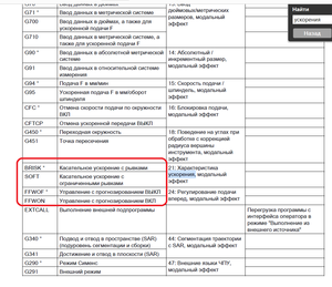

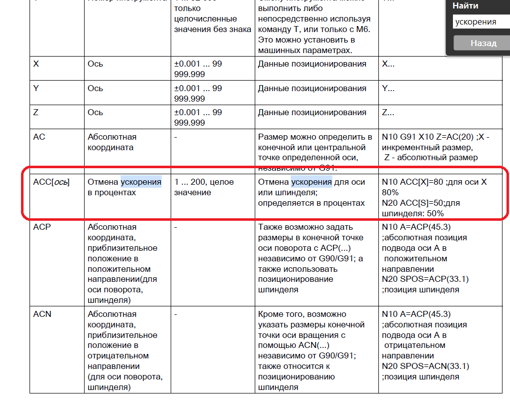

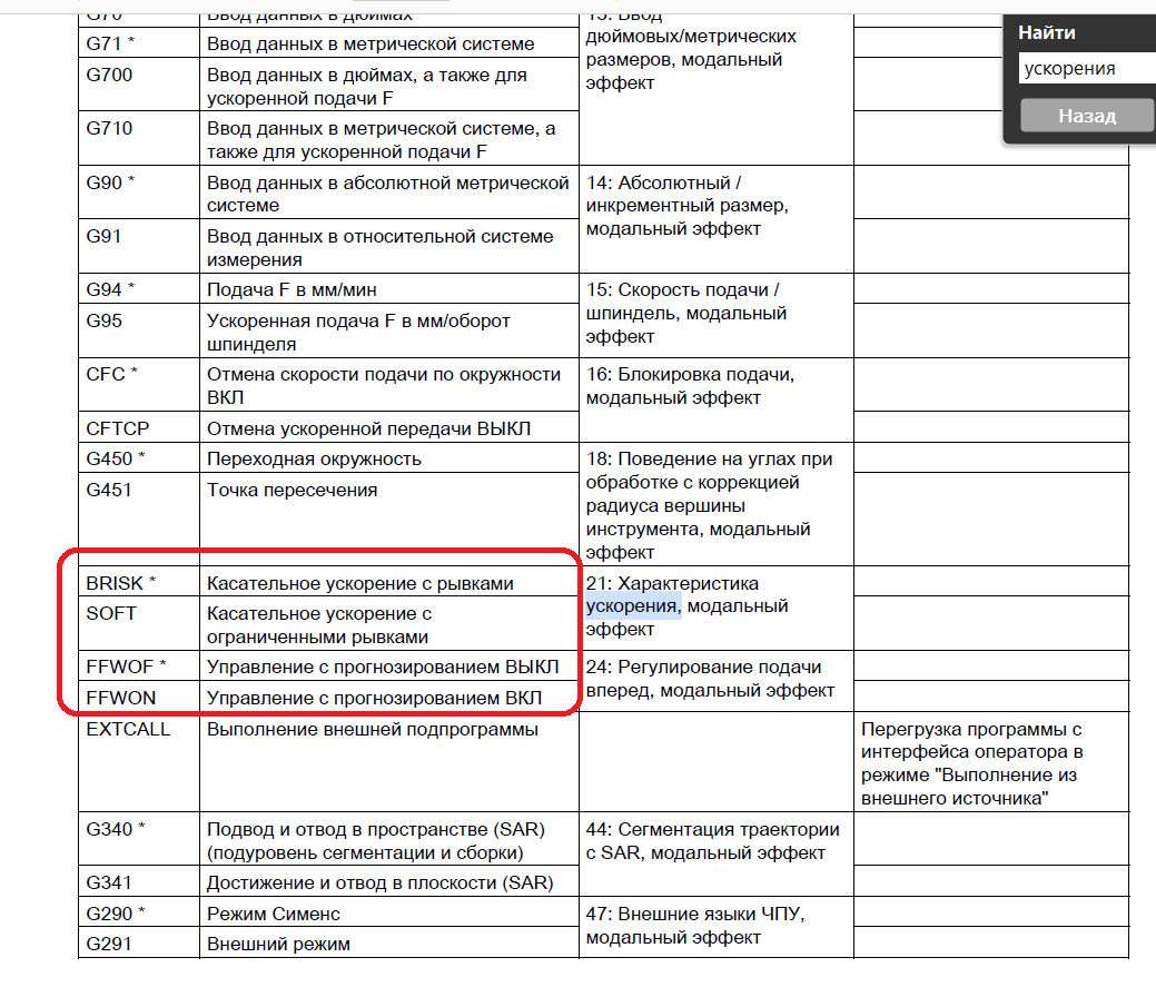

вот у синумерика в мануале много всего про управление планировщиком написано. и про рывки есть в явном виде - что и как делается. но тоже куча "ручек", которые надо подкручивать. так что, возможно, одним параметром "фрезеруй гладко/быстро" оно и правда не совсем решается :)
Re: Контроллер YSSC2P для серво Mitsubishi SSCNET-II (MR-J2S-B)

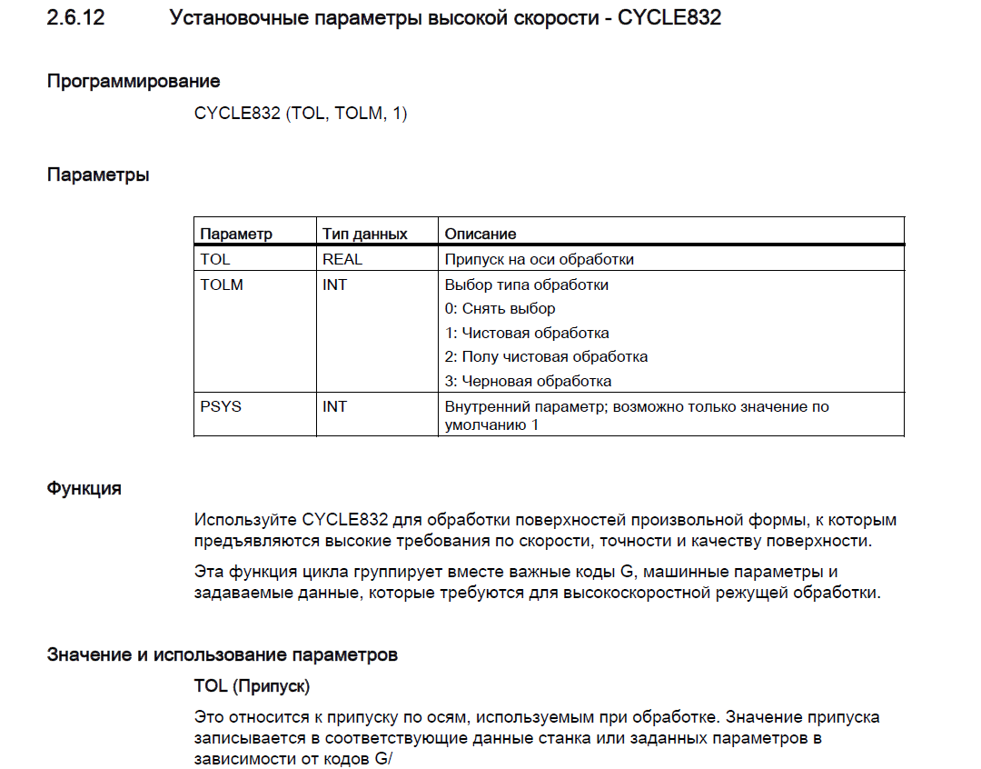

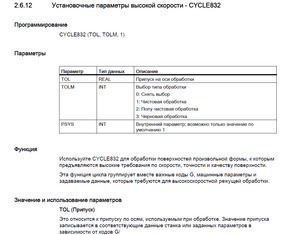

merkwurdigliebe писал(а): ↑ так что, возможно, одним параметром "фрезеруй гладко/быстро" оно и правда не совсем решается
Наверно еще должно решаться на уровне постпроцессоров. Например в зависимости от типа обработки в САМ, постпроцессор "настраивает" стойку под задачу.
У Сименса тип обработки задается через Cycle 832. Это должен прописывать постпроцессор.
01.png (3517 просмотров) <a class='original' href='./download/file.php?id=187103&mode=view' target=_blank>Загрузить оригинал (73.08 КБ)</a>
Можно всякие настройки задавать.
02.png (3517 просмотров) <a class='original' href='./download/file.php?id=187104&mode=view' target=_blank>Загрузить оригинал (98.06 КБ)</a>
И указывать ускорение оси.
03.png (3517 просмотров) <a class='original' href='./download/file.php?id=187105&mode=view' target=_blank>Загрузить оригинал (130.58 КБ)</a>

encoder-00.index-enable сбрасывается как полагается, а вот encoder-01.index-enable на изменения пина 23 не реагирует.
3. кажется есть какой то косяк с обработкой энкодеров. я подключил параллельно каналы A/B для двух энкодеров. Вроде бы считает и одинаково, но если начинаешь быстро крутить - начинают показания расходится! и неслабо так - процентов на 10 от оборота.
энкодер на 2000 пульсов, замкнуты входы A/B прямо перед гребёнкой.
Z метки у них разные, но это вроде на counts / pos не должно влиять?
