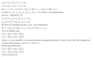

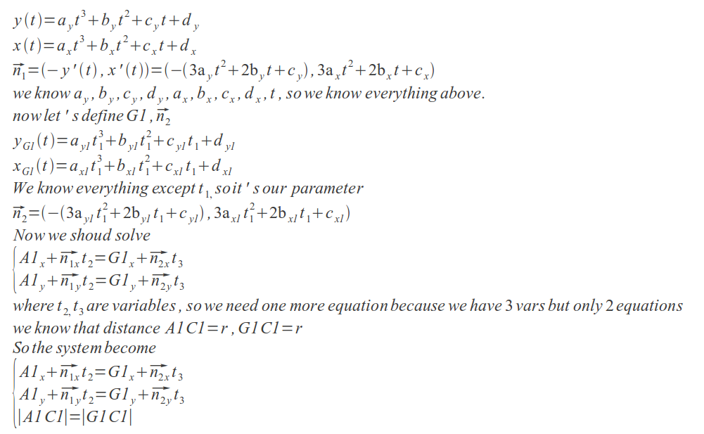

1,2) n1 - is a normal vector at point A1, n2 normal at point G1. So we can define line that goes through A1 and is parallel to n1 as A1+t1*n1 where t1 is a variable. Similar with the second normal G1+t1*n1.
So to find intersection of these lines we have to solve the equation A1+t1*n1 = G1+t2*n2.
here's some nice formatted math:
engraving formulas.png (11230 просмотров) <a class='original' href='./download/file.php?id=1449&mode=view' target=_blank>Загрузить оригинал (85.93 КБ)</a>
oofice formula format (для просмотра содержимого нажмите на ссылку)
y(t) = a_y t^3 + b_y t^2 +c_y t + d_y
newline
x(t) = a_x t^3 + b_x t^2 +c_x t + d_x
newline
widevec {n_1} = (-y'(t),x'(t)) = (-(3a_y t^2 + 2b_y t + c_y), 3a_x t^2 + 2b_x t + c_x)
newline
we know a_y, b_y, c_y, d_y, a_x, b_x, c_x, d_x, t, so we know everything above.
newline
now let's define G1 , widevec {n_2}
newline
y_G1(t) = a_y1 t_1^3 + b_y1 t_1^2 +c_y1 t_1 + d_y1
newline
x_G1(t) = a_x1 t_1^3 + b_x1 t_1^2 +c_x1 t_1 + d_x1
newline
We know everything except t_1, so it's our parameter
newline
widevec {n_2} = (-(3a_y1 t_1^2 + 2b_y1 t_1 + c_y1), 3a_x1 t_1^2 + 2b_x1 t_1 + c_x1)
newline
Now we shoud solve newline
left lbrace stack{
A1_x + widevec{n_1}_x t_2 = G1_x + widevec {n_2}_x t_3
A1_y + widevec{n_1}_y t_2 = G1_y + widevec {n_2}_y t_3
} right none
newline
where t_2, t_3 are variables, so we need one more equation because we have 3 vars but only 2 equations
newline
we know that distance A1 C1 = r, G1 C1 = r
newline
So the system become
newline
left lbrace stack{
lline A1 C1 rline =lline G1 C1 rline
} right none

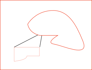

The problem is, this algorithm seems to be very unstable. I notice in the log file that it often takes up to 9 iterations. Newton Raphson is usually much quicker to converge than that, so I think there's something wrong. I just tried commenting it out, so that it isn't called (!), but I left in the code that ignores the normals (except for the normal at the point being considered) and considers just the position of neighbouring nodes. It worked much better. And it is so much faster that you can afford to subdivide the Beziers before you start.
I've just found that there is a bug in the code that calculates inward-pointing angles. I'll let you know when I've solved it.
Also, I don't see why you skip over t=0.5 when you do (0,0.25,0.75,1) so I put it in.
See my attachment for examples.
Best wishes
Chris
EngravingTestCLT1.svg
(2.42 МБ) 1260 скачиваний
Re: Inkscape Gcodetools plug-in English support forum
May be you are right and 9 iteration are to much, but I do not know how to simplify it. And you must take into account that we are solving not one equation but a system with 3 independent variables.
The problem with your path caused by small handle that is headed straight to the bottom. So the normal at that point headed to the left. So we've got a very small "loop".
engraving bug.png (8.03 КБ) 11215 просмотров
We've used t from {0,0.25,0.75,1} because we replace each segment with only one segment. and we can easily calculate all parameters of a segment that will go through 4 points having defined t.
It's not quite right solution, it'll be better to create a path that goes trough a number of points without definition of parameter t for them, but I do not have good algorithm for that. More over it probably can be impossible to put a path consists of one segment exactly through 5 or more points...

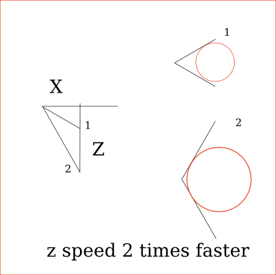

By the way, it's a pity there is no Gcode command to move in a Bezier path. Circular arcs in one of only three planes are very limiting! I use Mach3 and am thinking of adding a macro to implement Beziers.
I notice that in the Engraving Gcode sometimes Z changes faster than sqrt(x**2+y**2) which is impossible for a w conical tool, so something's going wrong.
For instance, I have:
G02 X141.455908 Y203.317488 Z-8.636992 I1.747766 J-0.502778
G02 X143.673153 Y203.355815 Z-24.151282 I1.436369 J-18.941299
At the end of the second line, the Z value implies that the circle at Z=0 has grown by 16mm in radius, yet X has only moved 2mm, so wherever the previous move was touching the path, it will have been totally machined away by the second line. I hope my explanation is clear. Z can never change faster than the XY plane movement.
Regards
Chris

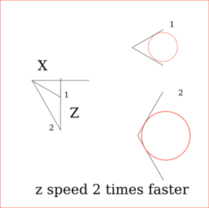

To find small straight lines or points I think it could be faster to get them from to get them form x(t) and y(t) which are calculated for the segment.
How you will find R having only two points?
About Z speed: Z speed mostly relies to angle of the corner, bigger angle causes faster Z speed. For example here two different angles which will give different Z speed:
cnc engraving zspeed.png (11212 просмотров) <a class='original' href='./download/file.php?id=1453&mode=view' target=_blank>Загрузить оригинал (20.29 КБ)</a>
There's a reason why Bezier is not implemented in the machine controllers: it's hard to calculate all it's parameters in realtime. You can calculate lengths of arcs and line using fixed formulas, but length of the bezier curve's segment can be calculated only using numeral methods. In fact EMC2 has suppurt for Bezier curves, but it does the same work as Gcodetools - it approximises it by biarcs and then works with it as usual.
