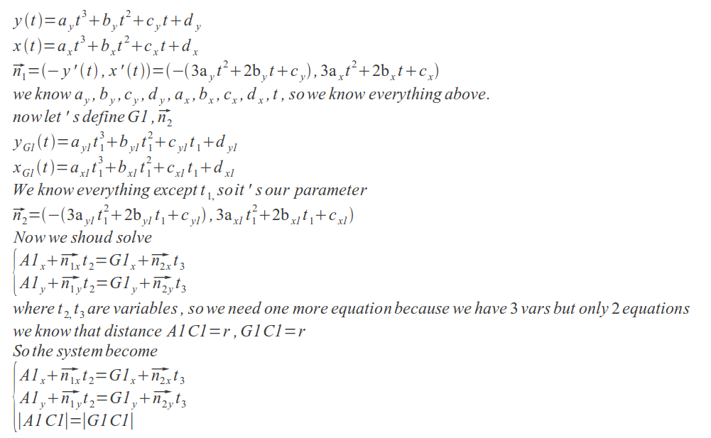

Hello all,
2. It's center lies on the normal to the curve at point G1, we do not know where G point is but know about the normal.
You have all reason Nick it is very difficult to found the G point ( in the woman) Sorry it is joke.
In relation with this :
1,2) C1 = A1 + t1*n1 = G1 + t2*n2 // this gives two equations because all points and normals are defined by two parametric functions x(t) and y(t)
I am a little lost. I am not very clever in maths . I do not know what is t1, or n1
Regards.
Re: Inkscape Gcodetools plug-in English support forum
Yeah, when we've finally found the G spot using Newtons method.... :)
1,2) n1 - is a normal vector at point A1, n2 normal at point G1. So we can define line that goes through A1 and is parallel to n1 as A1+t1*n1 where t1 is a variable. Similar with the second normal G1+t1*n1.
So to find intersection of these lines we have to solve the equation A1+t1*n1 = G1+t2*n2.
here's some nice formatted math:
engraving formulas.png (11667 просмотров) <a class='original' href='./download/file.php?id=1449&mode=view' target=_blank>Загрузить оригинал (85.93 КБ)</a>
oofice formula format (для просмотра содержимого нажмите на ссылку)
y(t) = a_y t^3 + b_y t^2 +c_y t + d_y
newline
x(t) = a_x t^3 + b_x t^2 +c_x t + d_x
newline
widevec {n_1} = (-y'(t),x'(t)) = (-(3a_y t^2 + 2b_y t + c_y), 3a_x t^2 + 2b_x t + c_x)
newline
we know a_y, b_y, c_y, d_y, a_x, b_x, c_x, d_x, t, so we know everything above.
newline
now let's define G1 , widevec {n_2}
newline
y_G1(t) = a_y1 t_1^3 + b_y1 t_1^2 +c_y1 t_1 + d_y1
newline
x_G1(t) = a_x1 t_1^3 + b_x1 t_1^2 +c_x1 t_1 + d_x1
newline
We know everything except t_1, so it's our parameter
newline
widevec {n_2} = (-(3a_y1 t_1^2 + 2b_y1 t_1 + c_y1), 3a_x1 t_1^2 + 2b_x1 t_1 + c_x1)
newline
Now we shoud solve newline
left lbrace stack{
A1_x + widevec{n_1}_x t_2 = G1_x + widevec {n_2}_x t_3
A1_y + widevec{n_1}_y t_2 = G1_y + widevec {n_2}_y t_3
} right none
newline
where t_2, t_3 are variables, so we need one more equation because we have 3 vars but only 2 equations
newline
we know that distance A1 C1 = r, G1 C1 = r
newline
So the system become
newline
left lbrace stack{
lline A1 C1 rline =lline G1 C1 rline
} right none

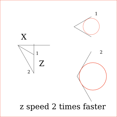

I notice that in the Engraving Gcode sometimes Z changes faster than sqrt(x**2+y**2) which is impossible for a w conical tool, so something's going wrong.
For instance, I have:
G02 X141.455908 Y203.317488 Z-8.636992 I1.747766 J-0.502778
G02 X143.673153 Y203.355815 Z-24.151282 I1.436369 J-18.941299
At the end of the second line, the Z value implies that the circle at Z=0 has grown by 16mm in radius, yet X has only moved 2mm, so wherever the previous move was touching the path, it will have been totally machined away by the second line. I hope my explanation is clear. Z can never change faster than the XY plane movement.
Regards
Chris
To find small straight lines or points I think it could be faster to get them from to get them form x(t) and y(t) which are calculated for the segment.
How you will find R having only two points?
About Z speed: Z speed mostly relies to angle of the corner, bigger angle causes faster Z speed. For example here two different angles which will give different Z speed:
cnc engraving zspeed.png (11649 просмотров) <a class='original' href='./download/file.php?id=1453&mode=view' target=_blank>Загрузить оригинал (20.29 КБ)</a>
There's a reason why Bezier is not implemented in the machine controllers: it's hard to calculate all it's parameters in realtime. You can calculate lengths of arcs and line using fixed formulas, but length of the bezier curve's segment can be calculated only using numeral methods. In fact EMC2 has suppurt for Bezier curves, but it does the same work as Gcodetools - it approximises it by biarcs and then works with it as usual.
