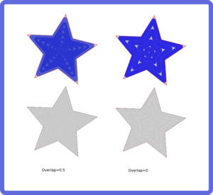

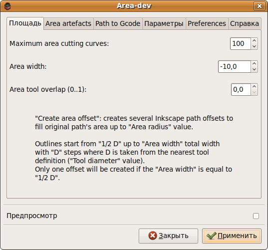

I've been working with the area function, and one thing that would be helpful is a setting for tool overlap (perhaps set in the tool). I've implemented the code in gcodetools.py:
for i in range(self.options.max_area_curves):
# The amount of tool overlap when generating areas
tool_overlap = 0.5
if (i == 0):
radius = - tool_d * (i + 0.5) * sign
else:
radius = - tool_d * ( (i * (1 - tool_overlap)) + 0.5) * sign
if abs(radius)>abs(r):
radius = -r
do you accept patches? I could send you a diff.
Thanks,
Scott
Re: Inkscape Gcodetools plug-in English support forum
Yes that's will be cool! Thank you!
But I think that we should add tool_overlap as a parameter into Area form.
Scott
Сообщение Scott »
Great. Do you want a diff, or can you integrate the tool overlap using the code above?
Thanks,
Scott
I think I can integrate it without diff, just tell me approximate line number.
Scott
Сообщение Scott »
The code would be inserted around line 3785 of the latest release, starting with the following existing line:
Scott
I've made changes to source code. Now there's additional parameter at area pocketing tab - tool overlap. Which works exactly as you have written.
Tool overlap can be assigned from 0 to 0.9. Top border was changed from 1 to 0.9 to avoid infinite loops.
In fact those "if" that you've wrote is not needed. If i==0 then (i * (1 - tool_overlap)) == 0.
So (- tool_d * (i + 0.5) * sign) == (- tool_d * ( (i * (1 - tool_overlap)) + 0.5) * sign).
So I've added only (1 - tool_overlap). And some definitions of the tool's overlapping parameter.
Thanks for the code! :)
