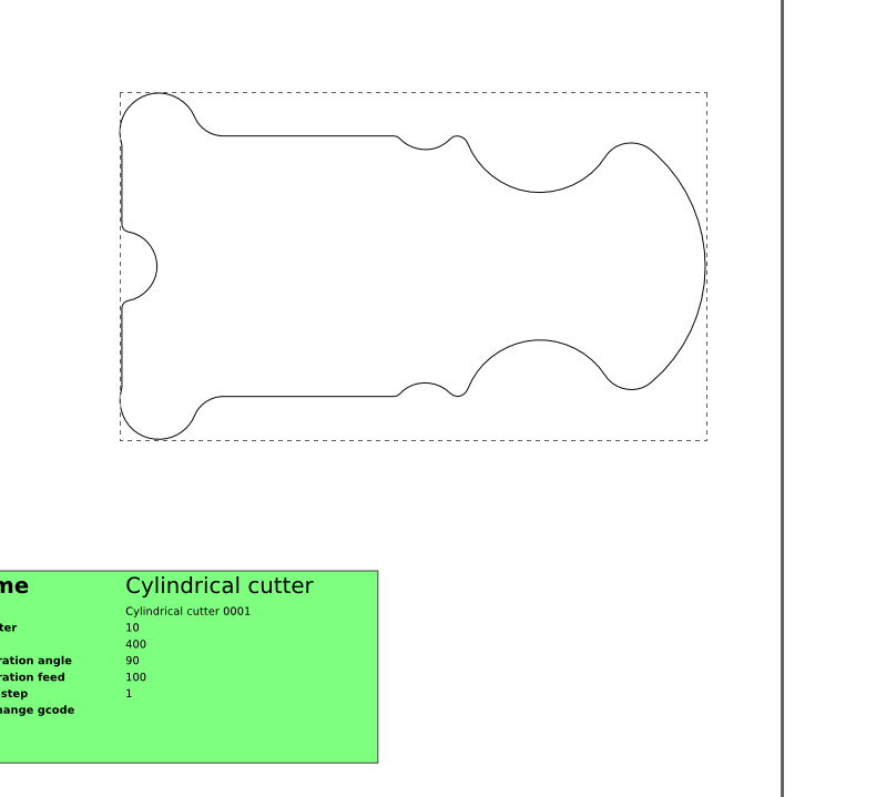

Gcodetools area pocketing (1460853 просмотра) <a class='original' href='./download/file.php?id=772&mode=view' target=_blank>Загрузить оригинал (147.75 КБ)</a>

Gcodetools plug-in tutorial (2600*1300 px png ~ 700Kb) (1474753 просмотра) <a class='original' href='./download/file.php?id=127&mode=view' target=_blank>Загрузить оригинал (752.7 КБ)</a>

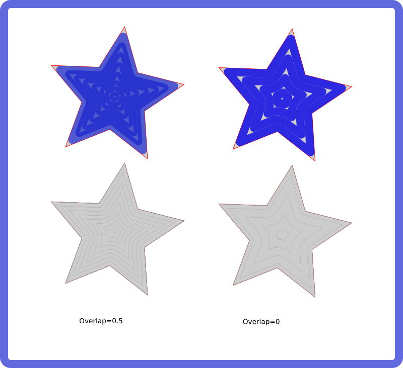

I've been working with the area function, and one thing that would be helpful is a setting for tool overlap (perhaps set in the tool). I've implemented the code in gcodetools.py:
for i in range(self.options.max_area_curves):
# The amount of tool overlap when generating areas
tool_overlap = 0.5
if (i == 0):
radius = - tool_d * (i + 0.5) * sign
else:
radius = - tool_d * ( (i * (1 - tool_overlap)) + 0.5) * sign
if abs(radius)>abs(r):
radius = -r
do you accept patches? I could send you a diff.
Thanks,
Scott

Yes that's will be cool! Thank you!
But I think that we should add tool_overlap as a parameter into Area form.

I've made changes to source code. Now there's additional parameter at area pocketing tab - tool overlap. Which works exactly as you have written.
Tool overlap can be assigned from 0 to 0.9. Top border was changed from 1 to 0.9 to avoid infinite loops.
In fact those "if" that you've wrote is not needed. If i==0 then (i * (1 - tool_overlap)) == 0.
So (- tool_d * (i + 0.5) * sign) == (- tool_d * ( (i * (1 - tool_overlap)) + 0.5) * sign).
So I've added only (1 - tool_overlap). And some definitions of the tool's overlapping parameter.
Thanks for the code! :)
If you want to get latest version you have to get it from bazaar on launchpad.
On ubuntu:
  • install bazaar client: "sudo apt-get install bzr"
  • get the code: "bzr branch lp:gcodetools"
  • create all inxes: "cd gcodetools; python create_inx.py"
  • and copy to your Inkscape's extensions dir.
Here are some screens:
gcode tools area pocketing tool overlap.png (12319 просмотров) <a class='original' href='./download/file.php?id=836&mode=view' target=_blank>Загрузить оригинал (83.18 КБ)</a>
Gcodetools area overlap added into area pocketing tab.png (12319 просмотров) <a class='original' href='./download/file.php?id=837&mode=view' target=_blank>Загрузить оригинал (49.36 КБ)</a>
