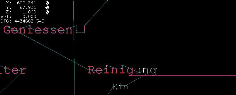

Preview of the generated Gcode in EMC (1453556 просмотров) <a class='original' href='./download/file.php?id=130&mode=view' target=_blank>Загрузить оригинал (154.76 КБ)</a>

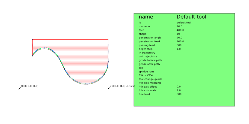

Gcodetools area pocketing (1439659 просмотров) <a class='original' href='./download/file.php?id=772&mode=view' target=_blank>Загрузить оригинал (147.75 КБ)</a>

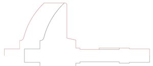

Gcodetools lathe (1445980 просмотров) <a class='original' href='./download/file.php?id=642&mode=view' target=_blank>Загрузить оригинал (21.98 КБ)</a>
Gcodetools lathe

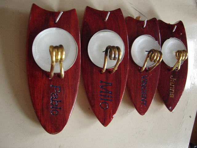

Gcodetools engraving by Rene (1446145 просмотров) <a class='original' href='./download/file.php?id=631&mode=view' target=_blank>Загрузить оригинал (233.84 КБ)</a>

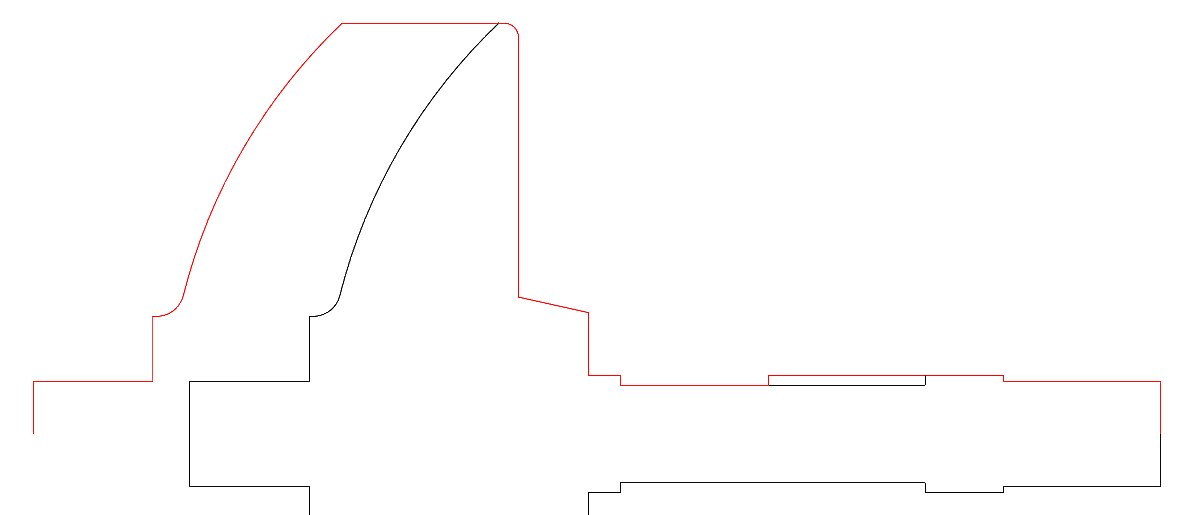

Lathe Gcode
  • Compute trajectories for lathe
  • Fine cut
  • Define fine cut's depth
  • Define fine rounds
  • Two different computation functions for fine cut

Path's area processing
  • Building area paths
  • Area paths could be modified

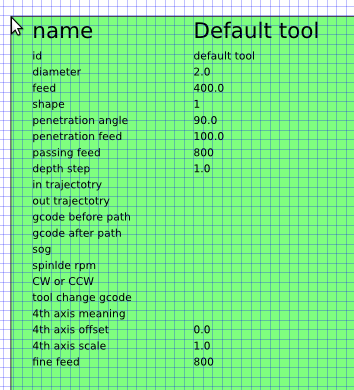

  • Defining different tool's parameters (diameter, feed, depth step, penetration feed, personal Gcode before/after each path, cutters shape, personal tool's changing Gcode)
  • Tools can be managed by Inkscape's standard procedures (copy, delete, assigned to different layer)

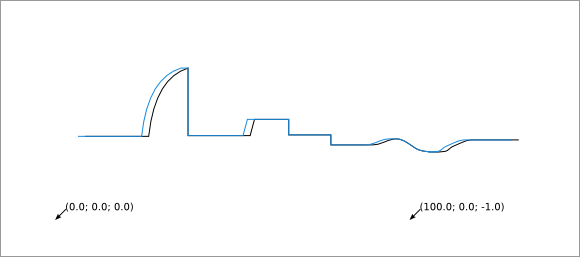

Gcodetools plug-in tutorial (2600*1300 px png ~ 700Kb) (1453559 просмотров) <a class='original' href='./download/file.php?id=127&mode=view' target=_blank>Загрузить оригинал (752.7 КБ)</a>

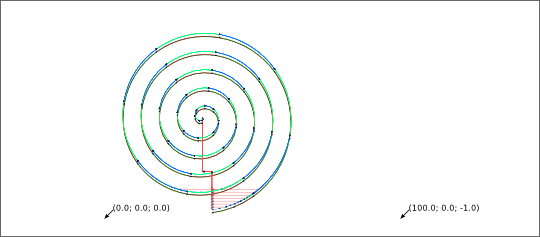

Curve to Gcode result (1453565 просмотров) <a class='original' href='./download/file.php?id=103&mode=view' target=_blank>Загрузить оригинал (1023.52 КБ)</a>

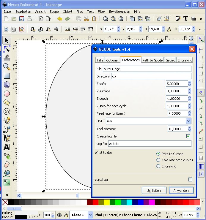

I added the two line of code you suggested to my inkex.py
import gettext
_ = gettext.gettext
But it still doesn't work :(
now I get this error:
  File "/usr/share/inkscape/extensions/gcodetools.py", line 1748, in <module>
    e.affect()
  File "/usr/share/inkscape/extensions/inkex.py", line 156, in affect
    self.effect()
  File "/usr/share/inkscape/extensions/gcodetools.py", line 1725, in effect
    self.get_info()
  File "/usr/share/inkscape/extensions/gcodetools.py", line 992, in get_info
    self.error(_("No paths are selected! Trying to work on all available paths."),"warning")
  File "/usr/share/inkscape/extensions/gcodetools.py", line 934, in error
    inkex.errormsg(s+"\n")
AttributeError: 'module' object has no attribute 'errormsg'
any idea?

To answer to the request for photo's some engraving done with Gcodetools . Thank's for writing it!.
Rene

Hi Rene!
Thank you for the photos!
Could you attach the svg of the "Milo". I think there's an error in the engraving function.
And how have you done those picture at the first photo? It's just awesome! Is it done with the engraving function or not?

Yes nice work !
Could you set better resolution photos...to be able to see the detail of the engraving.. ;)
If you can do some tutorial on how you operate if it have more than say's in the forum...nice too..

>alfcnc,requested bigger photo, it already has some dents and scratches from being in the bottom of a toolbox for a while so i gave it a quick polish. It was actually the first test i did with gcodetools i think a year ago or so and i dont have the slightest idea how i did it (sorry) The design is by a friend of mine who is in to comics and drawing http://www.sadrabbits.com.
>root, the milo.svg the original output and the edited to run (ad a speed S1 else spindle wil not run and changed feed and depth til now im stil a bit lazy in exactly figuring out how to use gcodetools tool well :)
I looking forward to test the new version (if i find some time)
regards Rene

Re: Inkscape Gcodetools plug-in English support forum
Hi Rene!
Unfortunately there's no automatic subdivision inside engraving function. But yo can get better results if you'll do the subdivision yourself.
See the attached image. I've marked bad places with red arrows and good ones with green. You can notice that the more knots you add the better result you'll get. But the calculation time depends at n^2 where n is knots number. So if you increase knots number in two times calculation time will be 4 times longer.
Also it's better to do Path->Break Appart for isolated paths. So they will be calculated separately and calculation time will be m^2+n^2 instead (m+n)^2= m^2 + n^2 + 2*m*n so you'll have 2*m*n calculation time benefit (n,m knots number of separate paths).
Of course all this make sense only for large paths. But keep that in mind ;).
To add more nodes use Extensions->Modify path->Add nodes. You can choose from two Division methods either by seg. length or by segment number.
0094 gcodetools engraving.png (27063 просмотра) <a class='original' href='./download/file.php?id=648&mode=view' target=_blank>Загрузить оригинал (268.82 КБ)</a>

Ah,that is how to solve it ! I'l keep that in mind the next time. I noticed that strange behaviour, but as the result was fine by me i dint look further.
