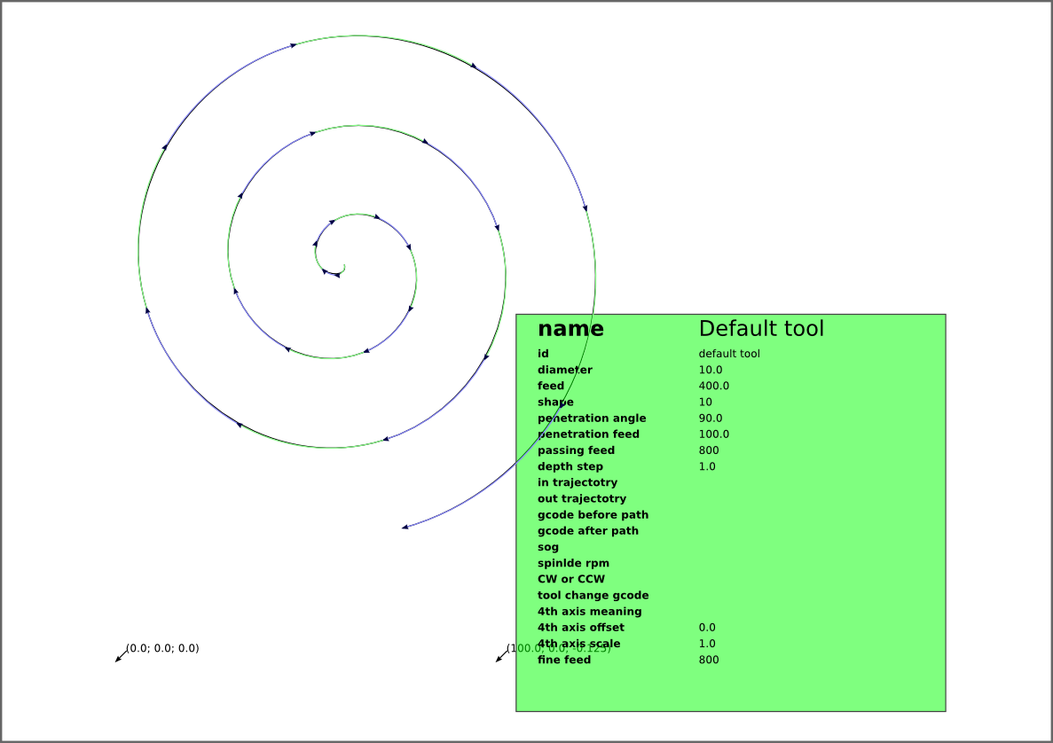

Does it adds any path to the drawing? Like this:

Does it adds any path to the drawing? Like this: "drawing to gcode.png"
No -- have never seen these paths added to the drawing.

Okay, success!
I installed the package libatlas3gf-sse2; now numpy.test() still does not pass ALL tests but can do the determinant.
And, I get a NC file:
