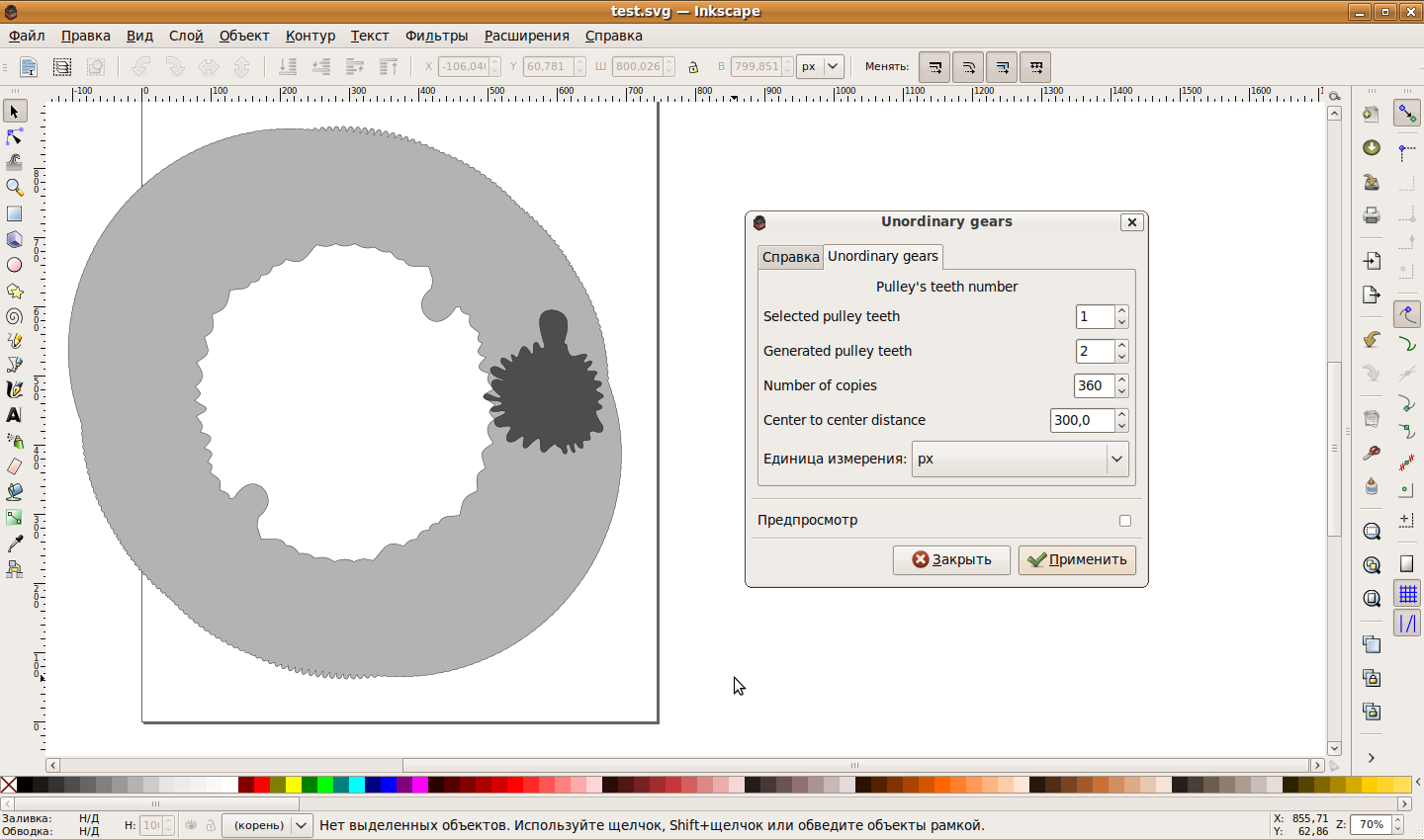

Just installed and check checked live preview
snapshot1.png (26366 просмотров) <a class='original' href='./download/file.php?id=1115&mode=view' target=_blank>Загрузить оригинал (133.16 КБ)</a>
Re: Unordinary gears Inkscape's extension
You should do exactly what it says.
Select only one path :).
I've not tested that Preveiw thing, and added this option to make possible making changes to the drawing while extension's dialog is opened.
So better do not touch it :). Just create arbitrary path that will be used as a first gear, select it and make corresponding gear for your path.
I've got to write a bug report/wish to Inkscape's developers to make able changing the scene without Preview field...
