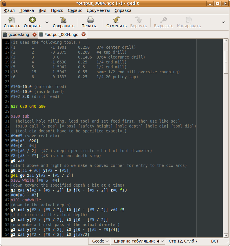

Despite it's simplicity Gedit (it's default "Notepad" for Gnome for Linux) has a lot of useful functions. One of them is syntax highlighting for different programing languages, scripts, htlm, xml, etc. By default Gedit supports about 100 different languages but unfortunately Gcode not in that list. So I've decided to write Gcode syntax highlighting for Gedit.
Here's how it's look like using "Oblivion" color scheme:
0079 gedit gcode hightlight.png (28919 просмотров) <a class='original' href='./download/file.php?id=619&mode=view' target=_blank>Загрузить оригинал (161.19 КБ)</a>

Hi Nick,
I installed the Gedit G-code highlight file, it's much better than I had previously, but still there are some small issues. Especially with the named parameters.
What can be the problem?
Thanks for your support in advance.
James
Re: Highlight Gcode in Gedit
hmmmm... probably it's because "-" not in the variable pattern
line 68. <match>#([0-9]+|<[a-zA-Z_0-9\-]+>)</match>
Fixed version is in the header.

Hi Nick,
Thanks a lot!!
That was very quick.
Now only one item left: comments after semicolon are too colorful yet ;)
As in the screenshot above
James
Do I get it right - everything after semicolon till the end of line is a comment?
Fixed. See updated file in the header.
PS Thanks for the bug report! :)
