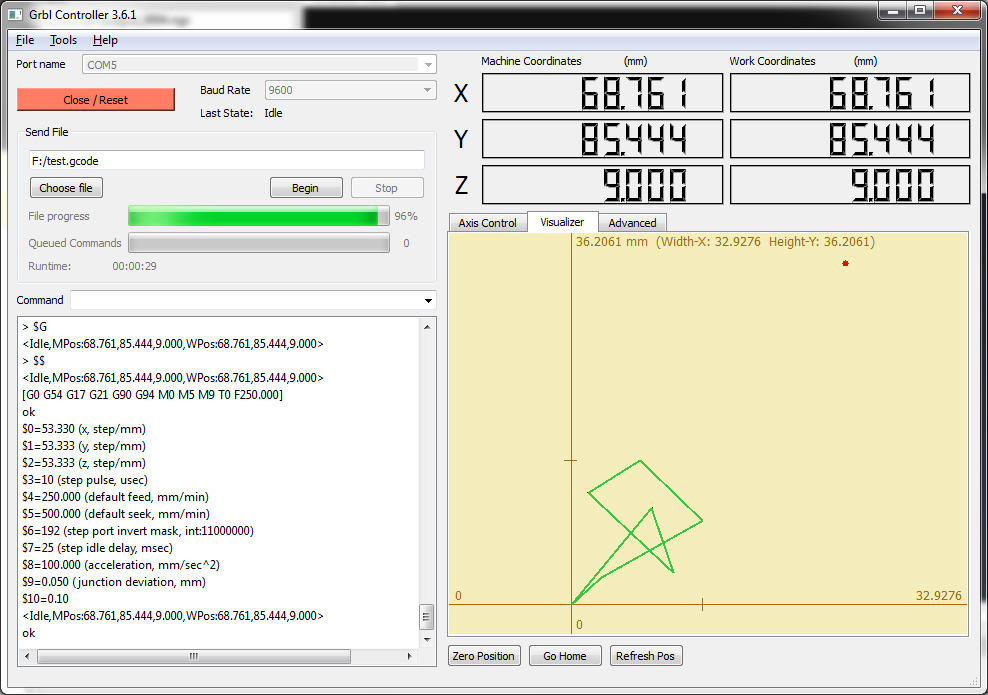

Hi! firstly very new to all of this, made a small CNC plotter from a few DVD roms, Arduino, EasyStepper and Grbl Controller. All seems to be working fine, tested with some example gcode plots.
What I'm finding its any gcode / ngc from Inkscape using this plugin goes outside of the defined area. As you can see by the attached picture, and the red dot in the top right. It starts fine then doesn't stop until it reaches close to 100mm in one direction or another, but ins't following a path in the process? or at least starts and then forgets to the turn the corner before its off over the horizon.
Followed tutorials, guides etc, and a fair few attempts and nothing has made a difference.
Any suggestions! Thanks
error.jpg (19349 просмотров) <a class='original' href='./download/file.php?id=81516&mode=view' target=_blank>Загрузить оригинал (249.47 КБ)</a>
