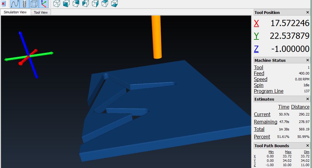

Hi there,
When I set the Z depth in orientation points to 2mm or more the simulation in Openscam looks OK like this:
But when I change Z depth to below 2mm it looks like this and is upside down
Why is that?

Can you attach your svg?
Probably it's because you have two situations: Z from 0 to 2 and Z from 0 to -2 which are mirrored along the 0. That's why you get mirrored cut.
Define both upper limit and bottom limit of machining in orientation points.
By the way it's a good practice to assume 0 to be top point of your material - i.e. everything below 0 is material. And make all machining from 0 to -depth. After having the Gcode you adjust offsets in your Control software (using G92 or other Gcodes).

I've been playing with it for hrs and can't make it work right.
The Openscam simulation shows opposite of what it should be. When tool position shows 10.0000, the tool is inside the material and cuts its own path instead of objects.
When tool position shows -1.00000 then it is above material and just follows the object path in the air.
See attached pictures.
Can you convert my svg file to gcode and run openscam simulation to see whats happening please.
I have used the following settings:
orientation points: 2 point mode, Z surface 0.00000, Z depth -1.00000
gcode tools->path to gcode: options: scale along Z 1.00000, offset along Z 0.00000, minimum arc radius 1.00000
preferences: Z safe height 10.00000 ( all in mm)
Many thanks

Re: Inkscape Gcodetools plug-in English support forum
It's caused by openscam configuration.
By default Z axis points to the top. So Z blow 0 should be material, Z above 0 is air. Check your configuration.

I've been having a hard time getting gcodetools to generate an efficient rectangular pocket operation. I create a rectangle, convert it to a path, then do a zigzag fill area. Select the zigzag, ungroup, break apart, combine, simplify, then run path to gcode. The resulting gcode does this for each segment:
(Start cutting path id: path3605)
(Change tool to Default tool)
G00 Z5.000000
G00 X-5.644444 Y29.431750
G01 Z-1.000000 F100.0(Penetrate)
G01 X4.355556 Y29.431750 Z-1.000000 F400.000000
G00 Z5.000000
(End cutting path id: path3605)
G00 Z5.000000
G00 X4.355556 Y29.431750
G01 X4.355556 Y65.717462 Z-1.000000 F400.000000
G00 Z5.000000
Note the unnecessary Z movements, this is at each corner of the path. Without break apart/combine/simplify steps, it's even worse, it does multiple back-and-forth Z-axis movements on each corner.
When I edit the generated zigzag path, each corner shows "3 nodes" when I select it. If I join those into one, the Z-axis back-and-forth goes away, and the generated gcode follows an efficient horizontal path.
Is this behavior by design? Am I doing something wrong? Other methods of filling the area have similar problems.
vnks
Сообщения: 2
Зарегистрирован: 27 июл 2015, 16:05
Настоящее имя: vnks
Сообщение vnks »
Yup, that's a bug. Here's a patch to fix it (makes zig-zag area fill a single continuous path, and makes spiral fills much more efficient too):
