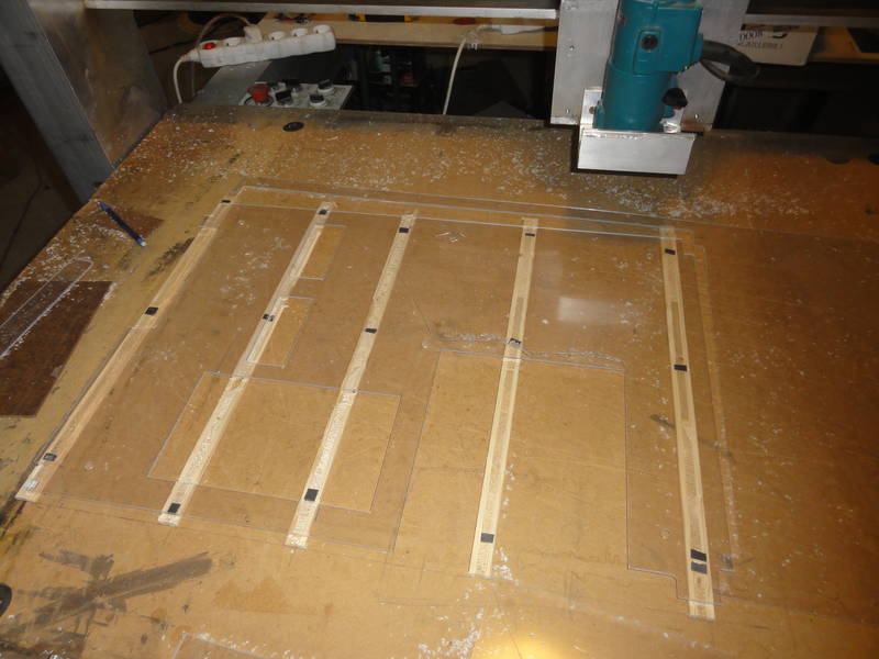

bricofoy
Сообщения: 14
Зарегистрирован: 08 сен 2011, 14:00
Re: Inkscape Gcodetools plug-in English support forum
Сообщение bricofoy »
some details on G41/42 in linuxcnc :
http://www.linuxcnc.org/docs/2.4/html/g ... mpensation
-Hey, know what ? If you read the back of the Windows CD you'll ear a satanic song !
-Ho, there's even worse : read it normally, it will install !
narvf
Сообщения: 60
Зарегистрирован: 22 июл 2014, 11:39
Репутация: 4
Сообщение narvf »
Thank you, but i have no idea how can i use it? Do i have to edit file manually after exporting path to gcode or i can use file in gcodetools "Tool's change Gcode" and type someting there?
bricofoy
Сообщения: 14
I use it by adding it manually to the gcode file. The fact is you need to choose between G41 and G42 depending on the design of your work. If you want to have a look at the attached files, I used it to cut some protective panel for electrical box. You will see here I needed to use only G42. But in some cases you will need both.
What I do to make sure the resulting path is ok is to run the file one time without adding G41/42 in a linuxcnc simulation install, and then I make the changes and I re-run the file without cleaning axis display, so I get the two pathes displayed : the original one wich in fact is the part outline, and the tool conpensated one, so I can check if I use the right command : if the new path is on the wrong side of the part outline, then I need to change between G41 and 42.
plastron.svg
(52.34 КБ) 945 скачиваний
DSC07383.JPG (7045 просмотров) <a class='original' href='./download/file.php?id=32016&mode=view' target=_blank>Загрузить оригинал (74.17 КБ)</a>
DSC07385.JPG (7045 просмотров) <a class='original' href='./download/file.php?id=32017&mode=view' target=_blank>Загрузить оригинал (61.75 КБ)</a>
plastron_0002.ngc
(11.02 КБ) 1198 скачиваний
narvf
Сообщения: 60
Репутация: 4
Сообщение narvf »
Thank you very much! That explains a lot and example file was helpful. But can you show me your linux cnc tool table screenshot? I am getting error about tool compensation and don't know why, i guess i will have to ask on linuxcncs forum... When i will succesfully cut something i will paste photo.
bricofoy
Сообщения: 14
what is the error you got ? I can't send you my tool table right now because the cnc computer is at my workplace. but it was nothing special, only a 6mm cylindrical endmill.
narvf
Сообщения: 60
Репутация: 4
Сообщение narvf »
I think it was ""Length of cutter compensation entry move is not greater than the tool radius" I am not sure if it has something to do with table tool even.
My table - i use 6mm drill
Error:
Sample file from inkscape:
https://dl.dropboxusercontent.com/u/396 ... t_0001.ngc
SVG file:
https://dl.dropboxusercontent.com/u/3960024/test.svg
How do you set size of orientation points? I have always 100 - do i have to change this manually?
bricofoy
Сообщения: 14
no, this has nothing to do with the tool table. in fact gcodetools generates a tool path wich starts and ends at the exact same place, right on the part edge. but for G41/G42 to work, you need an entry move that starts away of that part edge, and that is longer than the tool radius. You can check on my ngc file, and with my svg file : try generating the ngc file, and compare with mine to see how and where I added manually some moves.
some good explanations here : http://www.linuxcnc.org/docs/2.4/html/g ... Entry-Move
