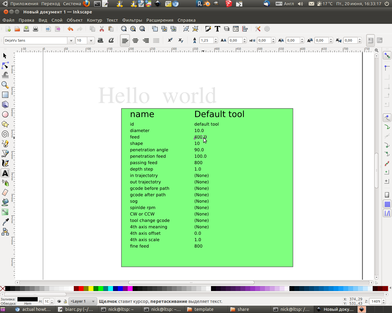

BUT where do i define my tool? Think I need at least a diameter?
can't see the videos now but i'll try this evening..
Re: actual howto?
tecdroid писал(а):where do i define my tool? Think I need at least a diameter?
After you apply Path To Gcode, a default tool will be added you can copy/modify it afterwards.
In fact diameter does not interfere Path to gcode it's only needed for pocketing operations...

Nick писал(а):After you apply Path To Gcode, a default tool will be added you can copy/modify it afterwards.
where and how do i ?
Re: actual howto?
If you will do what I have written, you will get something like this:
You can Edit parameters using Text tool (F8).
Снимок-38.png (17874 просмотра) <a class='original' href='./download/file.php?id=29797&sid=2edacc13769df5599095147efe96e7d2&mode=view' target=_blank>Загрузить оригинал (197.8 КБ)</a>

but I'm still a bit confused by tool diameter.
let's say, I have a circle of 10mm diameter and my tool is 1.2mm in diameter. Without changing this in G-Code, I'd get a 8.8mm circle instead of 10mm ? with a 3mm-Tool it would be 7mm.. ?
Re: actual howto?
yep...
there are several ways:
1. make offset of the path in inkscape
2. use tool diameter compensation inside your Machine Controlling Software.

You can offset the path using inkscape Offset.
Path - Dynamic offset. And move contorl point or edit xml (Ctrl+Shift+X - and threre edit offset radius (it is in pixels)).
tecdroid писал(а):my control software doesn't know what's inside and outside my object..
There are to Gcodes - 41 and 42, one makes offset to the right, another to the left.
http://linuxcnc.org/docs/html/gcode/gco ... ec:G41-G42
In inkscape paths are usually oriented in the way that internal side of the path is always to the right of the path... But it can be changed by Path-Reverse, so it is better to be checked twice.
