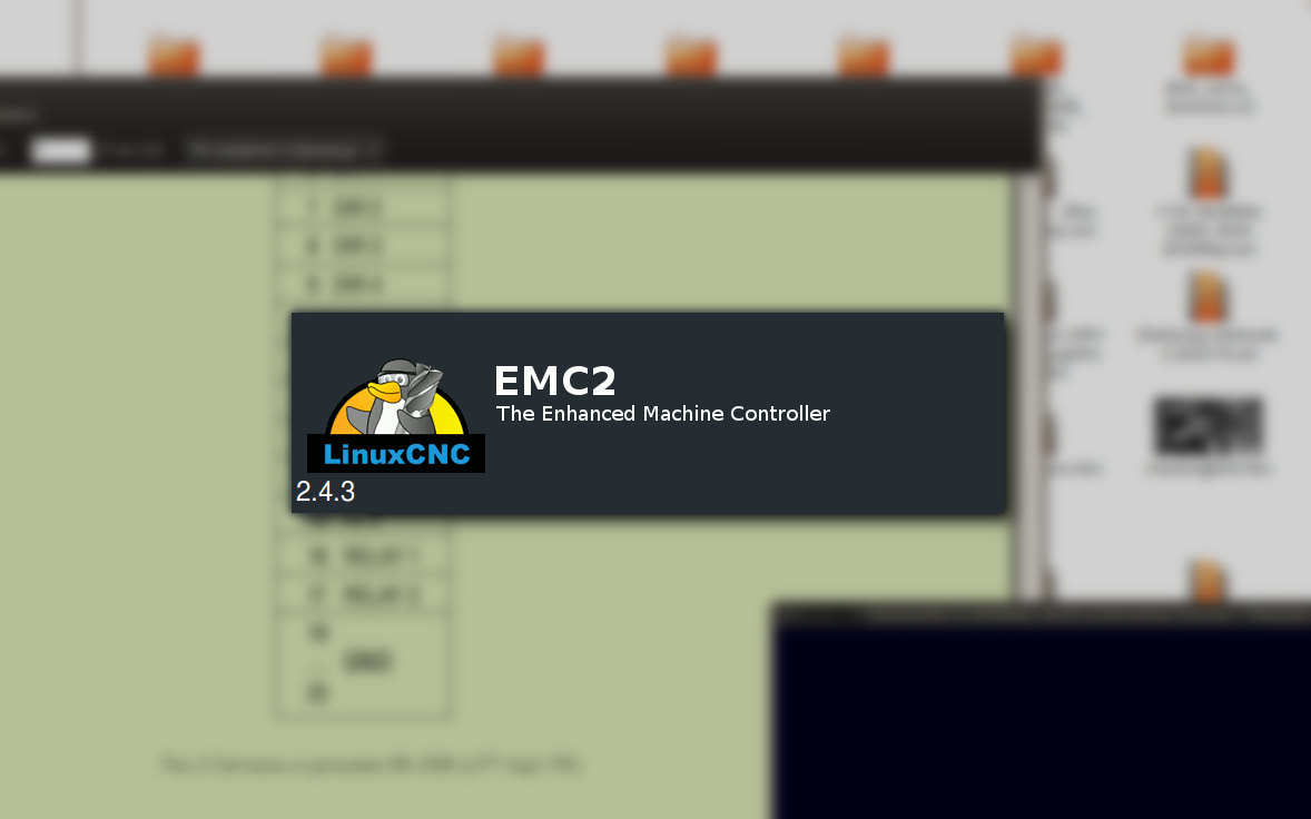

Great news every one! Installing EMC2 on Ubuntu become easy as 123.
I'm pleased to announce that we've made it easier to try emc2 on Ubuntu
10.04: just download and run a shell script, which will download all the
packages necessary for emc2. This requires a working network
connection, and depending on the speed of your connection will take
several minutes to complete.
Instructions are here:
http://wiki.linuxcnc.org/cgi-bin/emcinf ... ckageNotes
Jeff
So all you have to do is to run the following script: (You can save this commands to "install_emc.sh" and then run "sh install_emc.sh".)
#!/bin/sh
gksudo -m "Enter your password to install EMC2" true
gpg --keyserver pgpkeys.mit.edu --recv-key 8F374FEF
gpg -a --export 8F374FEF | sudo apt-key add -
sudo sh -c 'cat > /etc/apt/sources.list.d/linuxcnc.list' <<EOF
deb http://www.linuxcnc.org/emc2 lucid base emc2.4
deb-src http://www.linuxcnc.org/emc2 lucid base emc2.4
EOF
sudo apt-get update
sudo apt-get -o Apt::Install-Recommends=true install emc2
What does it do:
First it asks for the password. Then add a public key to apt. Then it adds EMC repository to apt sources list. And finally installs it.
After installation finished you'll have to restart your system and chose realtime core to run EMC2.
I've tested it on two computers one desktop and one netbook both of them work fine.

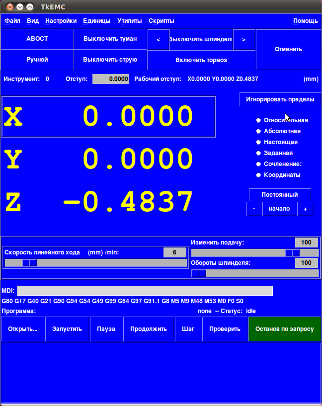

hmmmm... most people noticed that ubuntu 10.04 works faster than 8.xx.
But anyway there are some ways to speed up the system:
1. Turn off graphics effects.
2. For EMC2 Use other GUI than Axis for example TKemc.
3. More radical: use another window manager XFCE or open box.
PS using TkEMC solved my problem with ati video drivers.
Screenshot of TkEMC2:
0081 emc2 radeon problem.png (213630 просмотров) <a class='original' href='./download/file.php?id=699&mode=view' target=_blank>Загрузить оригинал (56.17 КБ)</a>
