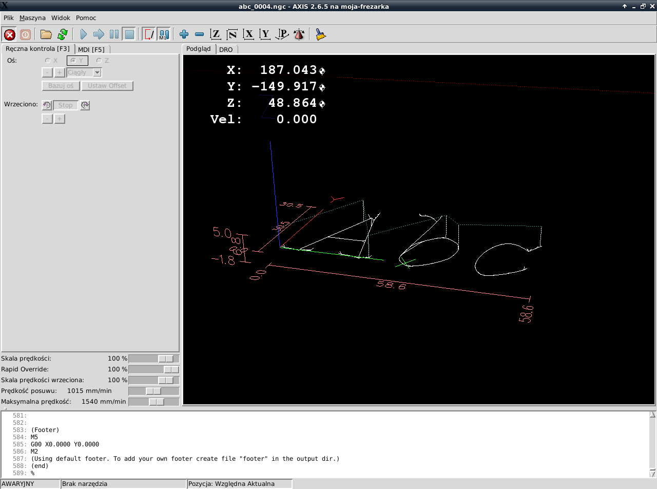

How to specify shape of my tool for engraving? It doesn't matter what i will type in "shape" option of default tool - i will always get warning about no shape for tool and 45o is used by default.
And diameter, how is this related? I have 0.1mm and 45o tool. I would like engrave something on laser laminate (don't know exactly how to name this in english) and it is 1.6mm thin. So i think i need more wide tool like 60o. But where to type it?
Could someone explain this function better? Why sometimes i get engraving "inside" a letter which is great, and sometimes around letter - which also looks very good. But i would like to decide which i want to use. How to determine max depth - is it possible or it's always calculated by tool settings and width of paths?
I've added example files to show what i was doing.

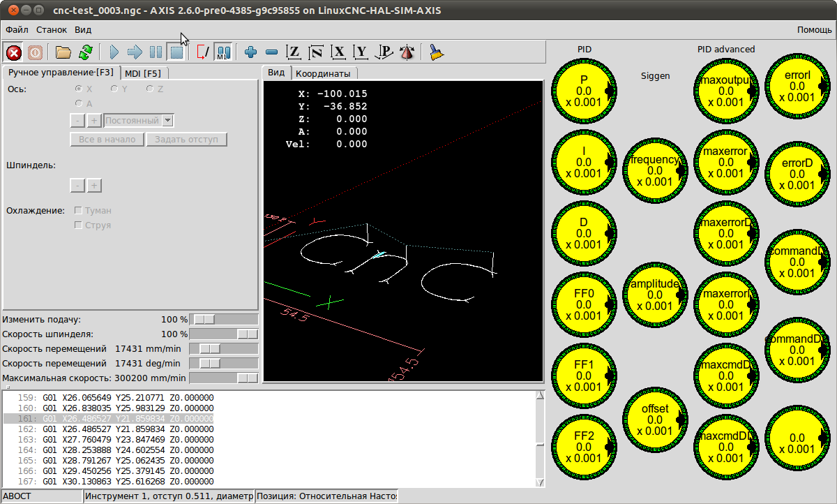

Well, i think somehitng is not correct.
When i type: w*math.tan(60/180*3.1415) for example the g code is generated. I get message about commeny in comment in linux cnc, but i deleted this line manually. When opened gcode in linuxcnc z depth is 0, not below 0, for w*math.tan(60/180*3.1415) also the same and for 45 also.

Attached files.
In ngc file i had to delete 9'th line to load this into openscam or linuxcnc.

Re: Engraving
And what do you think is wrong with the Gcode?
By the way, math.tan(60/180*3.1415) = 1.7319272760572555 = sqrt(3)
hmmm... python thinks that math.tan(60/180*3.1415) = 0 (because 60/180=0 (they both integers)), try to use math.tan(60./180.*3.1415)

Re: Engraving
Z is alywas 0 so it will not go into the material.
Maybe I don't understand something :/

Re: Engraving
Ok. The problem is in the "shape"'.
As I've written - in python 60/180 =0 but 60./180=0.3333
because 60 is integer and it suppose the result will be integer and int(0.333) = 0.
So you can ether write w*math.tan(60./180.*3.1415) or just compute tangent of the cutters angle yourself and just write w*1.7(...)

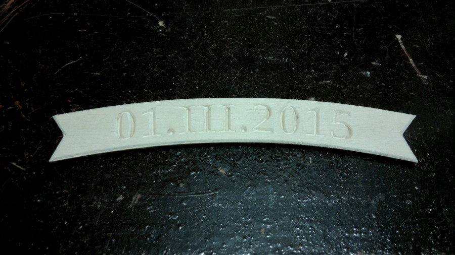

As soon as i will engrave something good i will let post here
