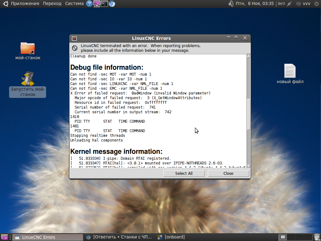

ЕМС загрузил, создал конфигурацию по умолчанию, запускаю - пишет это :( :
Снимок.png (3016 просмотров) <a class='original' href='./download/file.php?id=20671&mode=view' target=_blank>Загрузить оригинал (534.94 КБ)</a>
Print file information:
RUN_IN_PLACE=no
LINUXCNC_DIR=
LINUXCNC_BIN_DIR=/usr/bin
LINUXCNC_TCL_DIR=/usr/lib/tcltk/linuxcnc
LINUXCNC_SCRIPT_DIR=
LINUXCNC_RTLIB_DIR=/usr/realtime-2.6.32-122-rtai/modules/linuxcnc
LINUXCNC_CONFIG_DIR=
LINUXCNC_LANG_DIR=/usr/share/linuxcnc/tcl/msgs
INIVAR=inivar
HALCMD=halcmd
LINUXCNC_EMCSH=/usr/bin/wish8.5
LINUXCNC - 2.5.3-59-gb5c9d06
Machine configuration directory is '/home/vvv/linuxcnc/configs/мой-станок'
Machine configuration file is 'мой-станок.ini'
INIFILE=/home/vvv/linuxcnc/configs/мой-станок/мой-станок.ini
PARAMETER_FILE=linuxcnc.var
TASK=milltask
HALUI=
DISPLAY=axis
Starting LinuxCNC...
Starting LinuxCNC server program: linuxcncsvr
Loading Real Time OS, RTAPI, and HAL_LIB modules
Starting LinuxCNC IO program: io
Starting TASK program: milltask
Starting DISPLAY program: axis
Shutting down and cleaning up LinuxCNC...
Killing task linuxcncsvr, PID=2366
Killing task milltask, PID=2419
Removing HAL_LIB, RTAPI, and Real Time OS modules
Removing NML shared memory segments
Cleanup done
Debug file information:
Can not find -sec MOT -var MOT -num 1
Can not find -sec IO -var IO -num 1
Can not find -sec LINUXCNC -var NML_FILE -num 1
Can not find -sec EMC -var NML_FILE -num 1
  File "/usr/bin/axis", line 2985, in <module>
    o = MyOpengl(widgets.preview_frame, width=400, height=300, double=1, depth=1)
  File "/usr/bin/axis", line 351, in __init__
    Opengl.__init__(self, *args, **kw)
  File "/usr/lib/pymodules/python2.6/rs274/OpenGLTk.py", line 164, in __init__
    apply(RawOpengl.__init__, (self, master, cnf), kw)
  File "/usr/lib/pymodules/python2.6/rs274/OpenGLTk.py", line 112, in __init__
    Togl.__init__(self, master, cnf, **kw)
  File "/usr/lib/pymodules/python2.6/rs274/OpenGLTk.py", line 38, in __init__
    Widget.__init__(self, master, 'togl', cnf, kw)
  File "/usr/lib/python2.6/lib-tk/Tkinter.py", line 1935, in __init__
    (widgetName, self._w) + extra + self._options(cnf))
_tkinter.TclError: Togl: X server has no OpenGL GLX extension
2366
  PID TTY      STAT   TIME COMMAND
2419
Stopping realtime threads
Unloading hal components
Kernel message information:
[ 1781.115770] I-pipe: Domain RTAI registered.
[ 1781.115780] RTAI[hal]: <3.8.1> mounted over IPIPE-NOTHREADS 2.6-03.
[ 1781.115783] RTAI[hal]: compiled with gcc version 4.4.3 (Ubuntu 4.4.3-4ubuntu5) .
[ 1781.115848] RTAI[hal]: mounted (IPIPE-NOTHREADS, IMMEDIATE (INTERNAL IRQs DISPATCHED), ISOL_CPUS_MASK: 0).
[ 1781.115853] PIPELINE layers:
[ 1781.115857] ff44ce20 9ac15d93 RTAI 200
[ 1781.115860] c085cb20 0 Linux 100
[ 1781.148608] RTAI[malloc]: global heap size = 2097152 bytes, <BSD>.
[ 1781.153041] RTAI[sched]: IMMEDIATE, MP, USER/KERNEL SPACE: <with RTAI OWN KTASKs>, kstacks pool size = 524288 bytes.
[ 1781.153049] RTAI[sched]: hard timer type/freq = APIC/12498508(Hz); default timing: periodic; linear timed lists.
[ 1781.153054] RTAI[sched]: Linux timer freq = 250 (Hz), TimeBase freq = 3199404000 hz.
[ 1781.153057] RTAI[sched]: timer setup = 999 ns, resched latency = 2943 ns.
[ 1781.153186] RTAI[usi]: enabled.
[ 1781.230368] RTAI[math]: loaded.
[ 1781.321325] config string '0x378 out  '
[ 1783.020807] RTAI[math]: unloaded.
[ 1783.082672] SCHED releases registered named ALIEN RTGLBH
[ 1783.112368] RTAI[malloc]: unloaded.
[ 1783.212037] RTAI[sched]: unloaded (forced hard/soft/hard transitions: traps 0, syscalls 0).
[ 1783.216174] I-pipe: Domain RTAI unregistered.
[ 1783.216257] RTAI[hal]: unmounted.
как с этим бороться?
Дорогу осилит идущий!
Тима
Сообщения: 3073
Репутация: 1089
Настоящее имя: Тимур
Откуда: КБР
Re: Установка LinuxCNC EMC2
Сообщение Тима »
у меня дежавю, я это уже проходил...
nkp писал(а):А ты мини запускал?
Тима писал(а):В мини загрузилось,
nkp писал(а):Емс работает .С Axis проблемы.
nkp писал(а):Попробуй Tkemc также запустить
Тима писал(а):Пробовал! Тоже запускается!
nkp писал(а):В консоли напиши python и посмотри какая версия питона стоит
Тима писал(а):python 2.6.5
Вот только не помню, как я его заставил работать... :pssdoff:
Тима писал(а):Вот только не помню, как я его заставил работать... :pssdoff:
это к вопросу о пользе писать в форум, как в конечном итоге победил проблему :tongue:
Поставил пакет libgl1-mesa-glx и/или драйвер для своей видеокарты.
Ну вот, все интересное пропустил :)
Вы что совсем не спите?
ЗЫ сейчас проблема с графикой, варианты решения написал UAVpilot.
Тима
Сообщения: 3073
Репутация: 1089
Откуда: КБР
Сообщение Тима »
Я на этом компе все внутренности поменял, материнка пень 4, проц 3.2гГц , оперативка 1.5Гб. Правда видеокарта древняя, другой, подходящей по разъему небыло. Пришлось эту воткнуть.
После обновления системы и перезагрузки он выкинул сообщение, что там что-то не то с дровами видеокарты и список чего сделать. Я сейчас не помню, что выбрал, но операционка загрузилась.
UAVpilot писал(а):пакет libgl1-mesa-glx
А как его установить?
Тима писал(а):А как его установить?
sudo apt-get install libgl1-mesa-glx
но скорее всего надо просто установить драйвер видеокарты.

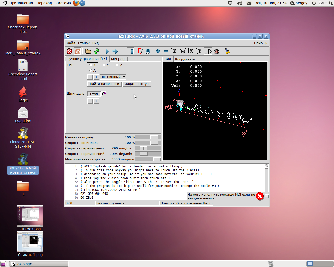

Calambuuur
Сообщения: 122
Зарегистрирован: 18 май 2012, 23:38
Откуда: Я родом из детства : "Кто на Харькив"
Сообщение Calambuuur »
Снимок-2.png (2885 просмотров) <a class='original' href='./download/file.php?id=20811&mode=view' target=_blank>Загрузить оригинал (483.16 КБ)</a>
nkp писал(а):это есть в стандартной сборке
Вложение Выделение(033).jpg больше недоступно
Я не понял? У меня другая кнопка. Только для каждой оси
Один ум хорошо а два и более лучше. "Я так мысленно думаю" и моя "Домососедка", которая пользуется "обезбеливателем" - и радуется, "пусть c cnc, чем без обезбеливателя".(Каламбууур).
