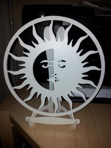

Hello Nick,
Here, attached an example with the svg file and the NGC file. You will see that the width of the tool at a deep of 1mm is 2mm, but the width of the letter is less than 1,5 mm so when I try this it seems bad result. I tried an another Shape like This R-math.sqrt(max(0,R**2,w**2)). It seems better but it's not very clean. So I pray for help. I have attached to a phhoto of one of my try with Gcode tools.

Сообщения: 22776
Re: Engraving
Hi!
Sorry for late answer!
migoupil писал(а): R-math.sqrt(max(0,R**2,w**2))
Yes this sounds better :)
migoupil писал(а): It seems better but it's not very clean.
Can you attach the image that shows that non clean result?
PS there's a nice sun you've cut!
