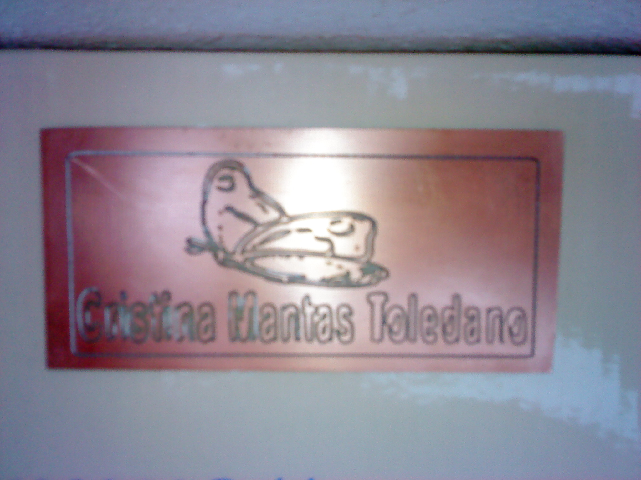

I did paths to code . The final work it is not very good because my machine have many backslash I will put a picture.
Regards.

Hier is the picture.
Regards.
Placa Cristina Picture (22966 просмотров) <a class='original' href='./download/file.php?id=1467&sid=76ac2725684bc8cf6e55ea2be1ca36d8&mode=view' target=_blank>Загрузить оригинал (565.17 КБ)</a>
Re: tool error
In the ini file you can define backlash for each axis.
In the sections [AXIS_x] set BACKLASH = value.
And even more in EMC2 you can set different backlash for different positions of the current axis using backlash compensation file...
According to the photo it seems that your machine lacks hardness. Probably if you set less depth per pass you can get better results. Letters look nasty :(.

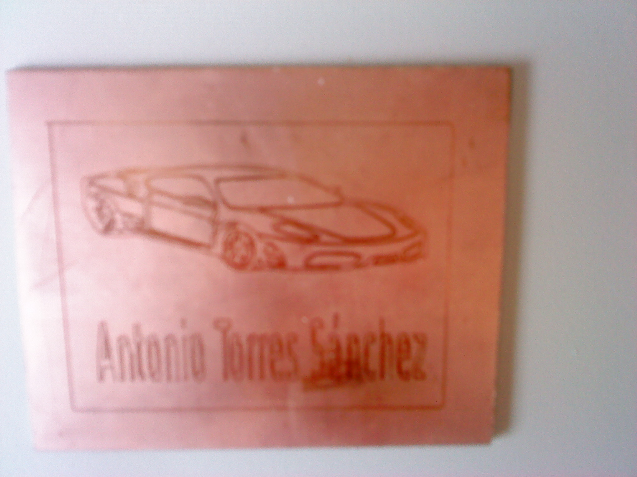

In reference to the letters I tried with 0,1 mm depth but the problems is that the z axis when go down and up with the vibrations lost the position. I did another work with a cylindrical used mill 0.8 mm. The letters are a little bit better but the mill engrave without depth.
What can I do in the letters to achieve a bigger inside ?
Regards.
wit a used cylindrical mill (22872 просмотра) <a class='original' href='./download/file.php?id=1471&sid=76ac2725684bc8cf6e55ea2be1ca36d8&mode=view' target=_blank>Загрузить оригинал (555.01 КБ)</a>
Re: tool error
Just add a string to AXIS_2 section:
BACKLASH = 1.1
1.1 - example value.
To get letters thicker you can try to cut them twice, or cut their area using Area function to create paths and Path to gcode to convert them to Gcode.
