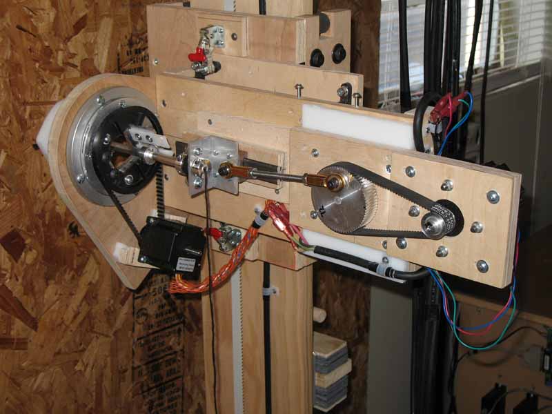

I have put together a computer and a couple of drivers and it looks like "motion.current-vel" will work. I did a basic stepconf and added axis 6 to control the needle as a linear axis. Right now I just have 2 motors on the table top with the "needle" motor triggering a counter so that I can confirm the stitch count as I ran some tests. Running around a square pattern and a straight diagonal line it seems to work well with the number of stitches and the travel time being what I wanted. I had to change the MAX_LIMIT and MIN_FERROR TO 999999.0 to avoid following errors but it seems to work good. Next up is to purchase more parts and build the machine, I will update you that when there is something more to tell.
Thanks for your help Nick, I may be able to pull this off.

The machine is nearing completion, hopefully. I tried "motion.current-vel" to sync the needle motor with the movement of the gantry and it worked well, mostly. It caused the needle to move with changes in the Z axis and also rotation of the A axis since I am using Tangent Knife tool to keep the needle pointing in the correct direction. I switched to using "hypot" to just use the X/Y axis velocities and it works even better.
I have two enhancements that I need help with. When using "tangent knife" it generates "A axis" moves in the same line as XYZ in G02 and G03 lines, which is excellent but then follows up with a G01 line for just an A axis move. Most of the time this is virtually the same as the ending position of "A" anyway but causes XY motion to stop for the "A" move. It works fine but slows the machine down. When I manually edit out most of the "A" only G01 lines the machine works fine. The question is, is there a way to post-edit or prevent G01 lines for "A" only moves if they are within a certain range, like 5 degrees? There are some cases, such as sharp 90 degree tuns where having a separate G01 A axis line is critical so I can't just use a simple REGEX to edit them all out. Leaving them out with "smooth" nodes but including them with "corner" nodes may work if that is an option.
My other problem is more of a LinuxCNC issue that mainly applies to Tangent Knife use. LinuxCNC seems to treat all units the same when calculating feed rates, such as 100 degrees is treated the same as 100mm or 100 inches. I am running my machine at F960, using mm, which is quick enough and gives my 240 stitches per minute which is fine. But this also means that the A axis is only moving at 960 degrees per minute which is really slow. It slows the X/Y movement down in tight turns which works but is just slow. One idea I have is to use REGEX to add F960 to every G02, G03 XYZA line and then add F21600 to all of the G01 lines which are just "A" moves. If there is some other option I am open for suggestions.
Thanks, Badger

Progress is being made. "atan2" works as it should to create automatic tangent knife function. It causes "ferror" but I just adjusted the settings in the ini. file to unrealistic high numbers and it works fine in simulation. The new issues is that both the "atan2" component and the "hypot" component need pin "axis.0.joint-vel-cmd" to work. In the attached hal file if I comment out the key parts of axis.3 which rotates the needle with atan2, axis.6 works fine to control the needle movement. The opposite works fine also where I comment out axis.6 then atan2 works, but I can't use them at the same time. The goal is to generate regular gcode for the path and then have linuxcnc automatically control both the rotation of the needle and the stitches at the same time. Attached should be the hal and ini files along with a photo of mechanism. Is there a way to attach one pin "axis.0.joint-vel-cmd" to two different components? My terminology may not be quite correct. :thinking:

Day 3, charts, graphs and arrows, trial and error, it works. :D
net xjoint <= axis.0.joint-vel-cmd
net yjoint <= axis.1.joint-vel-cmd
net xjoint => atan2.0.x
net yjoint => atan2.0.y
net xjoint hypot.0.in0
net yjoint hypot.0.in1
Now both atan2 automatically controls rotation of needle to follow path, and hypot automatically control the needle to match the velocity of movement. LINUXCNC and cnc-club.ru rock!!!!
Many thanks to Nick. Now to make some tweaks to the machine and I will post progress.

Remove A axis? I need to be able to point needle in dirrection of travel for the yarn to feed correctly. Is the A axis not needed to drive the stepper to do rotation? (in photo the motor on the left drives the large black pulley to rotate the needle.)
Originally when I used motion-current-vel to control axis.6 to move the needle in coordination with the movement and it worked fine for the X/Y movement. I was also using tangent-knife in gcodetools to rotate the needle and motion-current-vel would also register the A axis movement (with no forward movement) the same as forward movement and move the needle leading to irregular stitch length.
If atan2 can rotate the needle without it being "A axis" then motion-current-vel may work just as well.
