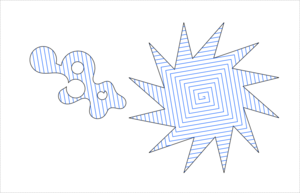

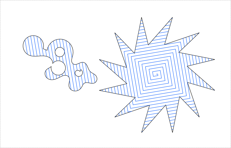

Hi there!
I've found a time to do some codding.
So there are first results for the area filling:
On the screen shot there are examples of zig-zag and spiral trajectories for different specified angles:
area fill.png (24996 просмотров) <a class='original' href='./download/file.php?id=1005&sid=29793778a0389ebe83707155bf66eb0e&mode=view' target=_blank>Загрузить оригинал (98.94 КБ)</a>
It's only the development version, and it shows possible further improvements of the gcodetools. You can get this version from the bazaar...

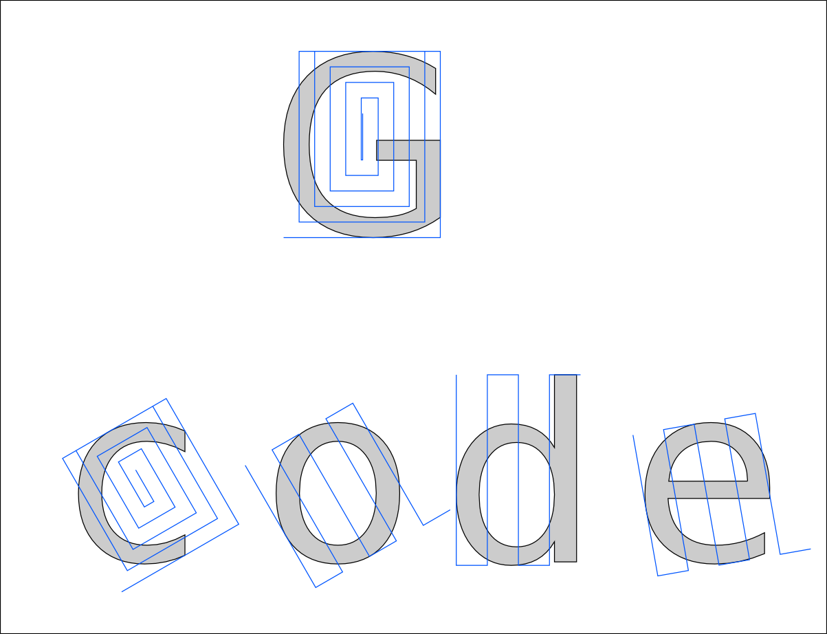

Re: Possible skeinforge integration for the area tool?
Here are some new results...
So clipping was done since the last revision.
The only thing is up to do is to join all the lines together.
area filling test spiral.svg.png (24991 просмотр) <a class='original' href='./download/file.php?id=1008&sid=29793778a0389ebe83707155bf66eb0e&mode=view' target=_blank>Загрузить оригинал (87.23 КБ)</a>
