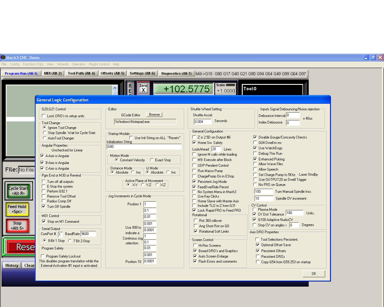

here are the settings that seem to help you with rounded squares...
mach3.png (17383 просмотра) <a class='original' href='./download/file.php?id=68672&mode=view' target=_blank>Загрузить оригинал (31.84 КБ)</a>

First, why are you using XP?
Second, where are those General Logic Configuration dialogs?

When I purchased the 3040 Chinese CNC mill, I had 3 choices of operating systems to run the machine, XP, WIN 7, and win 2000. I like the XP operating system so that's what I chose.
To be honest I have never seen a dialog box like that. :oops:
I did find it though, nothing is adjusted from factory settings.
I found the issue with the Squares. My error, my squares were not squares, I had hit a node tab and altered it. After redrawing the square the issue was resolved.
general logic configuration.JPG (17328 просмотров) <a class='original' href='./download/file.php?id=70283&mode=view' target=_blank>Загрузить оригинал (194.59 КБ)</a>
