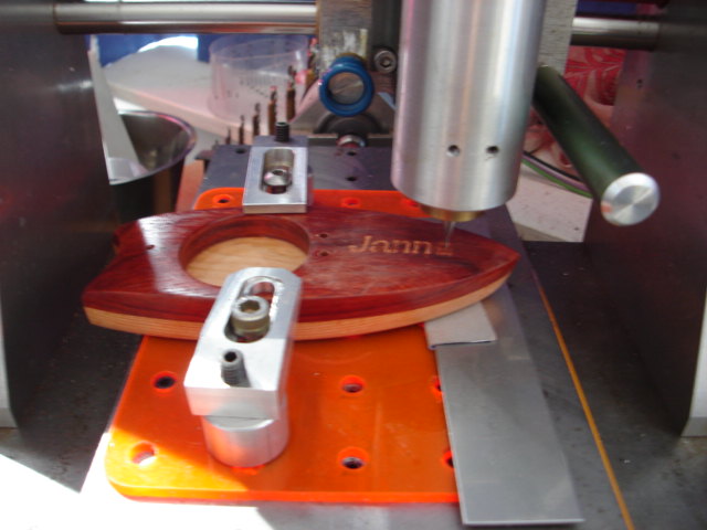

Gcodetools engraving by Rene (1423498 просмотров) <a class='original' href='./download/file.php?id=631&mode=view' target=_blank>Загрузить оригинал (233.84 КБ)</a>

rene
To answer to the request for photo's some engraving done with Gcodetools . Thank's for writing it!.
Rene
DSC06921.JPG (25866 просмотров) <a class='original' href='./download/file.php?id=610&mode=view' target=_blank>Загрузить оригинал (55.2 КБ)</a>
DSC06931.JPG (25866 просмотров) <a class='original' href='./download/file.php?id=611&mode=view' target=_blank>Загрузить оригинал (57.44 КБ)</a>
DSC06939.JPG (25866 просмотров) <a class='original' href='./download/file.php?id=612&mode=view' target=_blank>Загрузить оригинал (57.67 КБ)</a>

Hi Rene!
Thank you for the photos!
Could you attach the svg of the "Milo". I think there's an error in the engraving function.
And how have you done those picture at the first photo? It's just awesome! Is it done with the engraving function or not?

alfcnc
Yes nice work !
Could you set better resolution photos...to be able to see the detail of the engraving.. ;)
If you can do some tutorial on how you operate if it have more than say's in the forum...nice too..

rene
>alfcnc,requested bigger photo, it already has some dents and scratches from being in the bottom of a toolbox for a while so i gave it a quick polish. It was actually the first test i did with gcodetools i think a year ago or so and i dont have the slightest idea how i did it (sorry) The design is by a friend of mine who is in to comics and drawing http://www.sadrabbits.com.
>root, the milo.svg the original output and the edited to run (ad a speed S1 else spindle wil not run and changed feed and depth til now im stil a bit lazy in exactly figuring out how to use gcodetools tool well :)
I looking forward to test the new version (if i find some time)
regards Rene
