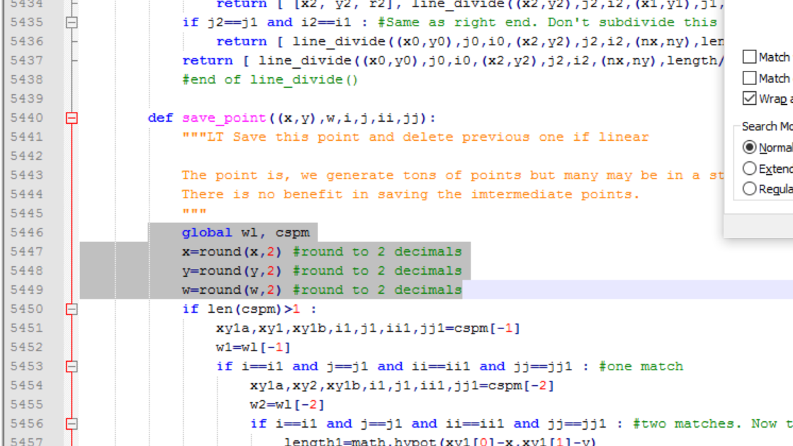

I am playing around with inkscape, your gcodetools plugin and a mill to cut 2D profiles into wood.
When I processed filigrane structures I found that the total milling time for areas is often dramatically increased by the raise and pierce in process after every cnc - path. In commercially available products it is possible to fill areas with "single lines" to reduce this waste of time. To explain the challenge i attached an .svg file with different area filling approaches and possibilites to solve or improve it. It is not enough to connect all paths because there could be collisions, accordingly there has to be a more intelligent way how to connect a lot of pathes along one main path or sth like this. Maybe the solution is already implemented somewhere in inkscape or your tool but I couldn't find it.
(One maybe simple implementation to increase processing speed - more in the .svg)
Does anybody have a good idea or a hint where I should look for a more efficient way to generate milling paths?
Best regards, Jan

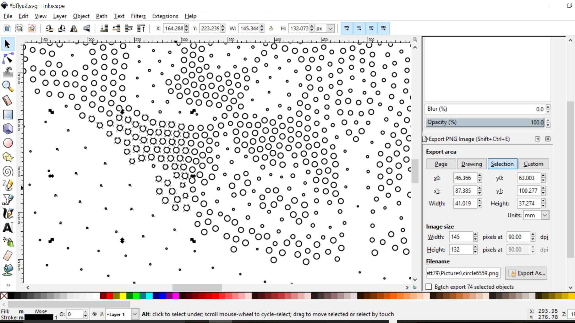

I just want to say thank you to Nick and the others for a wonderful tool set. I am very interested in the engrave feature and I'm trying to use it to cut holes of varying diameter to create a stipple effect art work. I have been able to produce gcode using the engrave tutorial but it doesn't use the varying width of the V cutter to make the different hole sizes by plunging to different Z heights. Instead, it plunges and then moves in a start pattern to expand the diameter.
I've attached a picture of the svg holes I'm trying to cut (only need to remove the surface and not go all the way through)
holes svg (28393 просмотра) <a class='original' href='./download/file.php?id=110499&mode=view' target=_blank>Загрузить оригинал (636.18 КБ)</a>
holes svg
and a close up of the gcode path in my gcode simulator (green line)
hole gcode (28393 просмотра) <a class='original' href='./download/file.php?id=110498&mode=view' target=_blank>Загрузить оригинал (535.25 КБ)</a>
hole gcode
Please could the developers or anyone else help / explain how I can ensure the hole width is controlled with different Z depths for a V bit, rather than the radial XY moves? This is making the file take much longer to execute than is necessary.
Thank you!

Michal_K писал(а):I'm trying to find an option to get max 3 decimal places instead of 6 - I'm working in wood with a CNC milling machine and I don't need such a accuracy, second thing: it's a good and simple way to reduce the end file size which can be critical if you have "limited" memory volume in your machine.
Can you please give me a tip..
Yes, use a text editor like notepad++ (Windows) to open (in administrator mode so you can later save changes) the [highlight=]gcodetools.py[/highlight] file in your Inkscape extensions folder (e.g. C:\Program Files\Inkscape\share\extensions) and look for this section of code (use a Ctrl+f in notepad++ to search down the list for instances of "round" and you'll find it):
Screenshot (74).png (28320 просмотров) <a class='original' href='./download/file.php?id=110755&mode=view' target=_blank>Загрузить оригинал (208.72 КБ)</a>
Now, change
x=round(x,4) #round to 4 decimals
to
x=round(x,3) #round to 3 decimals
I actually use 2 decimals here as I don't believe my machine has 0.01mm precision.
Repeat this for the following lines too:
y=round(y,4) #round to 4 decimals
w=round(w,4) #round to 4 decimals
Now save (this is why you needed to open the text editor in administrator mode).
If you want to edit the GUI pop-up, you can do this by changing "4" to "3" in the relevant parts of the file [highlight=]gcodetools_path_to_gcode.inx[/highlight] in the same Inkscape extension folder. Now, if Inkscape is already open, save your work and restart it. If not, just open your file in Inkscape.
