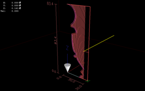

Добавлено: 22 июл 2015, 17:20
sanoka
I've been playing with it for hrs and can't make it work right.
The Openscam simulation shows opposite of what it should be. When tool position shows 10.0000, the tool is inside the material and cuts its own path instead of objects.
When tool position shows -1.00000 then it is above material and just follows the object path in the air.
See attached pictures.
Can you convert my svg file to gcode and run openscam simulation to see whats happening please.
I have used the following settings:
orientation points: 2 point mode, Z surface 0.00000, Z depth -1.00000
gcode tools->path to gcode: options: scale along Z 1.00000, offset along Z 0.00000, minimum arc radius 1.00000
preferences: Z safe height 10.00000 ( all in mm)
Many thanks
Re: Inkscape Gcodetools plug-in English support forum
Добавлено: 23 июл 2015, 10:17
It's caused by openscam configuration.
By default Z axis points to the top. So Z blow 0 should be material, Z above 0 is air. Check your configuration.
