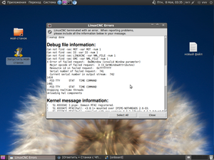

ЕМС загрузил, создал конфигурацию по умолчанию, запускаю - пишет это :( :
Снимок.png (3068 просмотров) <a class='original' href='./download/file.php?id=20671&mode=view' target=_blank>Загрузить оригинал (534.94 КБ)</a>
Print file information:
RUN_IN_PLACE=no
LINUXCNC_DIR=
LINUXCNC_BIN_DIR=/usr/bin
LINUXCNC_TCL_DIR=/usr/lib/tcltk/linuxcnc
LINUXCNC_SCRIPT_DIR=
LINUXCNC_RTLIB_DIR=/usr/realtime-2.6.32-122-rtai/modules/linuxcnc
LINUXCNC_CONFIG_DIR=
LINUXCNC_LANG_DIR=/usr/share/linuxcnc/tcl/msgs
INIVAR=inivar
HALCMD=halcmd
LINUXCNC_EMCSH=/usr/bin/wish8.5
LINUXCNC - 2.5.3-59-gb5c9d06
Machine configuration directory is '/home/vvv/linuxcnc/configs/мой-станок'
Machine configuration file is 'мой-станок.ini'
INIFILE=/home/vvv/linuxcnc/configs/мой-станок/мой-станок.ini
PARAMETER_FILE=linuxcnc.var
TASK=milltask
HALUI=
DISPLAY=axis
Starting LinuxCNC...
Starting LinuxCNC server program: linuxcncsvr
Loading Real Time OS, RTAPI, and HAL_LIB modules
Starting LinuxCNC IO program: io
Starting TASK program: milltask
Starting DISPLAY program: axis
Shutting down and cleaning up LinuxCNC...
Killing task linuxcncsvr, PID=2366
Killing task milltask, PID=2419
Removing HAL_LIB, RTAPI, and Real Time OS modules
Removing NML shared memory segments
Cleanup done
Debug file information:
Can not find -sec MOT -var MOT -num 1
Can not find -sec IO -var IO -num 1
Can not find -sec LINUXCNC -var NML_FILE -num 1
Can not find -sec EMC -var NML_FILE -num 1
  File "/usr/bin/axis", line 2985, in <module>
    o = MyOpengl(widgets.preview_frame, width=400, height=300, double=1, depth=1)
  File "/usr/bin/axis", line 351, in __init__
    Opengl.__init__(self, *args, **kw)
  File "/usr/lib/pymodules/python2.6/rs274/OpenGLTk.py", line 164, in __init__
    apply(RawOpengl.__init__, (self, master, cnf), kw)
  File "/usr/lib/pymodules/python2.6/rs274/OpenGLTk.py", line 112, in __init__
    Togl.__init__(self, master, cnf, **kw)
  File "/usr/lib/pymodules/python2.6/rs274/OpenGLTk.py", line 38, in __init__
    Widget.__init__(self, master, 'togl', cnf, kw)
  File "/usr/lib/python2.6/lib-tk/Tkinter.py", line 1935, in __init__
    (widgetName, self._w) + extra + self._options(cnf))
_tkinter.TclError: Togl: X server has no OpenGL GLX extension

как с этим бороться?

Тима писал(а):Вот только не помню, как я его заставил работать... :pssdoff:
Поставил пакет libgl1-mesa-glx и/или драйвер для своей видеокарты.

После обновления системы и перезагрузки он выкинул сообщение, что там что-то не то с дровами видеокарты и список чего сделать. Я сейчас не помню, что выбрал, но операционка загрузилась.
UAVpilot писал(а):пакет libgl1-mesa-glx
А как его установить?
Re: Установка LinuxCNC EMC2
Добавлено: 10 ноя 2013, 00:18
Тима писал(а):А как его установить?
sudo apt-get install libgl1-mesa-glx
но скорее всего надо просто установить драйвер видеокарты.
