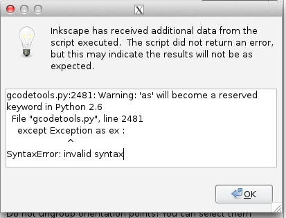

I've been using Gcodetools with Inkscape on a Ububtu virtual machine on my Mac, with no problems othere than the inconvenience of having to work with the VM.
I tried installing on the Mac, and Inkscape works fine, so I put the Gcodetools files in what seems to be the correct folder, /Applications/Inkscape.app/Contents/Resources/extensions. The Gcodetools menu comes up OK, but the first thing I tried was to set orientation points, and I got this message:
The fantastic lxml wrapper for libxml2 is required by inkex.py and therefore this extension. Please download and install the latest version from http://cheeseshop.python.org/pypi/lxml/, or install it through your package manager by a command like: sudo apt-get install python-lxml
I followed the instructions from cheeseshop for the Mac, and installed lxml using pip, with no errors reported, but the error from Gcodetools still appears. I've tried a reboot of teh Mac, but still the error persists. I'm thinking there may be an environment variable ors symlink that I need to install, but I'm stumped at this point.
Can anyone help here? Thanks.
Walt
Re: Inkscape Gcodetools plug-in English support forum
You need to make python-lxml available from python try to open console
start python and try to import the library.
python
import lxml
PS do other extension work or not?

i am having trouble with gcodetools extensions... I am getting this back when i try to add orientation points, tools, or path to gcode-
  File "gcodetools.py", line 6749, in <module>
    gcodetools.affect()
  File "C:\Program Files\Inkscape-0.48\share\extensions\inkex.py", line 215, in affect
    self.effect()
  File "gcodetools.py", line 6661, in effect
    self.get_info()
  File "gcodetools.py", line 4283, in get_info
    recursive_search(self.document.getroot(),self.document.getroot())
  File "gcodetools.py", line 4238, in recursive_search
    recursive_search(i,i)
  File "gcodetools.py", line 4241, in recursive_search
    points = self.get_orientation_points(i)

Screen Shot 2014-05-31 at 4.36.39 PM.png (10397 просмотров) <a class='original' href='./download/file.php?id=28888&mode=view' target=_blank>Загрузить оригинал (31.59 КБ)</a>
I am using Gcodetool 1.7 on a Mac (10.7.5) with Inkscape 0.48.2. I was able to use the extension but now I get the following error when I attempt to Apply the Orientation Points:
gcodetools.py:2481: Warning: 'as' will become a reserved keyword in Python 2.6
  File "gcodetools.py", line 2481
    except Exception as ex :
SyntaxError: invalid syntax
What python version is installed in your MacOS?
That strange because there seems no error in this line...

When I type in python in the console: Python 2.7.1 is returned. It all worked a couple of weeks ago and nothing in the code has been changed. Probably when I installed some other apps something in the paths has been changed. If there is nothing obvious I'll focus on the python installation.

Fixed! The Eggbot plug-in modifies the Inkscape script and forces python 2.5. I commented out the line and it all works fine.
