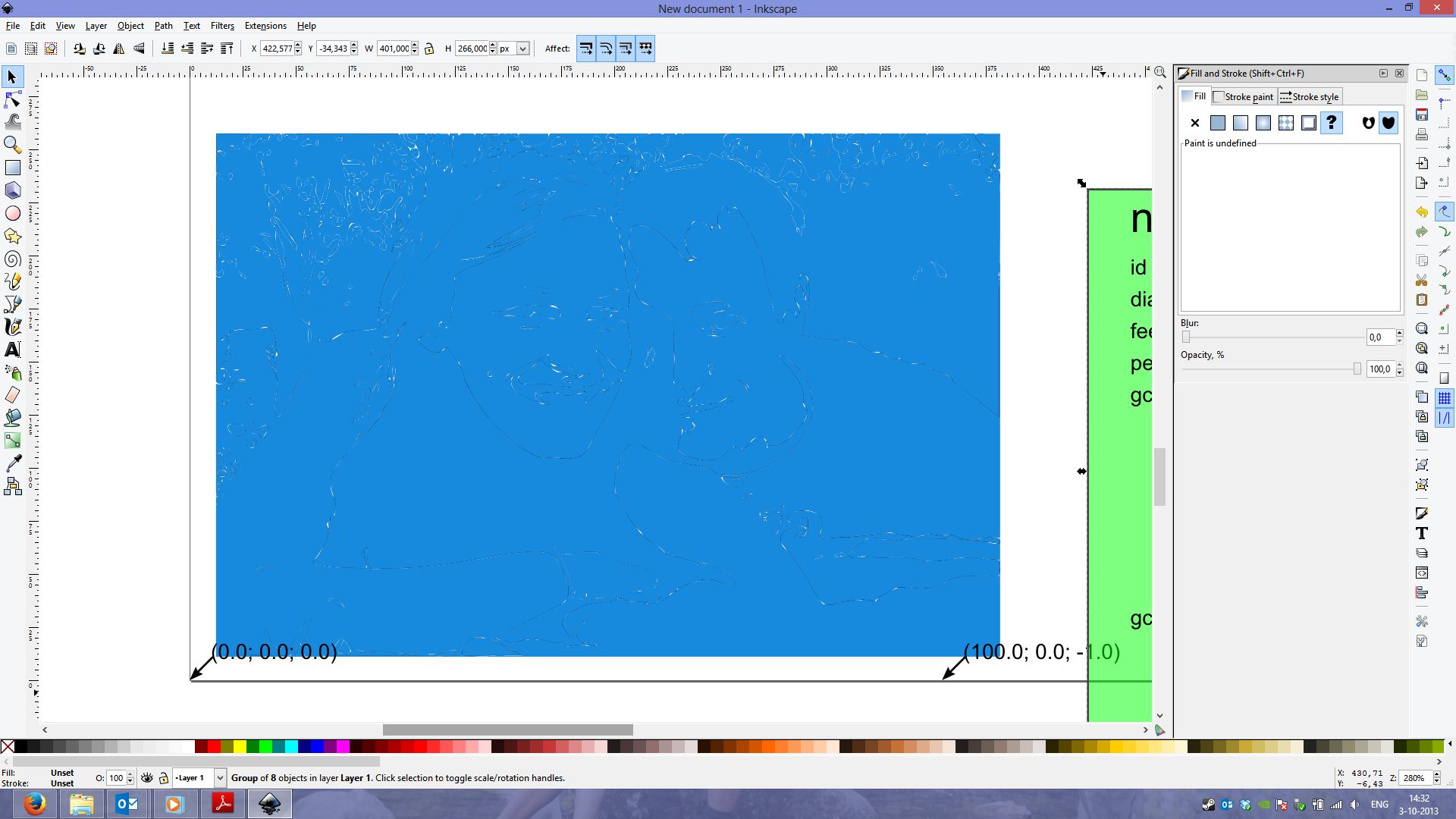

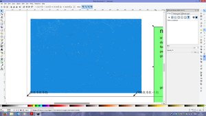

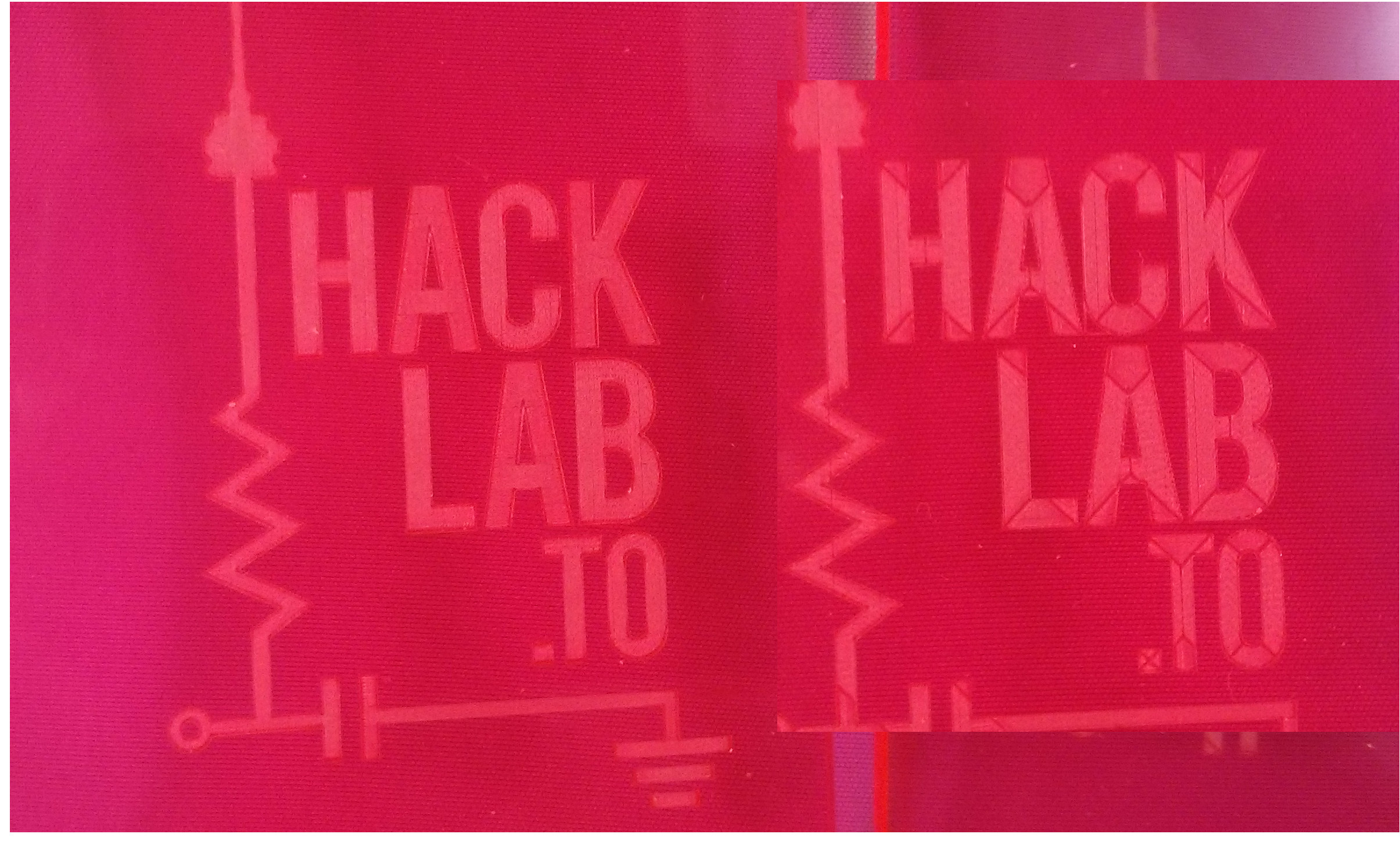

Hi all,
I'm using gcodetools for a laser engraver. Currently it works nice, but it takes ages to complete a big image (using a low power DVD writer diode). At the moment it cuts different paths, goes back and forth in not always the most efficient way. I tried to use the option to reduce the fast movements but that did not help too much.
I was wondering if it is possible to have the laser 'scan' the page from top to bottom, so it starts from the top, goes from left to right cutting where needed in one go, then goes down one line, repeating this until finished.
The way I currently use the plasma cutter tool, using the area plugin, first filling it zig zag at 0 degree, 0,5 shift and generating the g code with the reduced fast movement option. I manually remove all the Z-axis by means of notepad search and replace :)
Does anyone have an idea if this is possible?
Thanks!
Erik
Re: Inkscape Gcodetools plug-in English support forum
Hi!
Can you attach original svg, and a photo of the finished work?
fritzerik писал(а):I manually remove all the Z-axis by means of notepad search and replace
To remove Z moves you can use a "postprocessor". Inside Additional postprocessor field write something like regexp("G0?(0|1)\s*Z\s*[\-0-9\,\.]+.*", "(removed Z)");
( How to use gcodetool extension in inksacpe ? #6 )
fritzerik писал(а):Does anyone have an idea if this is possible?
What OS are you using (win,linux)?
fritzerik
Сообщения: 5
Зарегистрирован: 30 сен 2013, 21:57
Сообщение fritzerik »
Hi Nick,
Thanks for you answer! The link contains the picture and SVG. The SVG is not the original but it reproduces the same issue. Using path by path and reduce fast movements results in the fastest cutting, subpath by subpath and reduce fast movements does not.
But, I can live with it if it is not possible otherwise. An additional problem is the following (as you can see in the picture). It also cuts the outline of the 'black parts' that are engraved. Is it possible to prevent this?
The OS is Win8, using Inkscape 0.48 and gcodetools v1.7.
Using your postprocessor code (regexp...) results in an error, I think I need the dev version for this (dev version works the same as 0.48?).
Thanks!
Erik
https://www.dropbox.com/s/52ykhzc58j05ywh/drawing.rar
PS additional options I selected in gcodetools are:
angle: 0,0 deg
area fill shift: 1,0
biarc: 0,01 (thought this would reduce the outline problem)
fritzerik писал(а):Using your postprocessor code (regexp...) results in an error, I think I need the dev version for this (dev version works the same as 0.48?).
try "regex" instead "regexp", I always forget it...
To remove outline just delete it in inkscape, or do not select when making Path to Gcode.
PS in LinuxCNC there's a image-to-gcode which can easily make Gcode from greyscale image... I think it can be useful for you...
fritzerik
Сообщения: 5
Hi Nick,
Thanks for the tip, but I've never used Linux so that will be an experience :) but I'd rather get it to work on this platform.
I've tried to remove the outline by removing the stroke, but this results in the same (outlines are still used as a path). Since I'm not very used to Inkscape yet, do you have a hint on how to do this (removing the outline in steps)?
The way I do it now is as following:
1. Import .AI file that I generated using adobe illustrator, resize, remove stroke (set to none)
2. object to path
3. do all the settings (orientation points, slect plasma tool, diameter, M03/M05 before/after path)
4. area fill 0 degrees, fill shift both 1.0, zig zag
5. apply (look at image what I get, I expected blue lines only in the black areas... is this normal?)
6. select entire image again
7. path to g code (without regex as of yet)
8. wait, get coffee
9. remove Z manually
Thanks,
Erik

Hey Nick,
Thanks for the link. I'll give it a try soon. As of now, I've tried to remove the outline and that took some work, but that seemed to have solved it. What I did is select all the black parts and copied them to another place and used that to generate the area and path. Now no discrepancies occur. The laser is currently cutting and it will take another 7 to 8 hours before it's done. When it's done I'll upload a photo.
Thanks for everything!
Cheers,
Erik

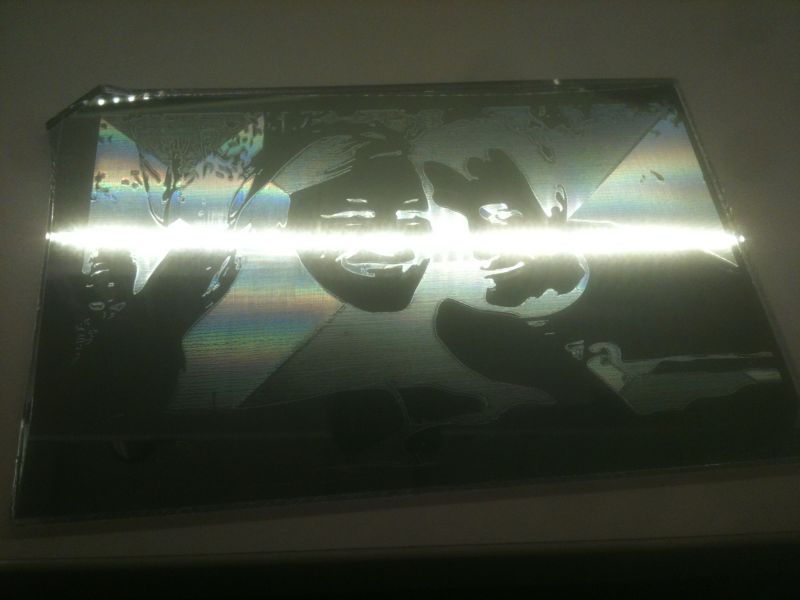

IMG_1322.JPG (16152 просмотра) <a class='original' href='./download/file.php?id=19320&mode=view' target=_blank>Загрузить оригинал (110.09 КБ)</a>
fritzerik
Сообщения: 5
Hi Nick,
So this is the result of 9 hours of cutting :) Well at least it looks okay so no problem there. Now I just need to fix the outline of the whole thing and glue a peg to the rear so it stands on its owm.
Thanks so much for all your help!
Cheers,
Erik

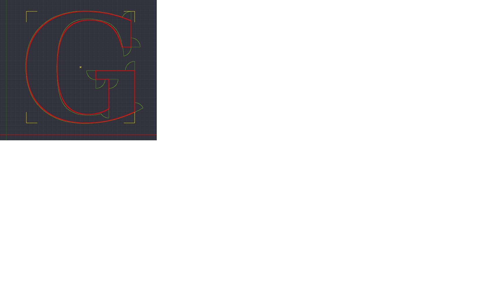

Regarding Drag-Knife, it should be really easy to implement, considering the similar tools you have already implemented.
See the attached picture for an example of "G" cut out using a drag-knife path.
I used a large knife offset value to show the corner features.
You can see that the cut direction is CCW, and at the end of each segment the path is extended and then swivels to the tangent of the next segment.
On curved paths the tool path lags the cut line, as the rear wheel of a bicycle lags the front wheel on a curve.
In a following post I can list a pseudo-code for this and some additional features of the path.
Cheers - BillT

We use gcodetools at our hackerspace (Hacklab.to) to generate gcode for our laser cutter. I've created a new mode for the area tool to allow for a simpler path (scans back and forth across in one direction) as this makes a huge quality difference when rastering images. The patch is attached, would be hugely appreciated if you considered adding this to the next version!
Compare the artifacts created with the "zig-zag" method (right) vs scan (left)
Wow awesome!
Will include that for sure!
