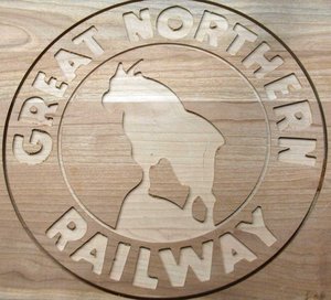

More pictures of things I've made using gcodetools.
