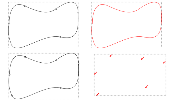

I worked a little bit more on DXF points and made the creation of them easier.
With this new patch, it is now possible to create a group of multiple dxf points out of a path.
If the path is not closed, all the nodes, except the ending one, will be converted to dxf points ( this allows creation of a single dxf point ).
If the path is closed, all the nodes will be converted to dxf points.
enhanced-dxfpoints.png (10922 просмотра) <a class='original' href='./download/file.php?id=7914&mode=view' target=_blank>Загрузить оригинал (42.13 КБ)</a>
Top view : "save shape" option
Bottom view : "draw arrow" option
Below is the patch.
Good holidays.
Tomate

Re: Inkscape Gcodetools plug-in English support forum
Thanks a lot :good:. I've patched dev version, so this enhance is available since rev. 241.
