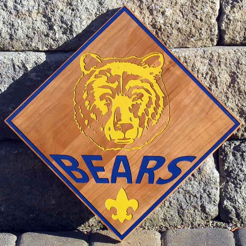

Bears by Durachko (1402594 просмотра) <a class='original' href='./download/file.php?id=5429&mode=view' target=_blank>Загрузить оригинал (89.93 КБ)</a>
Bears by Durachko

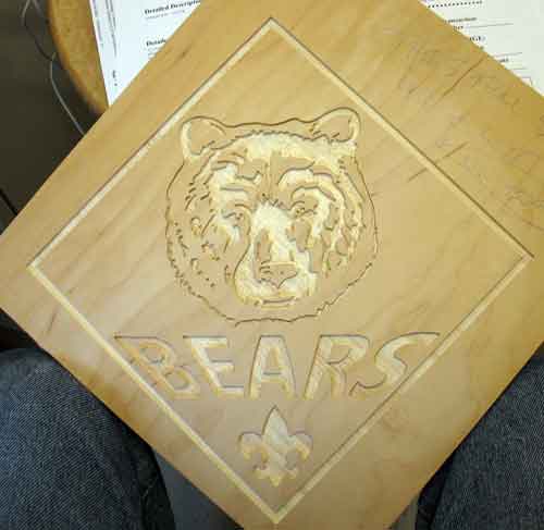

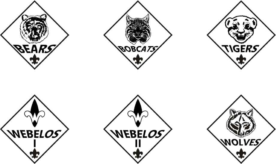

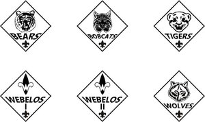

Durachko
Сообщения: 13
Зарегистрирован: 30 авг 2010, 17:52
Re: Gcodetools - plug-in Inkscape для экспорта в Gcode
Сообщение Durachko »
Here are the jpegs of all six images I intend to make signs from along with an image of an actual test I did in scrap plywood just to ensure the result would be what I want.
All-Six.JPG (6649 просмотров) <a class='original' href='./download/file.php?id=5360&mode=view' target=_blank>Загрузить оригинал (33.9 КБ)</a>
Bear-Test.jpg (6649 просмотров) <a class='original' href='./download/file.php?id=5361&mode=view' target=_blank>Загрузить оригинал (15.01 КБ)</a>
Re: Inkscape Gcodetools plug-in English support forum
Nice job!

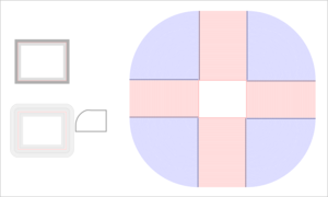

Dan13
Сообщения: 12
Зарегистрирован: 16 май 2012, 22:09
Сообщение Dan13 »
Here, attached is a simple SVG that I just made. It's a plain rectangle. When I try to use the Ctrl+( the rectangle gets distorted. The Inset/Outset in preferences is set to 2.000px.
This is not what I was talking about in the first post, where I said that Ctrl+J caused this, but the result is the same.
Thanks,
Dan
RectangleOffset.svg
(1.95 КБ) 881 скачивание
When you suggest breaking the path and sorting manually, do you mean producing two Gcode files? One for each group?
No, just break path appart, sort them along virtual axis Z, using PageUp/PageDown and export all of them at once with Path to Gcode. And make sure to uncheck Sort paths to reduce rapid distance.
Here are my trials with your rectangle:
Top left - offset using Alt+() - pretty nice, and notice that it remains sharp angles.
Bottom left - Dynamic offset - nice to, round angles but some distortion at the arc-line connection (see enlarged piece).
Right - using Test function of current dev-version. Exact offset, but the path is too simple, this offset could be buggish on complex paths. Can you attach the paths you are working with and needed offset distance, it will be useful for me to test offset on the real paths.
gcodetools offset.png (6610 просмотров) <a class='original' href='./download/file.php?id=5376&mode=view' target=_blank>Загрузить оригинал (599.33 КБ)</a>

Here's a finished product from my most recent project. Thanks again for the excellent tool!
bears.jpg (6526 просмотров) <a class='original' href='./download/file.php?id=5425&mode=view' target=_blank>Загрузить оригинал (89.93 КБ)</a>
Cool! I'll add this to the header of thread, if you do not mind :)!
