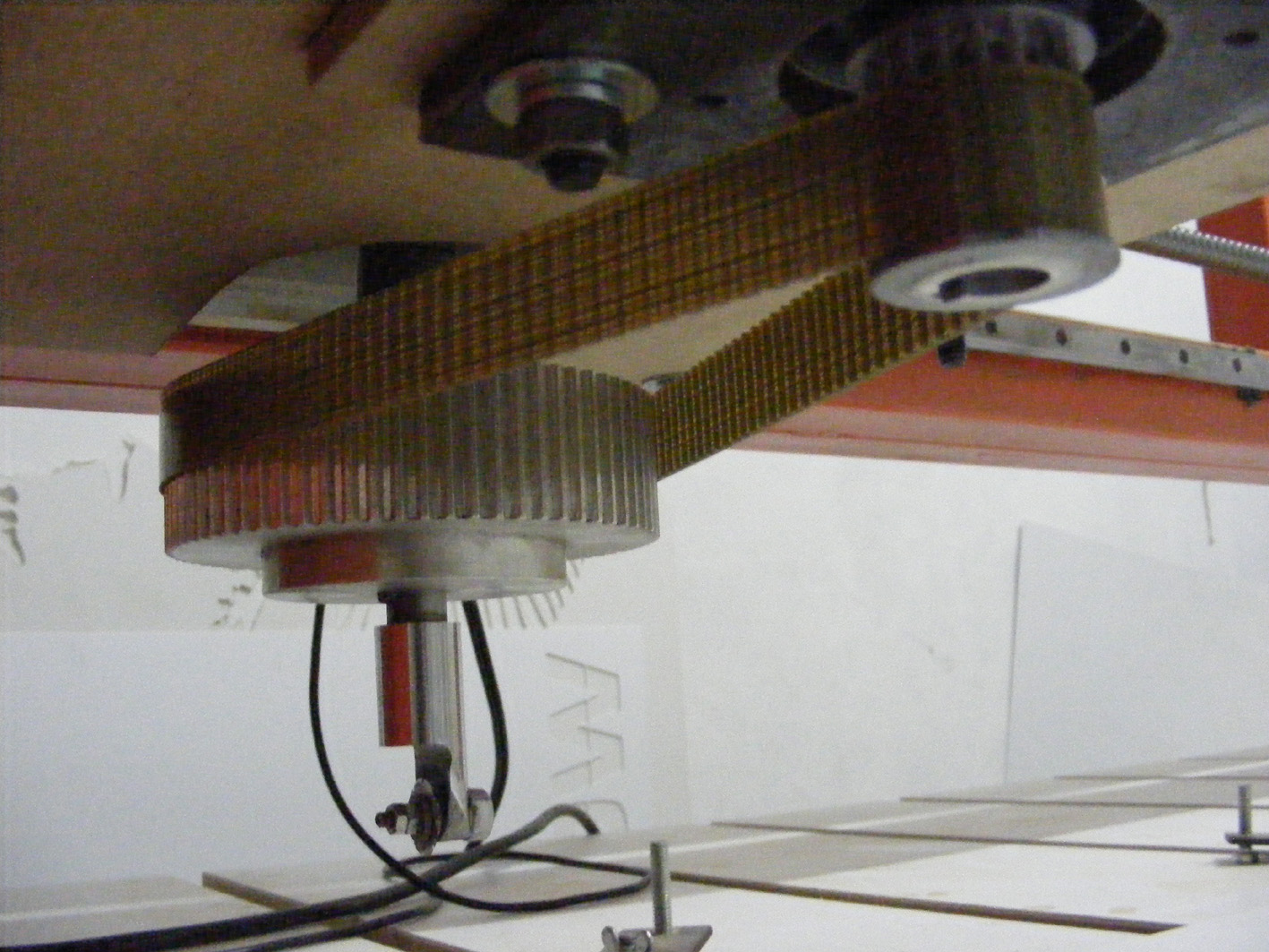

With a friend, last year we built a big gantry machine for signage and decoration cutting. I have a eletric engineer friend, who represents Yaskawa in my state, he sold me some equipment. in very good terms and we built a servo system in our machine. The 4th axis is made with a 400 W servodrive and servomotor, overkill, I know, but that is what we had laying around here.
My dream is using Linux for all our tasks, in business and home. I discarded all comercial solutions to CNC controlling in favor of LinuxCNC, it is a awesome project.The quality of software is extraordinary, and the support is friendly and excellent.
My friend has a licence of ArtCAM, which is expensive, and only with the basic 3 axis cutting. We learned fast that soft materials are not well cut with rotating tools, and recently, we got some clients asking to cut textiles and leather. Soon I was trying to figure how to make the tool follow the cutting direction, there are some topics on the LinuxCNC developer talk (I follow with some difficulty) and a post of Andy Pugh on the LinuxCNC forum that makes a modification on the source code, which still is beyond my comprehension of programming. I tryed Gcodetools before, and when it showed supporting tangential knife I jumped in.
Commercial solutions are very expensive and Gcodetools, after you explainig some of it to me, is working very well.

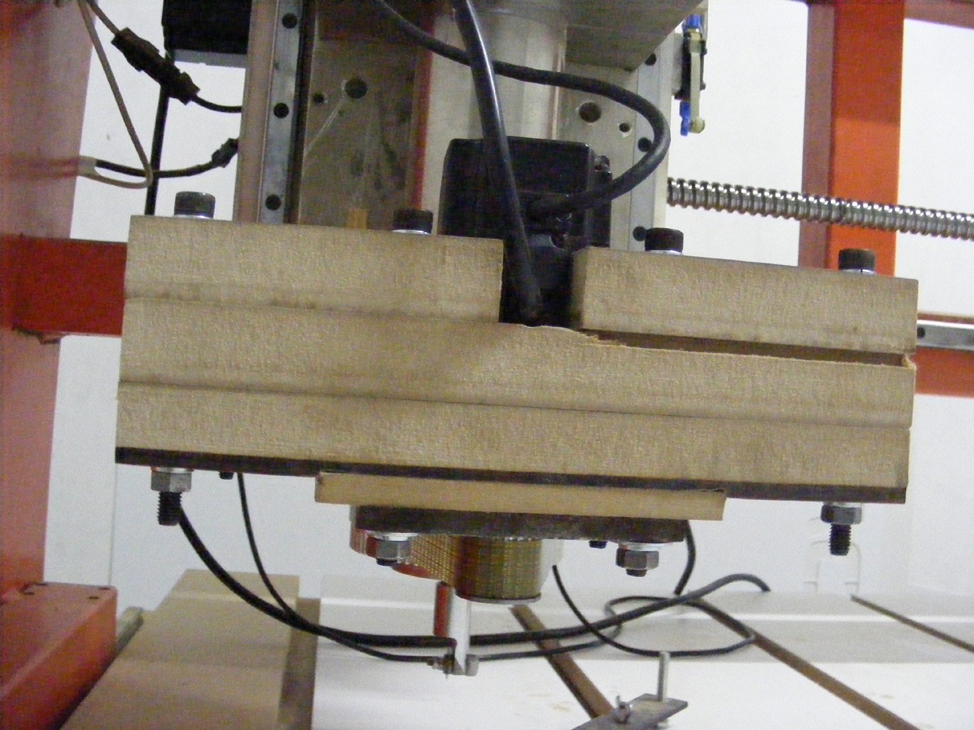

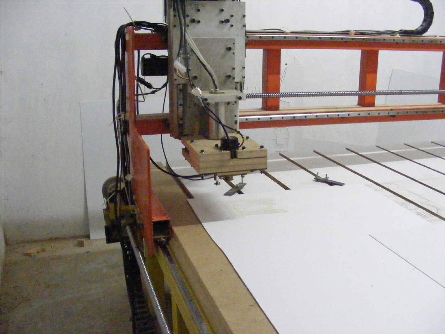

4th axis support is a hack! :-) (8240 просмотров) <a class='original' href='./download/file.php?id=5128&mode=view' target=_blank>Загрузить оригинал (452.63 КБ)</a>
Machine partial view (8240 просмотров) <a class='original' href='./download/file.php?id=5127&mode=view' target=_blank>Загрузить оригинал (421.92 КБ)</a>

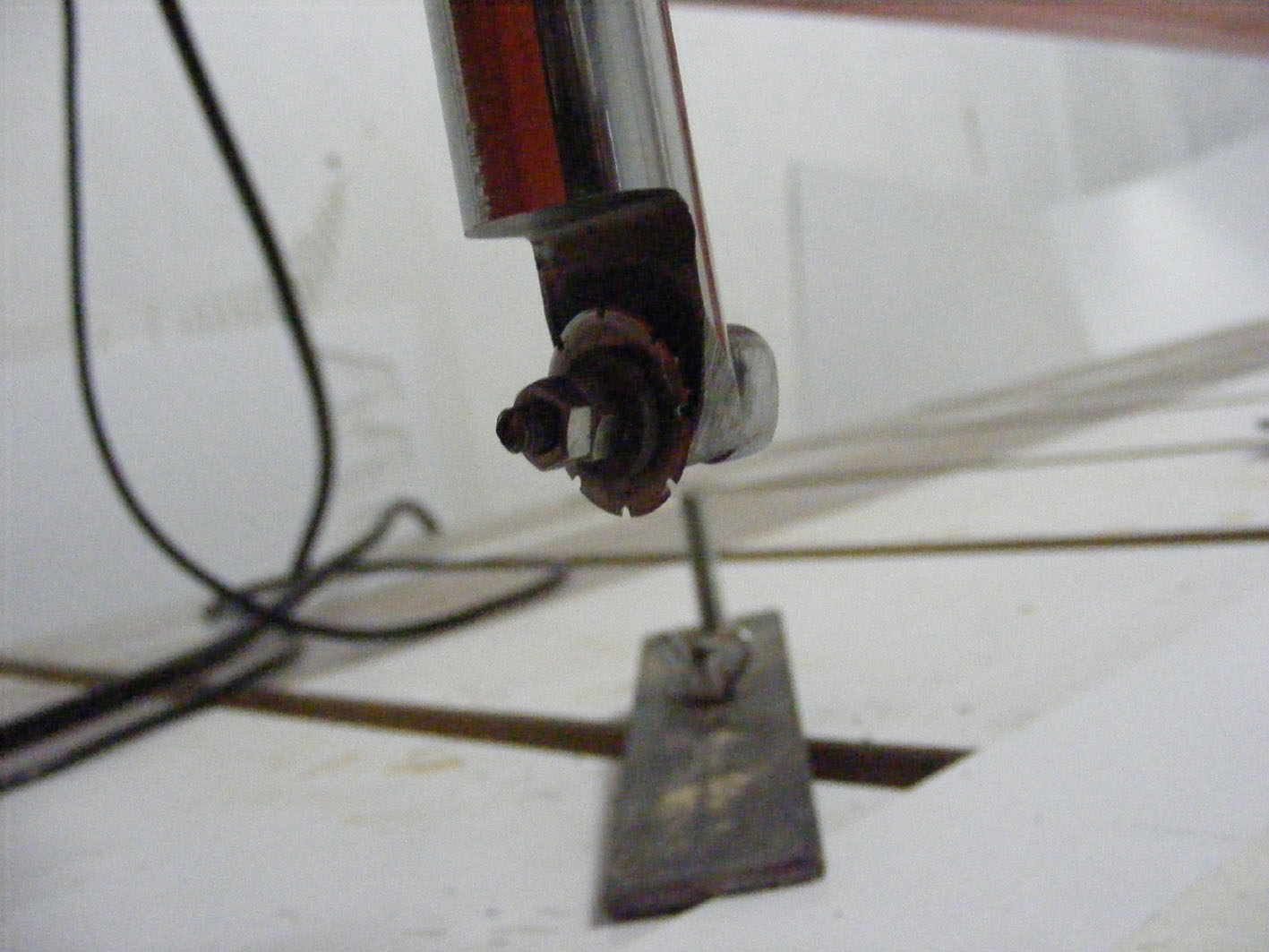

alignment not done yet, but already works. (8240 просмотров) <a class='original' href='./download/file.php?id=5129&mode=view' target=_blank>Загрузить оригинал (413.13 КБ)</a>
Knife and Knife support detail. (8240 просмотров) <a class='original' href='./download/file.php?id=5130&mode=view' target=_blank>Загрузить оригинал (181.25 КБ)</a>

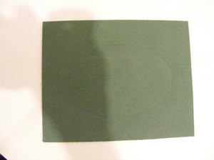

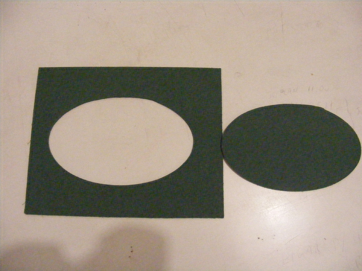

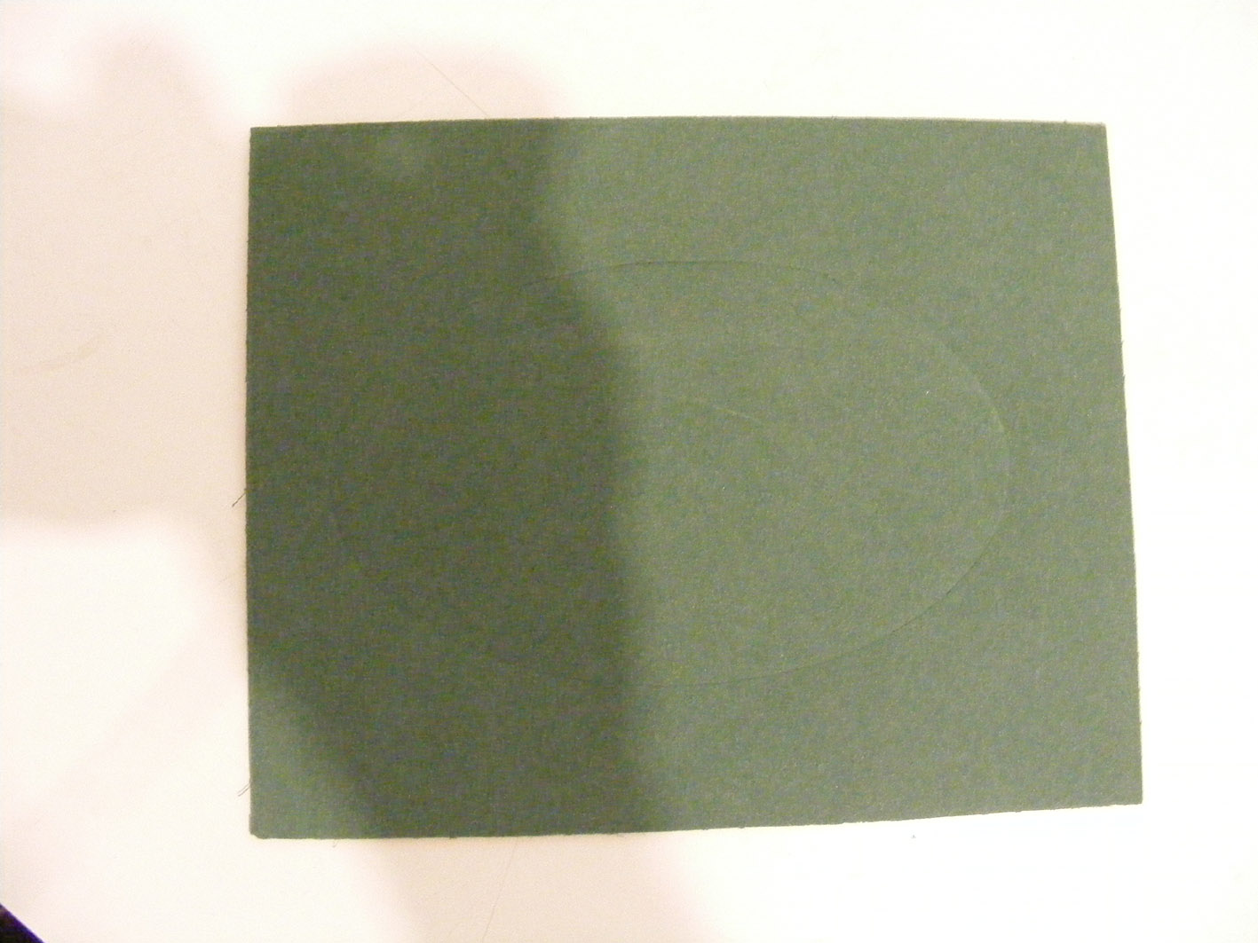

Test cut on EVA (8240 просмотров) <a class='original' href='./download/file.php?id=5131&mode=view' target=_blank>Загрузить оригинал (215.36 КБ)</a>
Test cut on EVA
Same cut, disassembled. (8240 просмотров) <a class='original' href='./download/file.php?id=5132&mode=view' target=_blank>Загрузить оригинал (399.77 КБ)</a>
Re: Inkscape Gcodetools plug-in English support forum
Dimitrios писал(а):4th axis support is a hack! :-)
Yeah, you just fixed knife in the spindle, don't you? :)

Сообщение Dimitrios »
Yes! We had several pieces of equipment laying around, so we recycled them. :hehehe:
