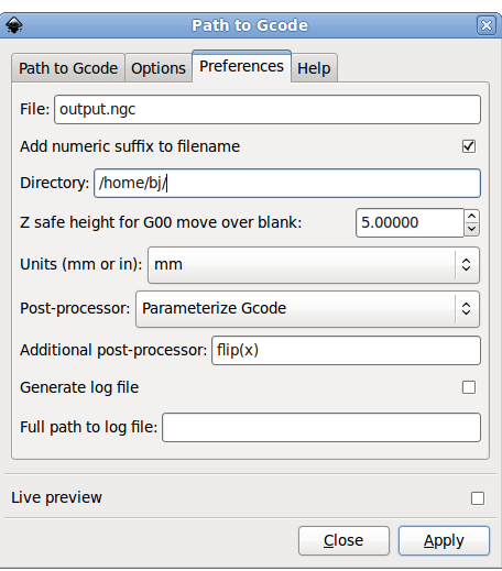

Hi,
I think I found something not correctly working:
When "Parametrize Gcode" is selected as post-processor AND flip(x) as additional post-processor, then the produced Gcode is not correct.
You can test: draw few circles, make Gcode with no post-processor but use flip(x), and the very same but select "Parametrize Gcode" for postproc.
Take a look at the procduced Gcode: in parametrized flipped code, the G02/G03 and their I/J parameters are not set correctly to minus value.
I did not tried with other transformation or other axes, but the same issue is in stable and dev version.
Regards:
James
Re: Mirroring to engrave both side of material
Parameterize is a quite specific funtion... In what order do you apply postprocessors? flip first, and parameterize after?
James628
Сообщения: 28
Зарегистрирован: 19 июн 2012, 19:55
Сообщение James628 »
Nick писал(а):Parameterize is a quite specific funtion... In what order do you apply postprocessors? flip first, and parameterize after?
I do it this way:
gc3.png (22190 просмотров) <a class='original' href='./download/file.php?id=11428&mode=view' target=_blank>Загрузить оригинал (38.38 КБ)</a>
Hmmm... I do not remember how are they applied...
try using them both as additional post-processor:
flip(x); parameterize();

Hi Nick,
When I use both of them as additional post-proc then it works. Thanks.
