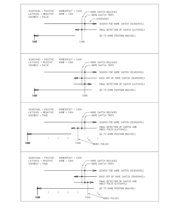

The default value is zero. A value of zero causes EMC to assume that there is no home switch; the search stage of homing is skipped.
If HOME_SEARCH_VEL is non-zero, then EMC assumes that there is a home switch. It begins by checking whether the home switch is already tripped. If tripped it backs off the switch at HOME_SEARCH_VEL. The direction of the back-off is opposite the sign of HOME_SEARCH_VEL. Then it searches for the home switch by moving in the direction specified by the sign of HOME_SEARCH_VEL, at a speed determined by its absolute value. When the home switch is detected, the joint will stop as fast as possible, but there will always be some overshoot. The amount of overshoot depends on the speed. If it is too high, the joint might overshoot enough to hit a limit switch or crash into the end of travel. On the other hand, if HOME_SEARCH_VEL is too low, homing can take a long time

0.1.3.5 HOME_USE_INDEX
Specifies whether or not there is an index pulse. If the flag is true (HOME_USE_INDEX = YES), EMC will latch on the rising edge of the index pulse. If false, EMC will latch on either the rising or falling edge of the home switch (depending on the signs of HOME_SEARCH_VEL and HOME_LATCH_VEL). The default value is NO.

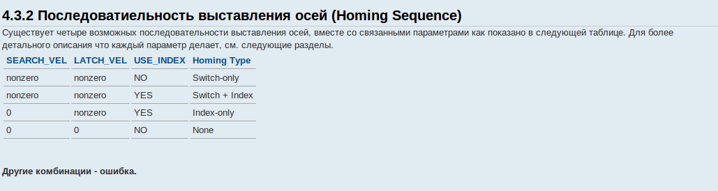

все ответы в доках))
прям сюда выложу:
Выделение_037.png (2445 просмотров) <a class='original' href='./download/file.php?id=22490&mode=view' target=_blank>Загрузить оригинал (29.69 КБ)</a>
Выделение_038.png (2445 просмотров) <a class='original' href='./download/file.php?id=22491&mode=view' target=_blank>Загрузить оригинал (81.64 КБ)</a>
вот и все варианты из возможных
