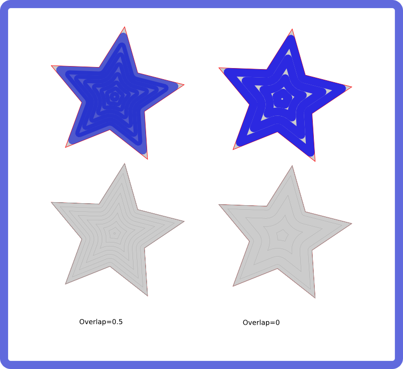

I've been working with the area function, and one thing that would be helpful is a setting for tool overlap (perhaps set in the tool). I've implemented the code in gcodetools.py:
for i in range(self.options.max_area_curves):
# The amount of tool overlap when generating areas
tool_overlap = 0.5
if (i == 0):
radius = - tool_d * (i + 0.5) * sign
else:
radius = - tool_d * ( (i * (1 - tool_overlap)) + 0.5) * sign
if abs(radius)>abs(r):
radius = -r
do you accept patches? I could send you a diff.

Re: Inkscape Gcodetools plug-in English support forum
Добавлено: 12 ноя 2010, 10:09
Yes that's will be cool! Thank you!
But I think that we should add tool_overlap as a parameter into Area form.
Добавлено: 13 ноя 2010, 10:37
I've made changes to source code. Now there's additional parameter at area pocketing tab - tool overlap. Which works exactly as you have written.
Tool overlap can be assigned from 0 to 0.9. Top border was changed from 1 to 0.9 to avoid infinite loops.
In fact those "if" that you've wrote is not needed. If i==0 then (i * (1 - tool_overlap)) == 0.
So (- tool_d * (i + 0.5) * sign) == (- tool_d * ( (i * (1 - tool_overlap)) + 0.5) * sign).
So I've added only (1 - tool_overlap). And some definitions of the tool's overlapping parameter.
Thanks for the code! :)

Here are some screens:
gcode tools area pocketing tool overlap.png (11705 просмотров) <a class='original' href='./download/file.php?id=836&mode=view' target=_blank>Загрузить оригинал (83.18 КБ)</a>
Gcodetools area overlap added into area pocketing tab.png (11705 просмотров) <a class='original' href='./download/file.php?id=837&mode=view' target=_blank>Загрузить оригинал (49.36 КБ)</a>
