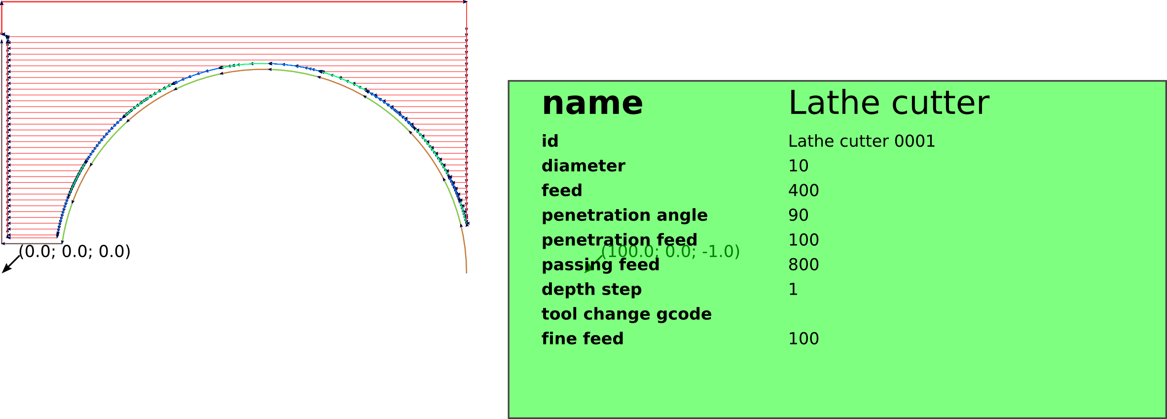

  1. Remove that vertical line from the left. Material width should be defined in the lathe window.
  2. Add horizontal line at level 0 from the right. Doing this you avoid high depth step during the fine cut at the right.
    0068 gcode tools lathe.png (14253 просмотра) <a class='original' href='./download/file.php?id=589&sid=c41947af7efdc4f59ce06c73c74341fa&mode=view' target=_blank>Загрузить оригинал (41.88 КБ)</a>
  3. Define depth step at the tools parameters.
  4. Define material width at lathe's window.
    0066 gcode tools lathe.png (14253 просмотра) <a class='original' href='./download/file.php?id=591&sid=c41947af7efdc4f59ce06c73c74341fa&mode=view' target=_blank>Загрузить оригинал (119.29 КБ)</a>

It have some little bug for finishing pass that doesn't subdivise the finishing width by the number of subdivision set...
It's not a bug it's a feature :D! The subdivision is not needed there. If you are cutting a ball you can cut it using only one gcode command G02 because ball' projection is a circle ;). "
Hum I think you have don't understand me for this feature....
The feature i was thinking for this is that for have a good finishing surface at the end of cut require to cut very thin depht of material...
So when the tool arrive to finishing depth for example 1 mm and if have set 10 step the tool must cut all the shape Ten time with widht of 0,1mm
depht minus each pass... until arrive to the end of the last shape cuting.
Because if i cut in one time G02 the depht is too big and for example soft wood is tear... and to suppress this tearing effect of fiber
I must cut 3 or 5 pass with very thin depht befor arrive to final pass...
Or actualy if I set 1 mm fine cut width and cut count to 10 the gcode generate do 10 time the end shape.... and doesn't subdivide
the 1 mm depht to 10 depth cutting thin pass...
Excuse me if i have bad explain you this feature on the start of work...
So another solution is to do Twice the gcode generation ... One with roughing and another one just for finish... whith two sheet in inkscapte or two gcode file...but less beautifull and practical...

There was a bug... while doing fine cutting penetration g00 was path.y - fine_cutting_width instead of path.y + fine_cutting_width.
I'll correct this in some minutes...
Re: Gcode tools - lathe extension develop
Revision 139
I've add a parameter "Create fine cut using" and two options:
"Move path" just moves original path up. And so creates a number of fine cuts. Gives worse results than offset but there should not be bugs.
"Offsets" offsets original path up. And so creates a number of fine cuts. Gives the best result but could be bugs due to offsets bugs. You can always try it first and in case of bugs try to add some knots to the path near the problem places or just use the first option.
I've changed the inx file so you'll have to run python create_inx.py before using separate lathe window.
Here's an illustration:
0071 gcode tools lathe fine cut.png (14248 просмотров) <a class='original' href='./download/file.php?id=597&sid=c41947af7efdc4f59ce06c73c74341fa&mode=view' target=_blank>Загрузить оригинал (111.9 КБ)</a>

Ok ! process, processing...
The svg file is the same than post just previous this post... Boule1.svg...
were I have just change the direction of cutting path from "right to left" to
" left to right" with revert path... you'll have the bug with about all the value
you can set for fine cut.... very easy to reproduce...
