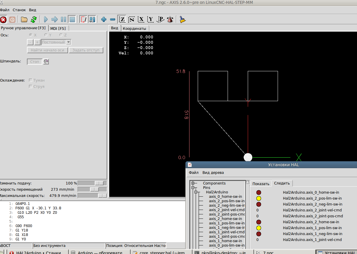

aftaev писал(а):Шо ему нужно
HAL2Arduino.py ложишь в папку конфига (там где ини)
в свой хал файл (внизу) пишешь:
loadusr -Wn Hal2Arduino python HAL2Arduino.py
запускаешь...
смотришь в halshow свои пины...
Выделение_066.png (2376 просмотров) <a class='original' href='./download/file.php?id=23031&mode=view' target=_blank>Загрузить оригинал (105.24 КБ)</a>

custom.hal:53: Pin 'Hal2Arduino.axis_0_joint-vel-cmd' does not exist
2348
  PID TTY      STAT   TIME COMMAND
Stopping realtime threads
Unloading hal components
  File "HAL2Arduino-0.5.py", line 2012, in <module>
    commandHandler(str(listOfCommands), str(listOfAxis))
  File "HAL2Arduino-0.5.py", line 242, in commandHandler
    sleep(0.001)
KeyboardInterrupt
Unhandled exception in thread started by
Error in sys.excepthook:
Original exception was:
Kernel message information:
[  268.511591] I-pipe: Domain RTAI registered.
[  268.511604] RTAI[hal]: <3.8.1> mounted over IPIPE-NOTHREADS 2.6-03.
[  268.511608] RTAI[hal]: compiled with gcc version 4.4.3 (Ubuntu 4.4.3-4ubuntu5) .
[  268.511616] RTAI[hal]: mounted (IPIPE-NOTHREADS, IMMEDIATE (INTERNAL IRQs DISPATCHED), ISOL_CPUS_MASK: 0).
[  268.511619] PIPELINE layers:
[  268.511623] f87c5e20 9ac15d93 RTAI 200
[  268.511627] c085cb20 0 Linux 100
[  268.546286] RTAI[malloc]: global heap size = 2097152 bytes, <BSD>.
[  268.546506] RTAI[sched]: IMMEDIATE, MP, USER/KERNEL SPACE: <with RTAI OWN KTASKs>, kstacks pool size = 524288 bytes.
[  268.546513] RTAI[sched]: hard timer type/freq = APIC/6250189(Hz); default timing: periodic; linear timed lists.
[  268.546518] RTAI[sched]: Linux timer freq = 250 (Hz), TimeBase freq = 1500144000 hz.
[  268.546521] RTAI[sched]: timer setup = 999 ns, resched latency = 2943 ns.
[  268.546676] RTAI[usi]: enabled.
[  268.649533] RTAI[math]: loaded.
[  278.839935] RTAI[math]: unloaded.
[  278.912070] SCHED releases registered named ALIEN RTGLBH
[  278.928375] RTAI[malloc]: unloaded.
[  279.028021] RTAI[sched]: unloaded (forced hard/soft/hard transitions: traps 0, syscalls 0).
[  279.033625] I-pipe: Domain RTAI unregistered.
[  279.033638] RTAI[hal]: unmounted.
У меня Ардуина прошита релизом 0,5 и использую HAL2Arduino-0.5.py
Файл HAL2Arduino-0.5.py переименовал в HAL2Arduino.py и положил там где Хал файл
В Хал файле прописал loadusr -Wn Hal2Arduino python HAL2Arduino.py
