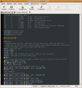

Despite it's simplicity Gedit (it's default "Notepad" for Gnome for Linux) has a lot of useful functions. One of them is syntax highlighting for different programing languages, scripts, htlm, xml, etc. By default Gedit supports about 100 different languages but unfortunately Gcode not in that list. So I've decided to write Gcode syntax highlighting for Gedit.
Here's how it's look like using "Oblivion" color scheme:
0079 gedit gcode hightlight.png (21968 просмотров) <a class='original' href='./download/file.php?id=619&sid=7b6a2f1fa2ce6634fb4e93321bd1a742&mode=view' target=_blank>Загрузить оригинал (161.19 КБ)</a>
How to get your Gedit highlight the Gcode
and make your own Gcode viewer
  1. Download this file:
    gcode.lang
    (7.31 КБ) 2476 скачиваний
  2. Save it into "/usr/share/gtksourceview-2.0/language-specs/". Restart Gedit if it needed.
  3. If you want to st up color scheme same to my do the following Edit->Preferences->Fonts & Colors and select "Oblivion".
PS Just before I've finished my gcdoe.lang I've found almost the same one at wiki.linuxcnc.org. But there some major differences.
My version differentiates different G and M codes for example coolant M codes M7, M8 and M9 are drawn in blue, start / stop M codes are on red background. Also some spindle and feed parameters which can appear inside the line with G code are drawn in green so they become more visible.
Hope there wont be any bugs/mistakes but if you've found one do not hesitate to report it ;) .

I installed the Gedit G-code highlight file, it's much better than I had previously, but still there are some small issues. Especially with the named parameters.
What can be the problem?
Thanks for your support in advance.
James
Сообщения: 22776
Re: Highlight Gcode in Gedit
hmmmm... probably it's because "-" not in the variable pattern
line 68. <match>#([0-9]+|<[a-zA-Z_0-9\-]+>)</match>
Fixed version is in the header.

Now only one item left: comments after semicolon are too colorful yet ;)
As in the screenshot above
James
Сообщения: 22776
Do I get it right - everything after semicolon till the end of line is a comment?
Сообщения: 22776
Fixed. See updated file in the header.
