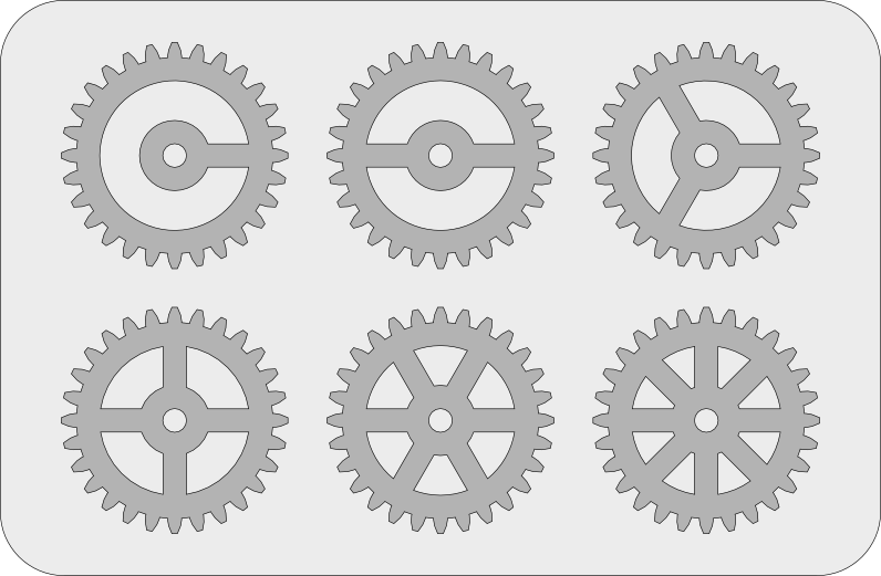

We've made some improvements of Gears extension. It adds holes to the gear.
Here's an example:
gears extension gcode tools.png (21491 просмотр) <a class='original' href='./download/file.php?id=1090&sid=42d731120d54e3bd55db7cf450e92bdf&mode=view' target=_blank>Загрузить оригинал (99.13 КБ)</a>
